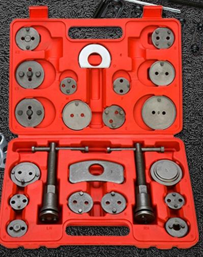

Most tutorials say to use this type of tool to spin them in:

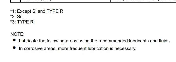

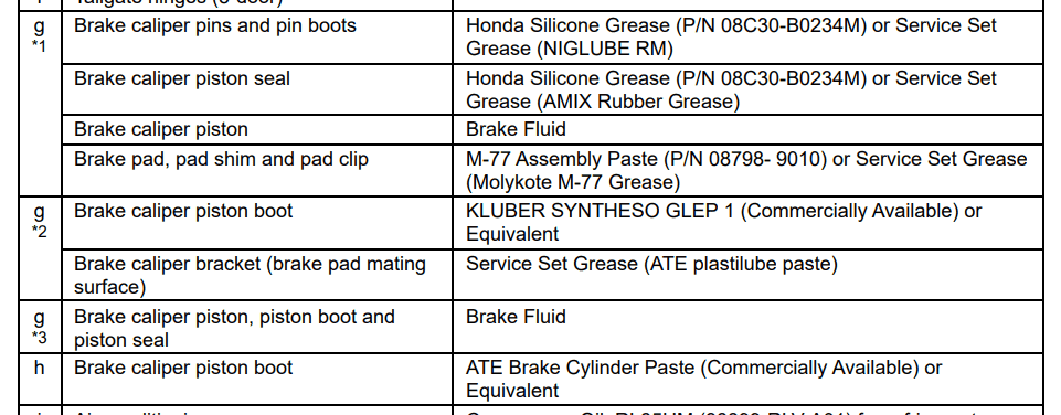

I have one more question where there seems to be some differing info out there. This is related to what, if any, greases or lubricants to apply to the caliper/pads for a Type R. The service manual explicitly goes out of the way to specify NO grease or lubricant on the Type R brakes while the other models do call for it. See below. However, most guides online do say to use grease.
Service manual no grease on Type R - g(*3)
Brembos and a lot of brake brands don't call for grease on pads, also if you track the car its pointless as the brakes will get so hot it will probably just crumble away quick (why I never put it on my cars cuz they all see track).
It is interesting that they say no for the type R because I am pretty sure the rear pads did have some stuff on them, fronts were installed dry (not surprised because brembos). I would just install dry specially if the manual says so

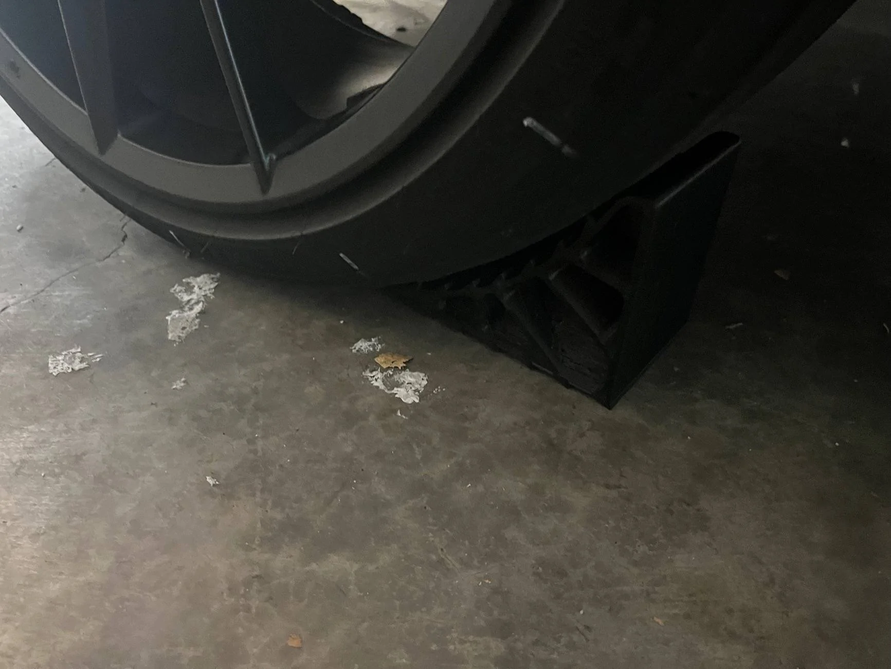

Fellas, all you need to do to change your rear brake pads is to NOT put your rear hand parking brake ON - That's it! Leave your car in first gear, and some wheel chocks.
I just did my brake pads - I can't believe everyone is instructing everyone to disassemble the rear brake OR get an OBD2 scanner.
I was like - this makes no sense, and just changed my rear brakes simply by shutting down my car, leaving it in first gear, and not applying the Parking brake.
This video also shows you how - Common sense...... Am I missing something?
pss. he's not using the brake compression tool properly - you want to use an wrench on the bolt and twist at the same time in opposite directions.

Disassembling parking brake or using an OBD2 computer is not needed.
Here are my steps:
1) Don’t put parking brake on, and keep car in first gear. Wheel ch for safety.
2) Take two 7mm hex screws off and metal clip
3) Crack open brake fluid reservoir, screw back compress brake piston (grease occasionally seal)
4) Drop in pads, screw back 7mm (grease occasionally bolts)hex, metal clip insert
Done
