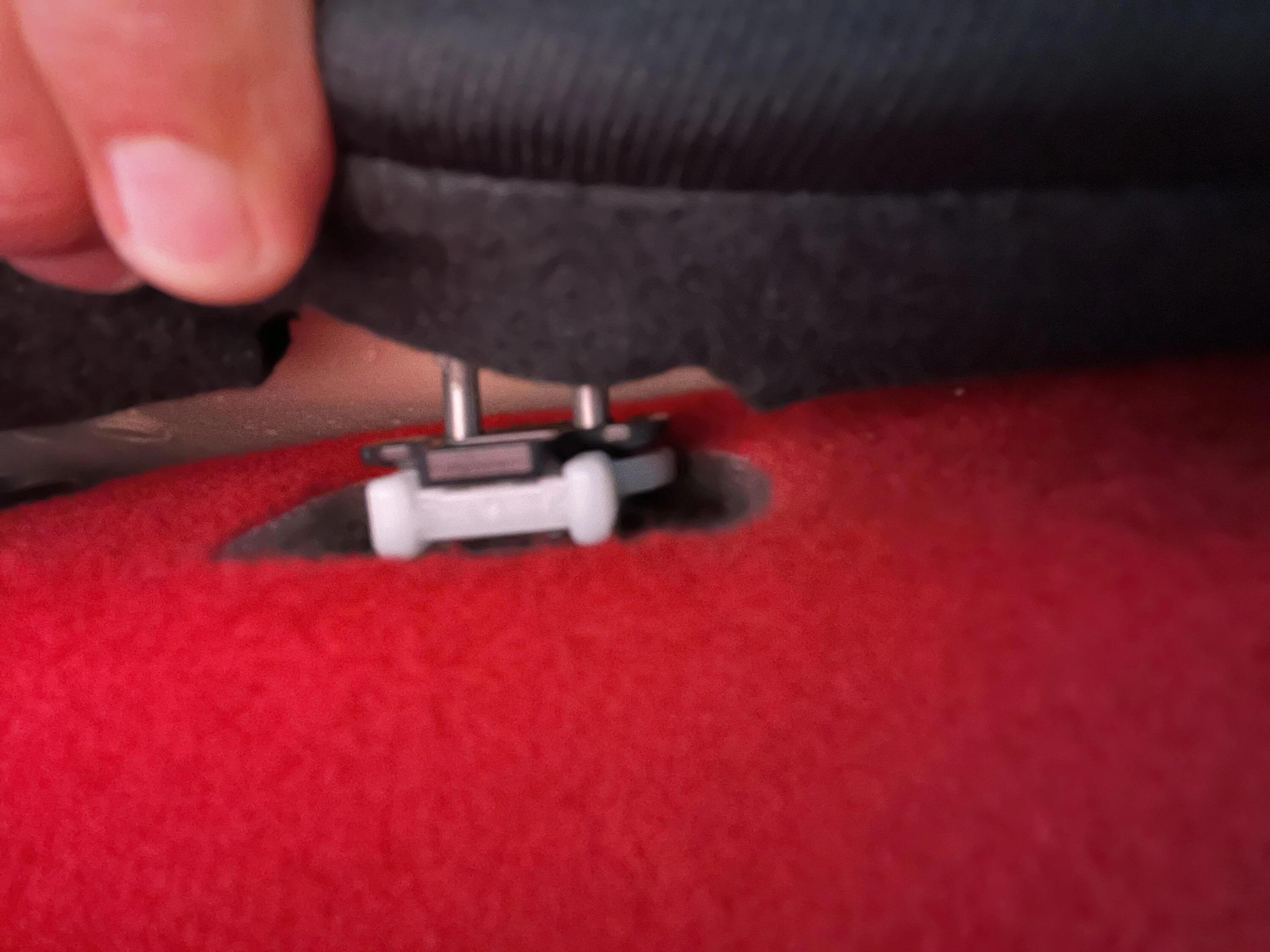

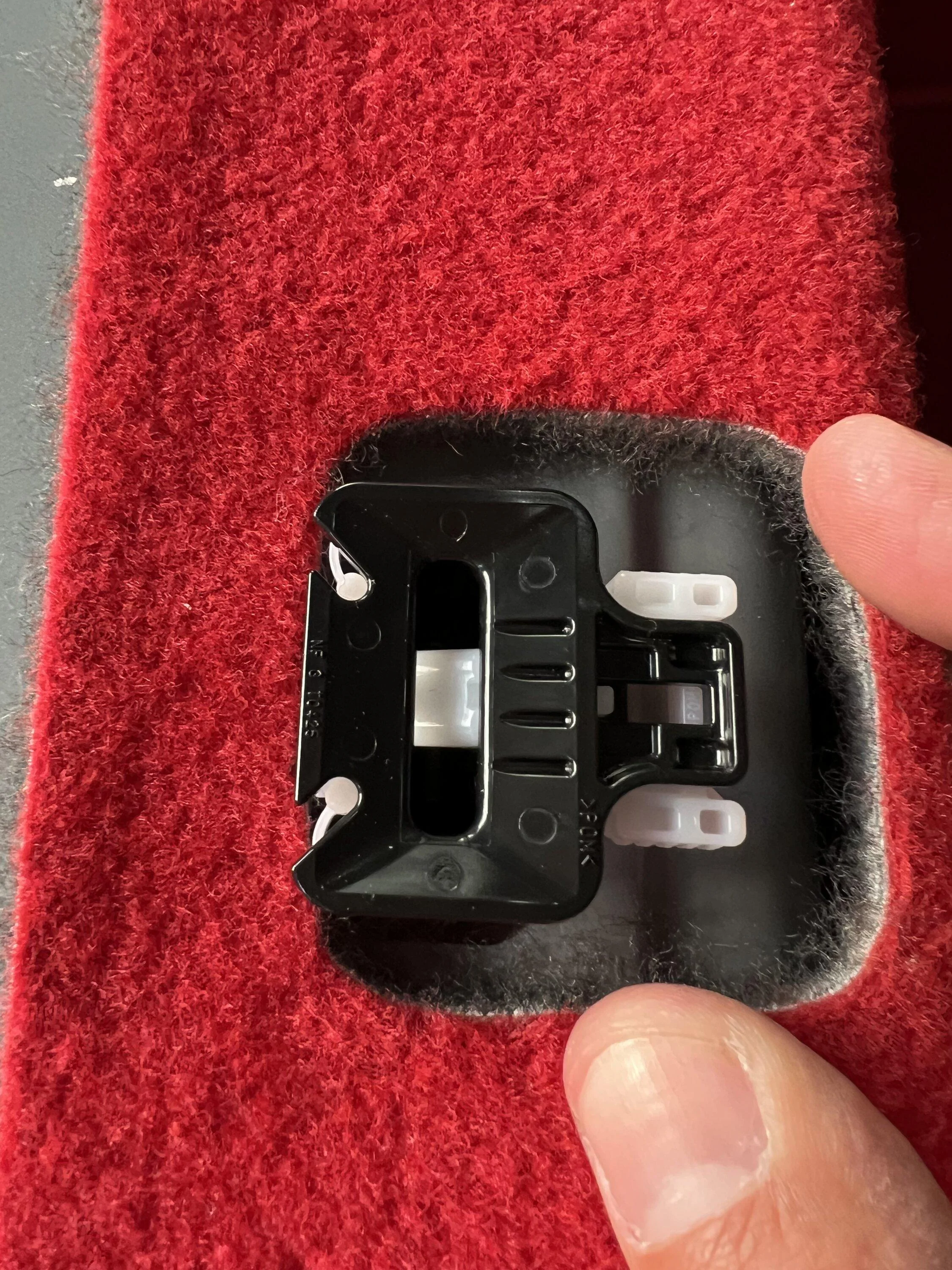

Just got back from driving it. Car definitely has a little more zip. I can't tell to much of a difference on the handling and turn in. I will probably say though adding a rear upper strut bar and a rear sway bar should counter any potential negative affects this weight savings may add. I did take two hard turns on the drive (there was a lot of traffic) and the rear felt a little more playful. Nothing drastic though. I'm going to drive it at highway speeds here shortly to see what the cabin noise is like. So far at speeds of 30-50 it sounds the same. Overall the removal of everything took about 45 minutes. The hardest part was the bench seat. It has these pinch clips. It's a new design Honda has came out with. In past civics or rsx etc you just pull on the seat and it comes out. Not this time. I felt like I was going to tear the damn thing apart. lol.

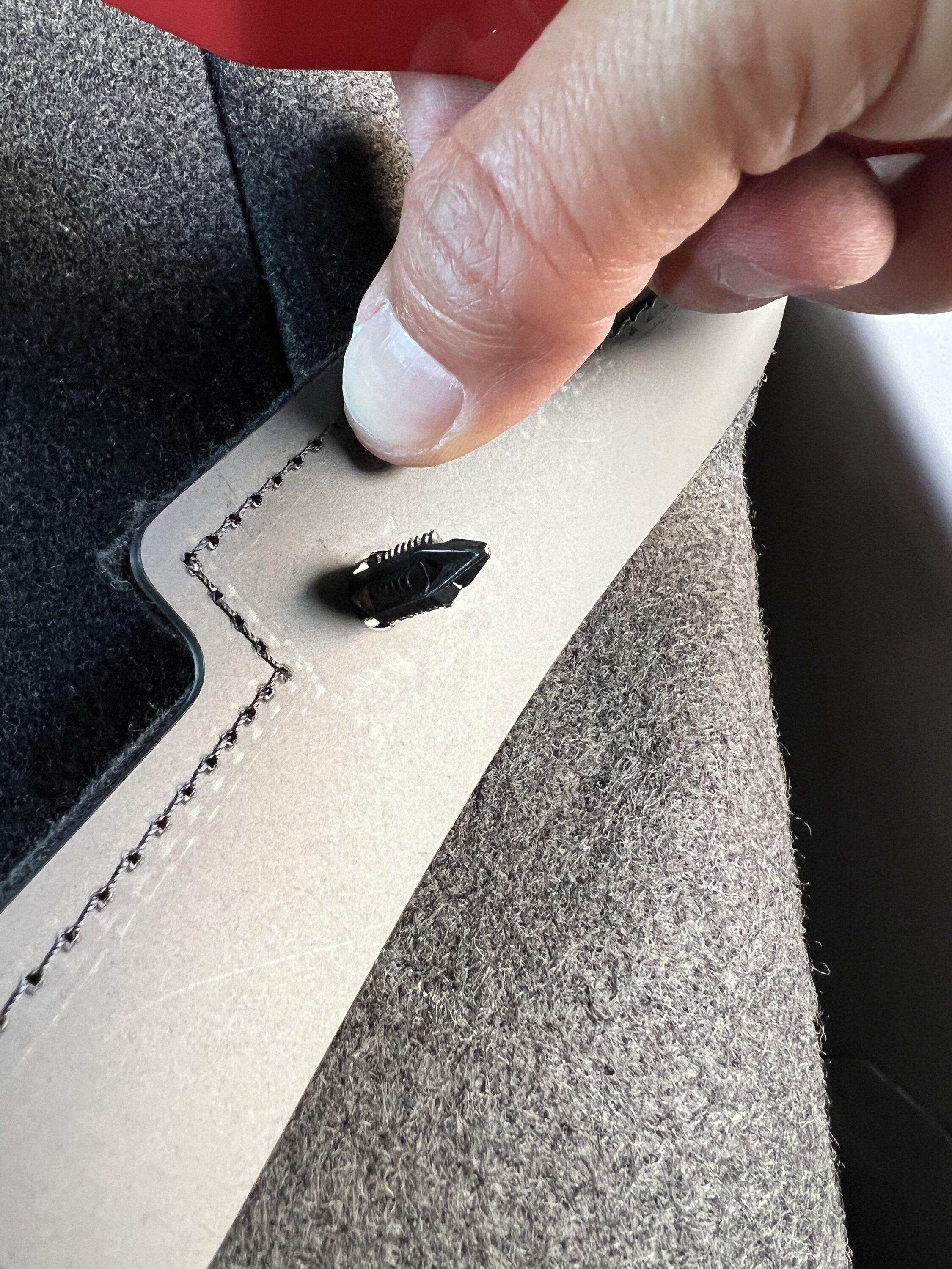

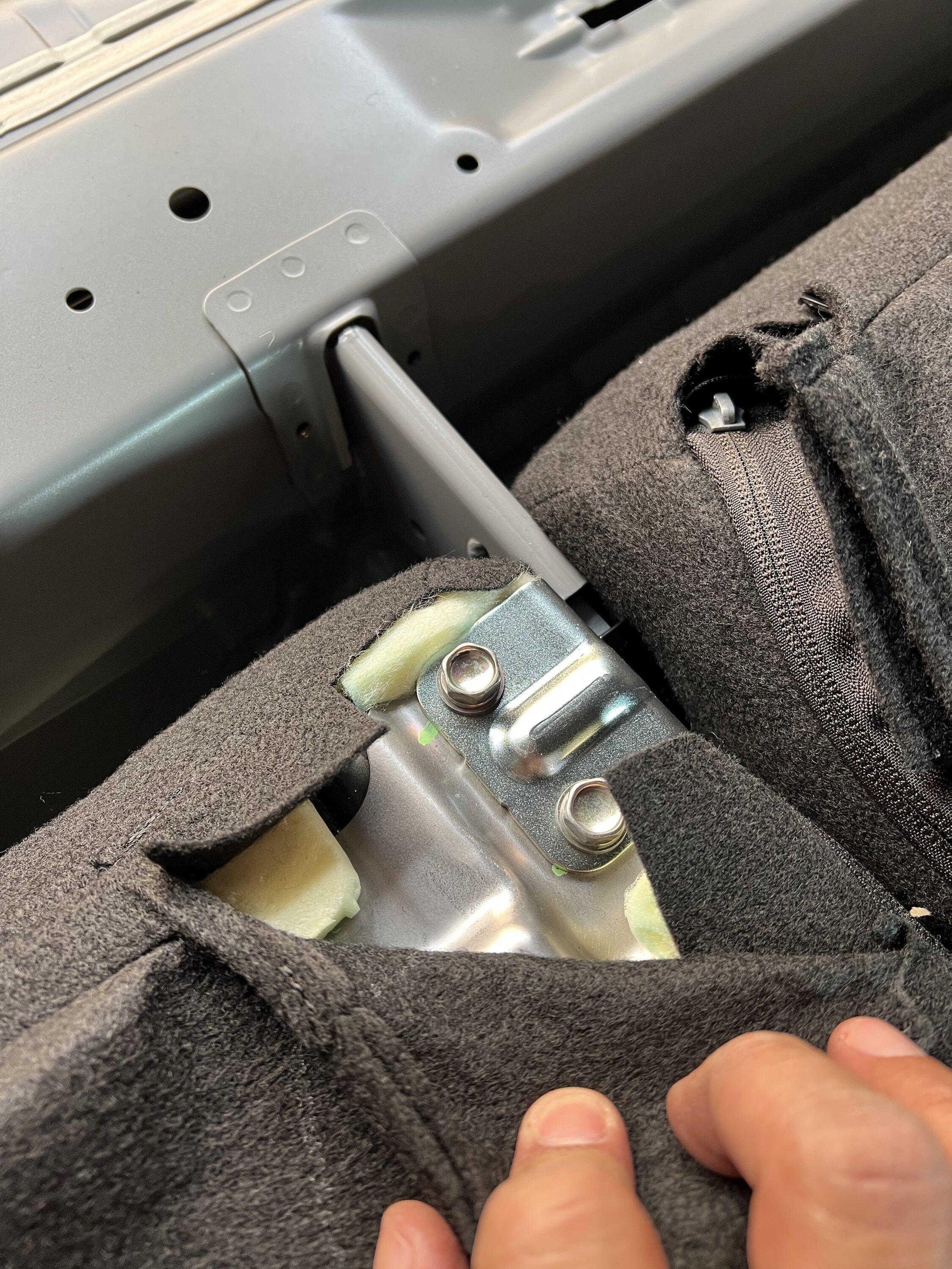

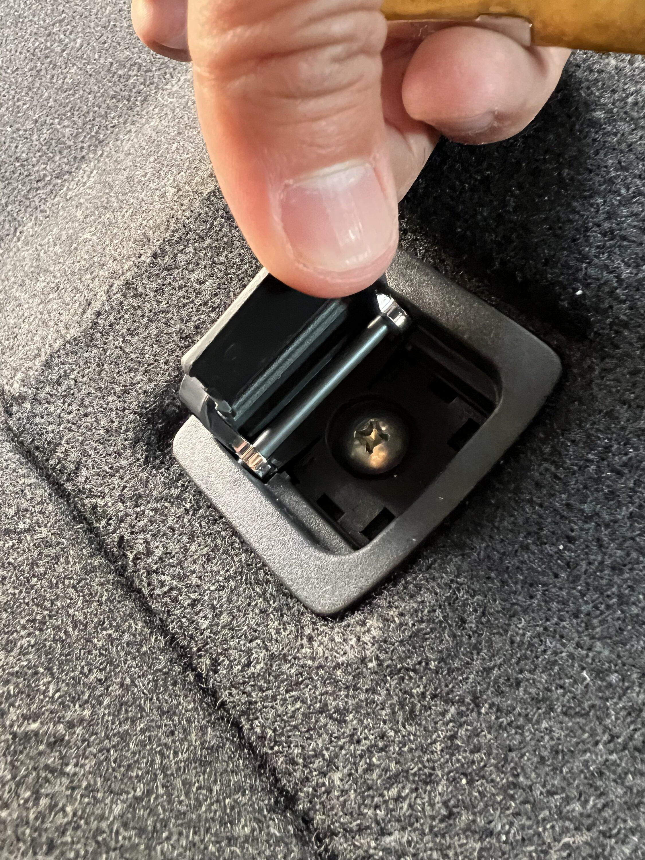

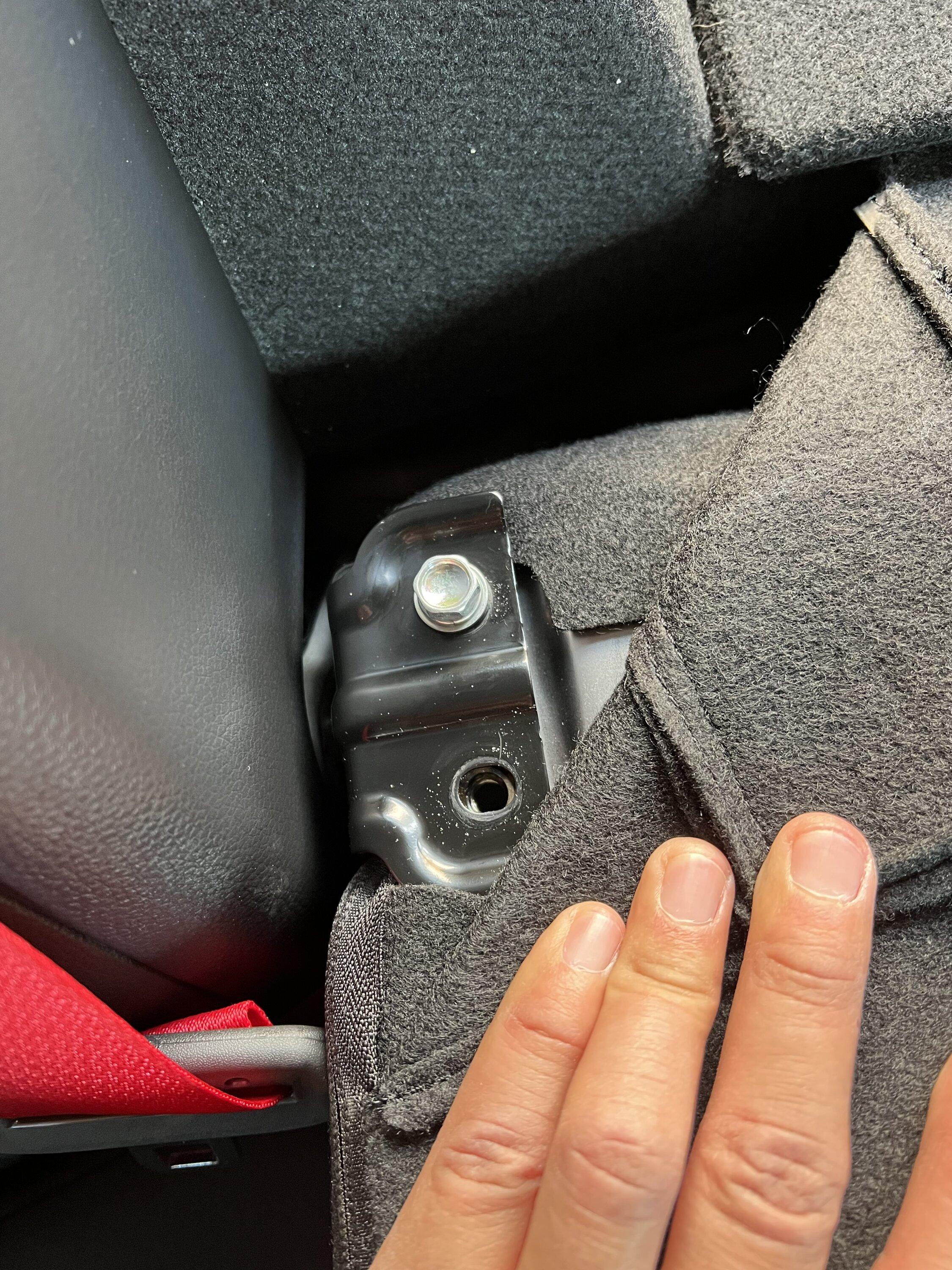

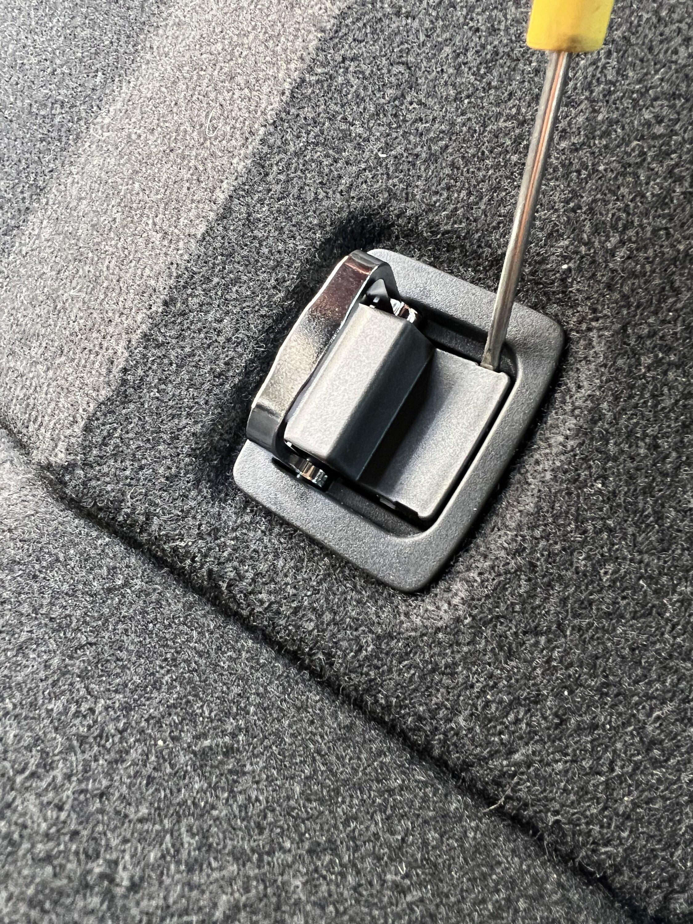

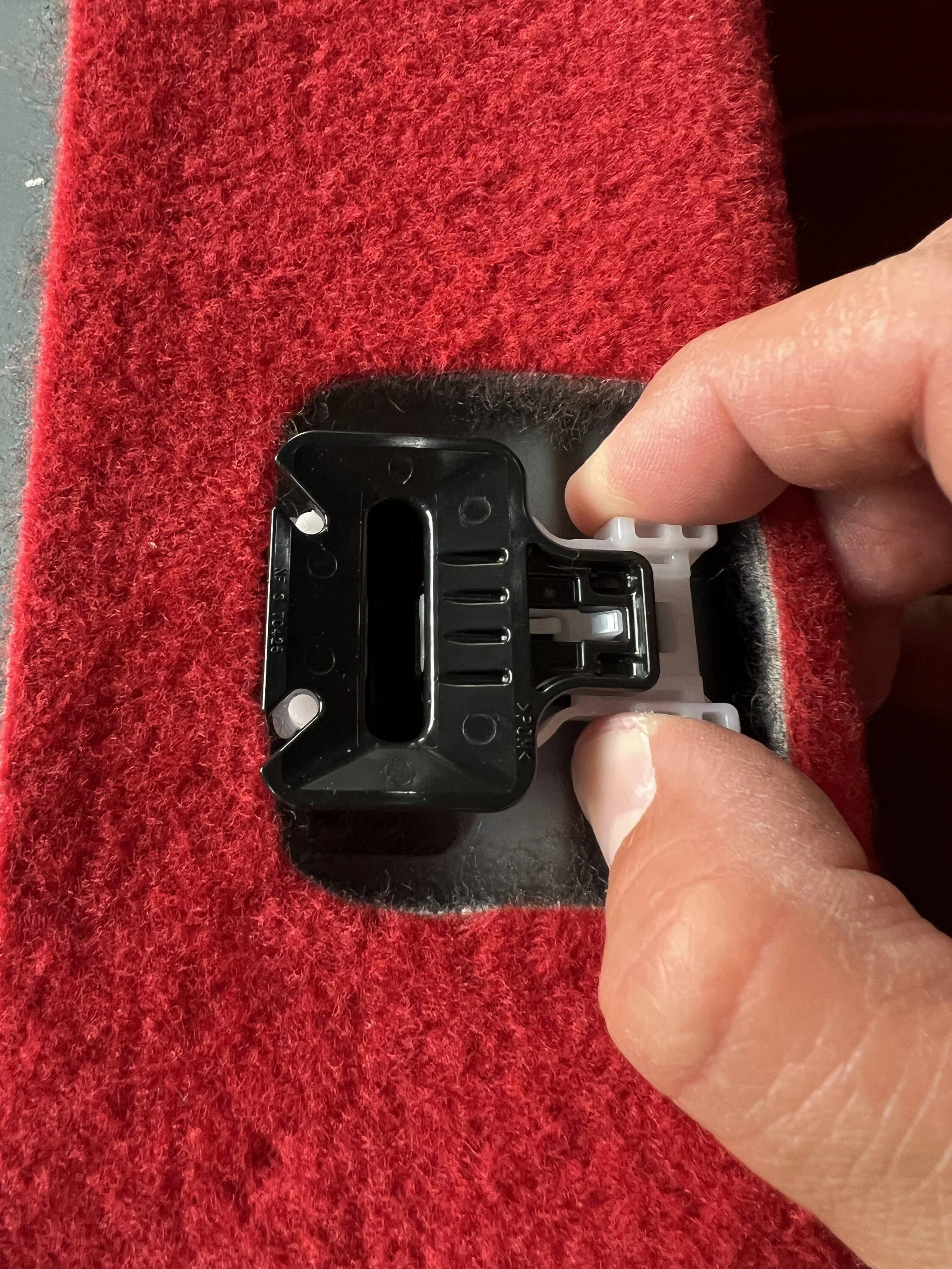

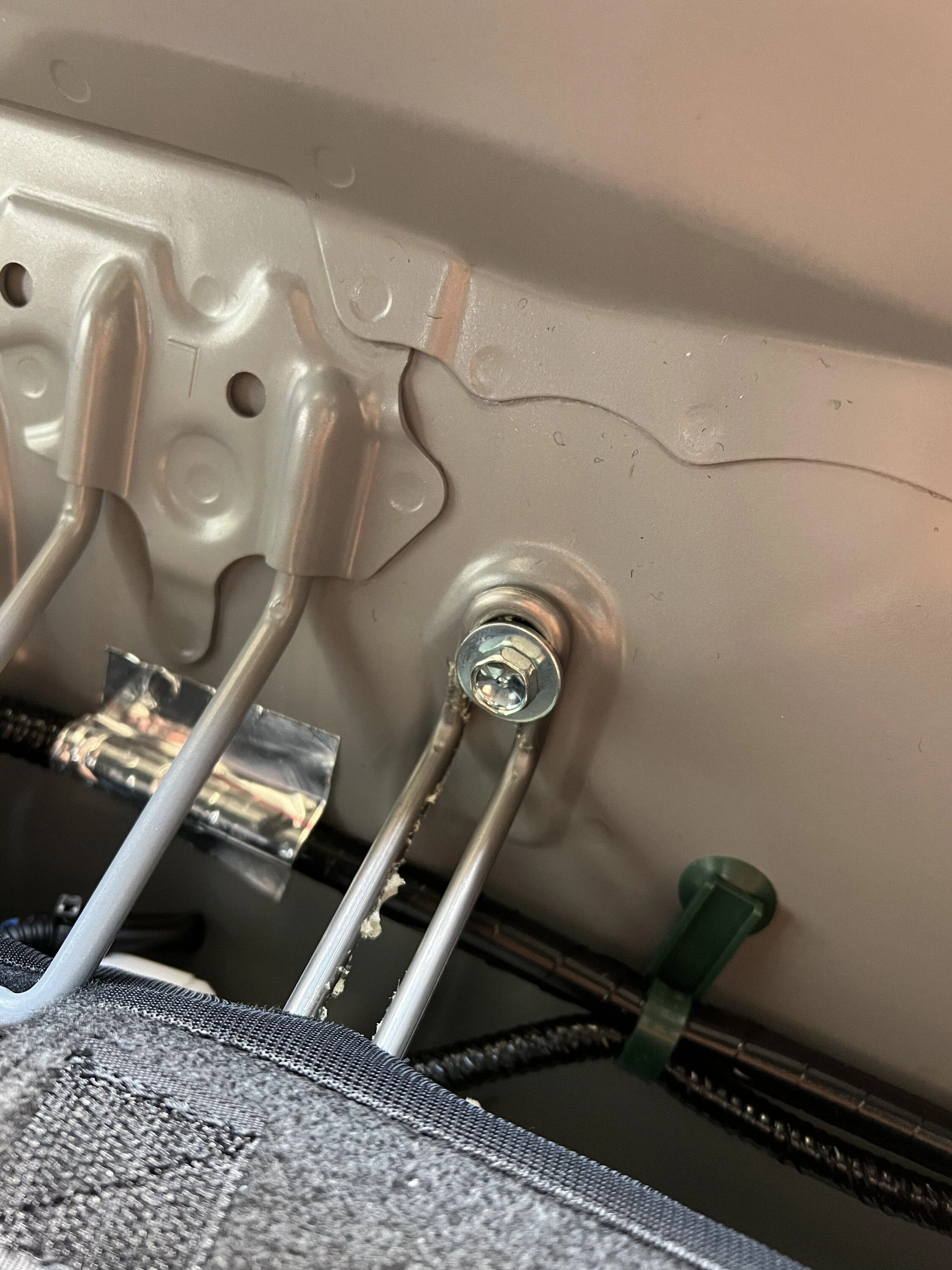

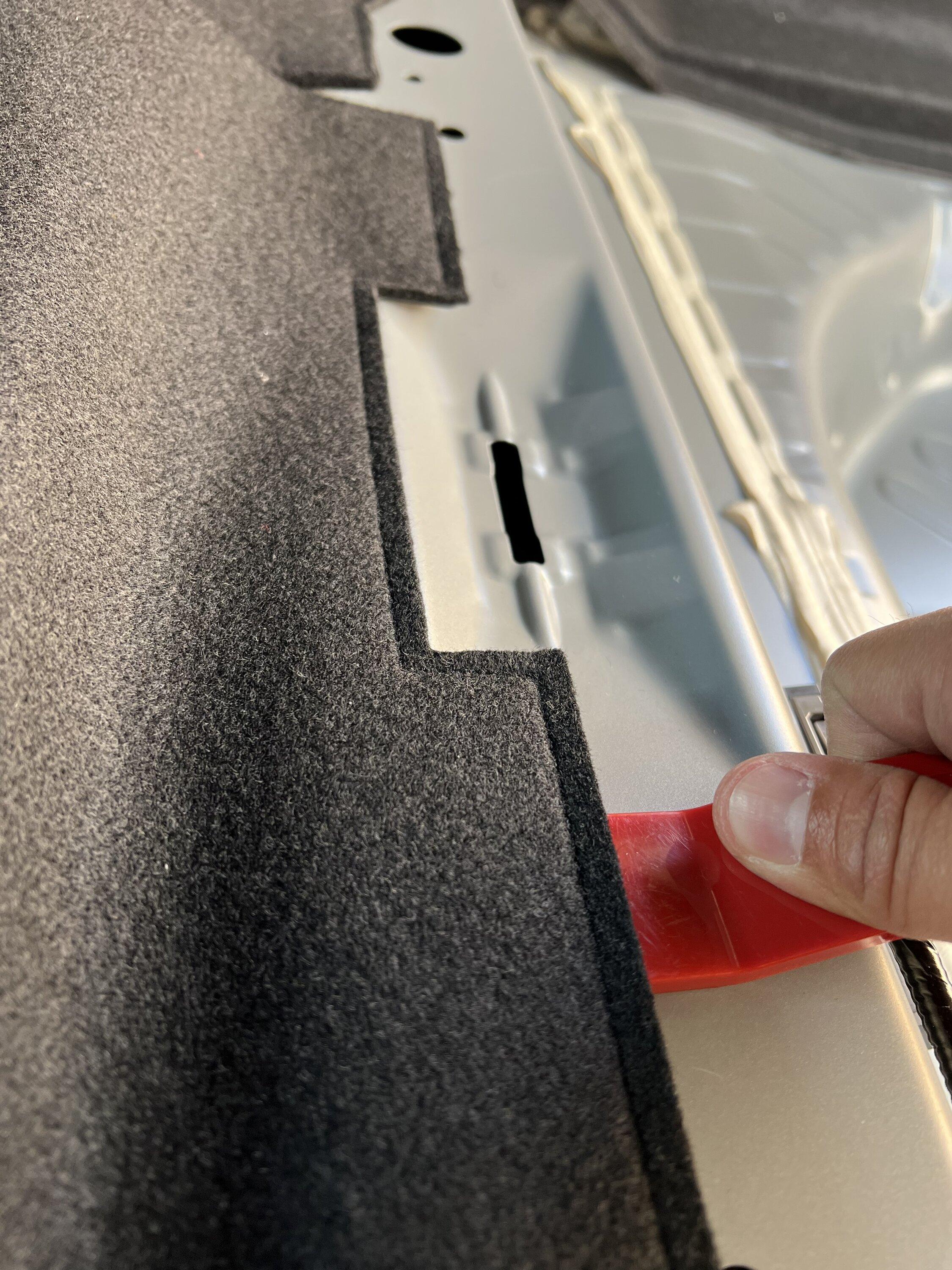

Here’s pictures of the rest of the removal. All the bolts clips etc. Both rear back seats have a total of 8 bolts holding it in place. One that is removed you have two other bolts holding the bench seat in place. The rear cargo tray has two star shaped screws holding it in place.
