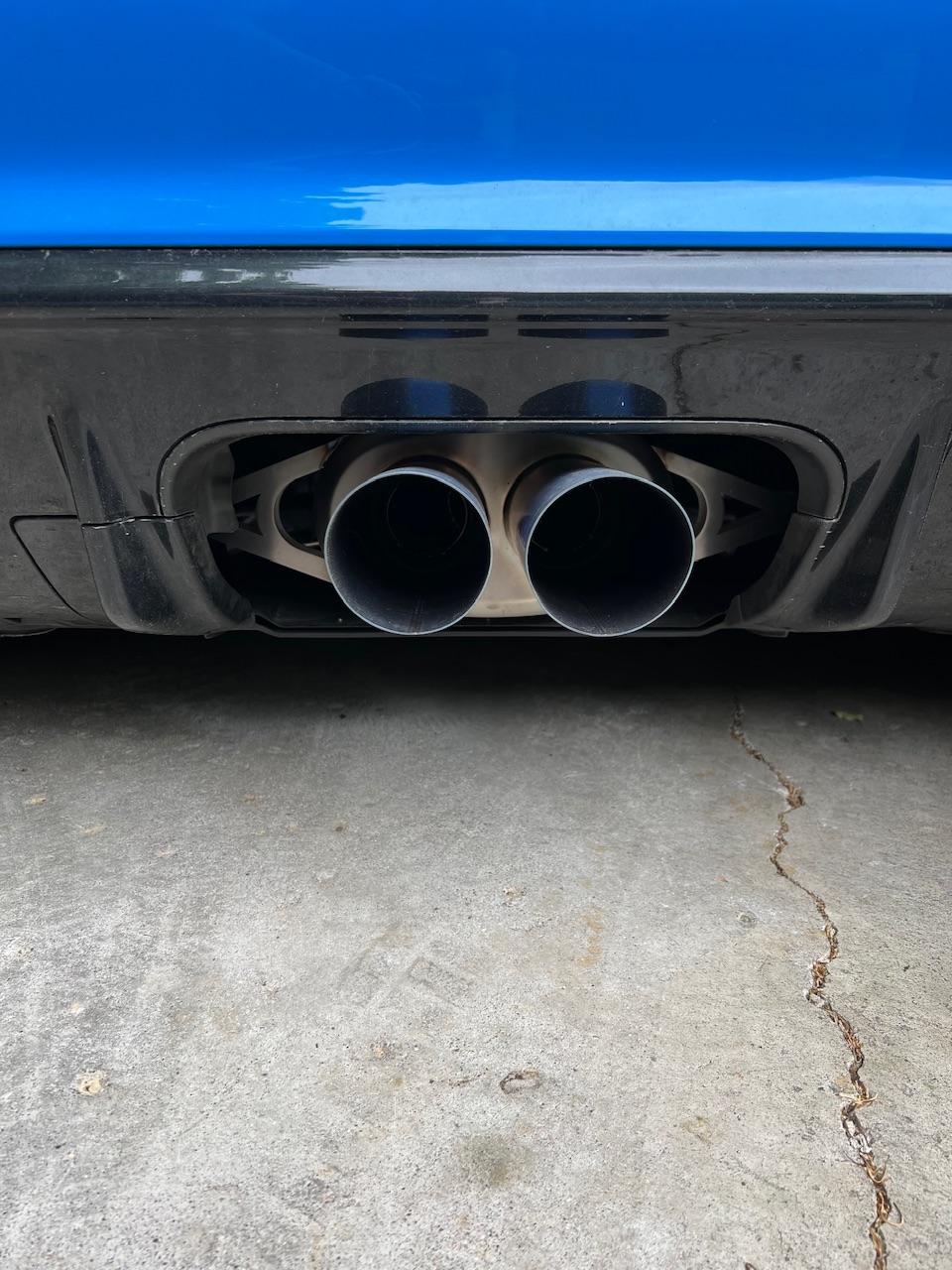

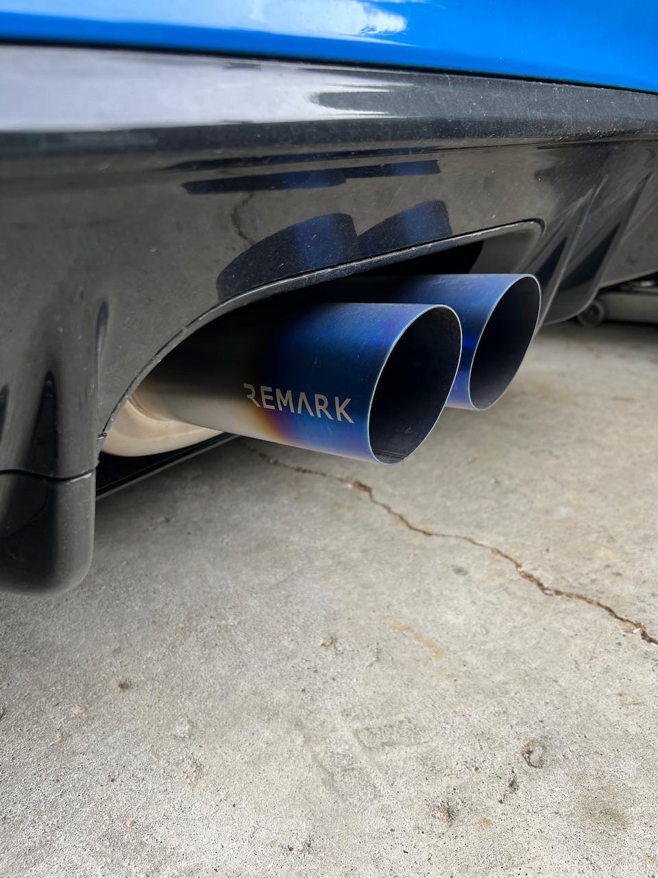

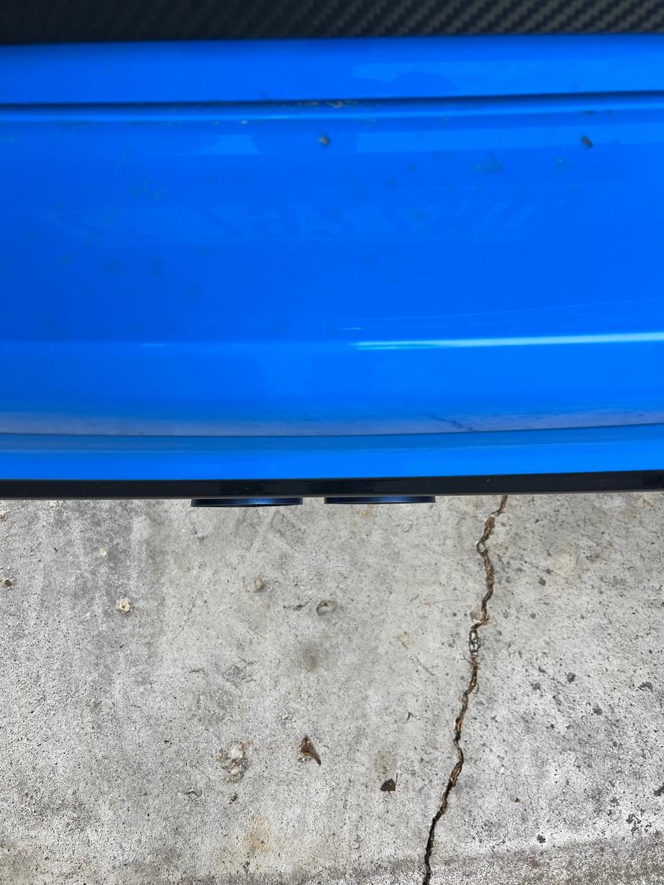

It’s pretty dirty, but here they are. I’m afraid I don’t have any videos.
I love this! So clean and the tips match the BB color!
