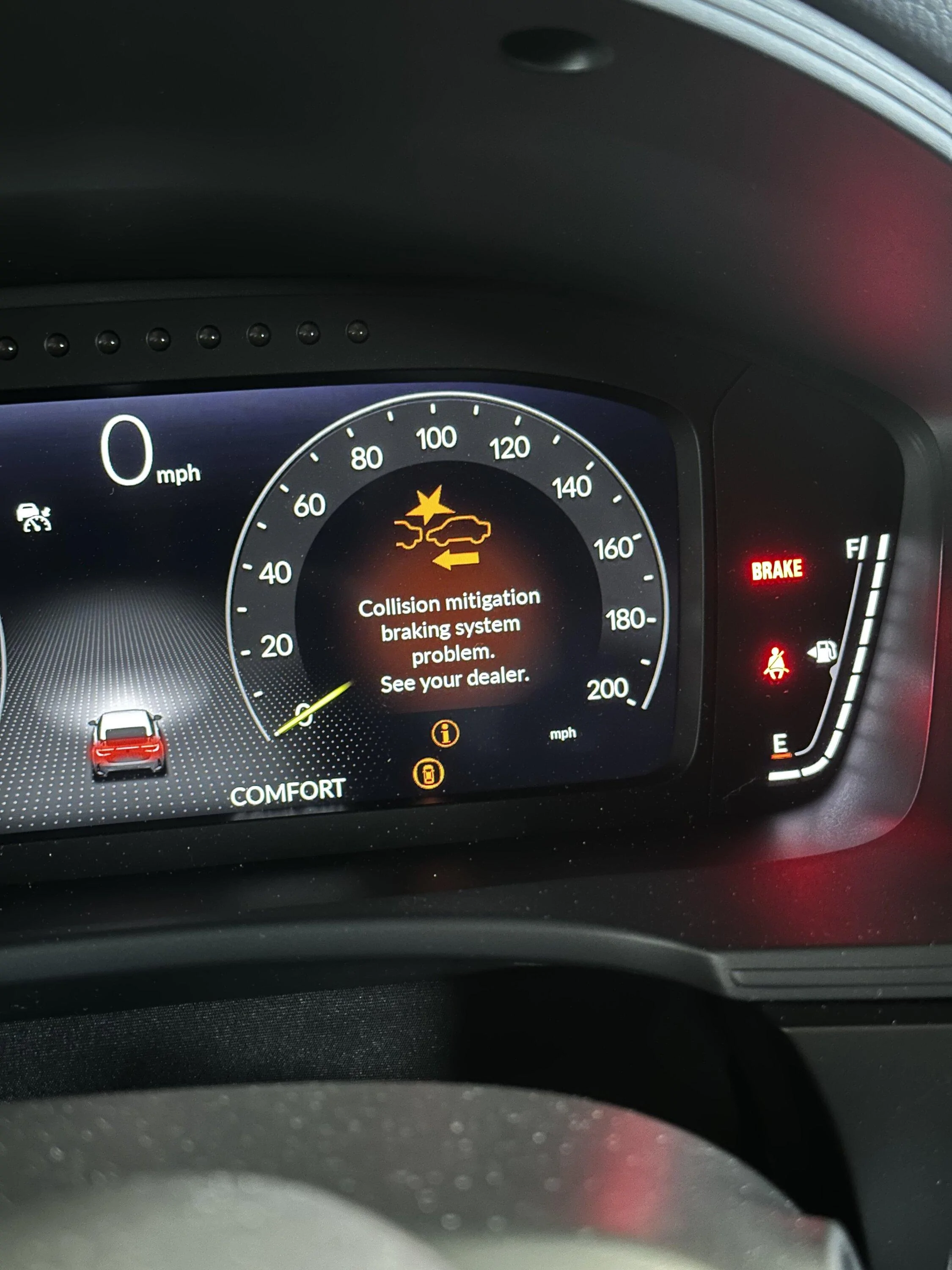

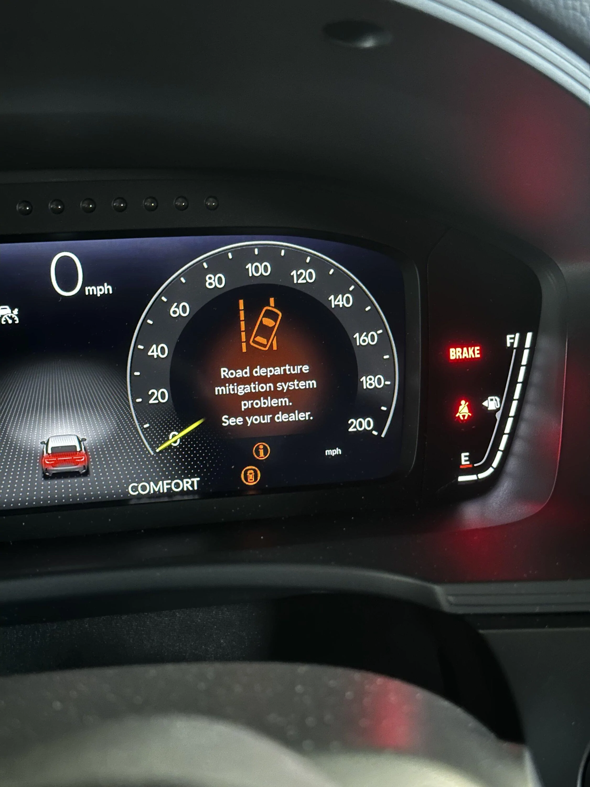

So, I just got my car delivered the other day and had these errors present from the very first time I drove it. I've tried resetting the battery and don't see any codes on my crappy scanner. What's weird is that I can sometimes get it to work by opening the Honda sense menu before the engine is turned on, so it must be a software issue. I'm gonna go to the dealer tomorrow but wanted to see if anyone else has experienced this so that I can help them fix it more quickly. Or maybe there's some simple fix I can do myself? Thanks in advance

Only other thing you could do is check that the windshield/rear window is clean where the cameras are.

I already gave the car a full detail, so unfortunately it's not that

Went to the dealer and they reset everything. It worked for a bit but came back next time I started the car. I'll keep updating this thread in case it happens to someone else.

I had this a few times in a row, but it turned out to be my radar detector placement. I moved it, and no issues since.

So I actually just got this fixed. The dealer ordered a new front camera module and all is well now.

So weird, it's not like this is a unique part for the Type R. Mine is still fine a couple hundred miles later thankfully
