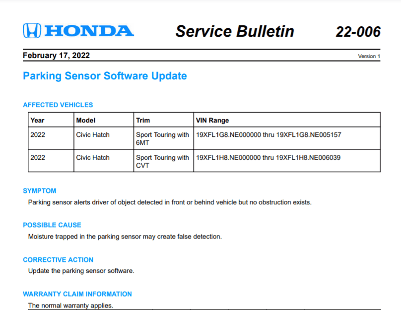

SB 22-006: 2022 Hatchback Sport Touring 6MT & CVT software update for Parking Sensors

My VIN is older than this range but keep them coming. Nice to see the inside info that we may not normally see.

Making an appointment for mine. My stupid sensors are driving me crazy.

So are these TSB updates not able to be installed OTA since this gen supports OTA updates?
Looks like my vehicle VIN is in there, so might have to make an appt again.
4/18: Went in today and got the update done no problem. Hopefully I won't experience the issue again.

Dealership didn’t believe me about it so I text them the picture. I have appointment Friday.
