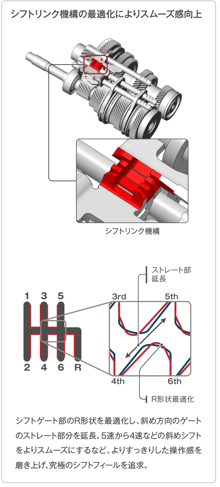

Did anyone see this note in the info packet? They specifically refined the shift gate to make shifting smoother and reduce hangups. See the change in the gate shape and them calling out the 5th to 4th transition:

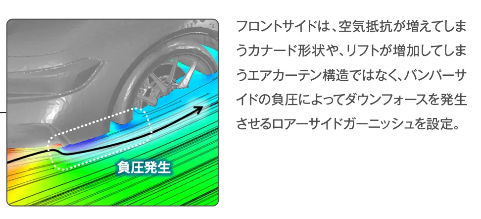

All the Youtubers call out the fake air curtain vents, but the fake vents are actually an aero device to add a low pressure zone next to the wheel well to evacuate air and reduce lift:

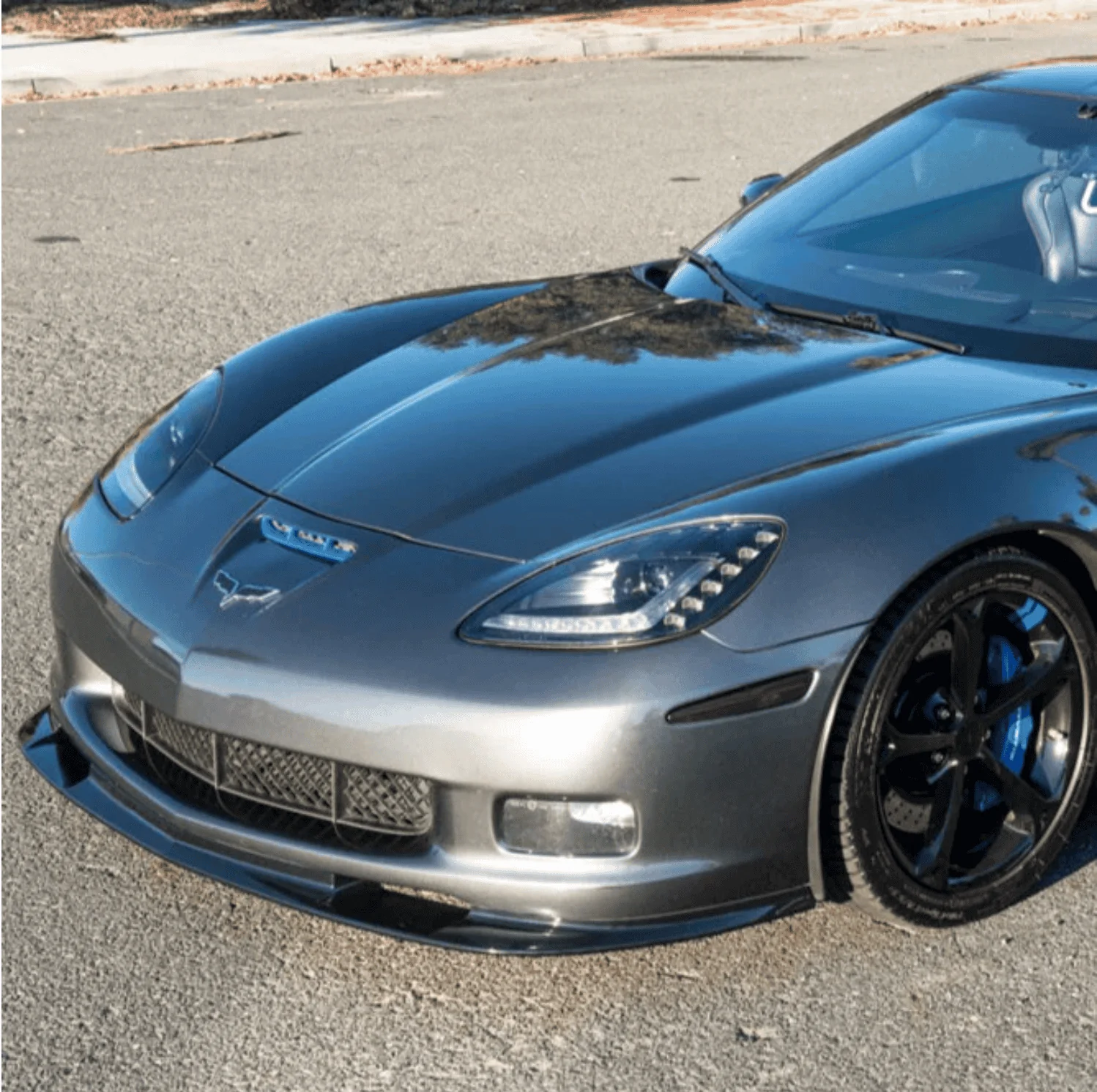

It's not that different from the vertical gurney flap that GM added to the C6 Z06/ZR1 Corvette's front fender edge. (See the black plastic edge at the front of the wheel well.)

Thank you for that...
It was slightly confusing. Some YouTubers said it was fake and maybe one or two pointed out that Honda said it was functional but really did not give specifics beyond it.

So I would assume that going with aftermarket wheels with a different offset would reduce the low pressure zone?

Yes, but I wouldn’t worry about it too much. You could always add a splitter or put dive planes to make up for it.

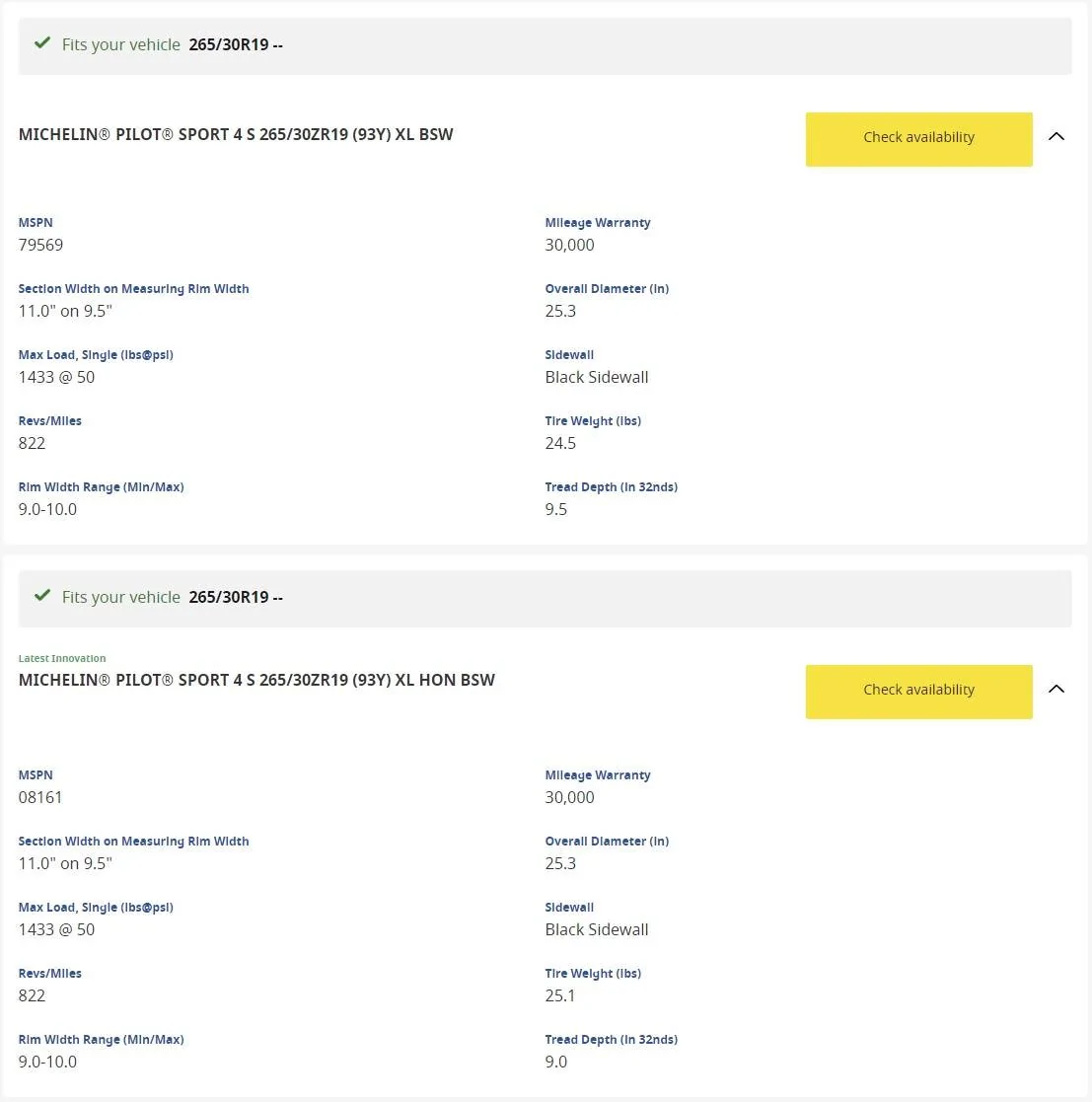

I guess this is the H0 version of the PS4S on the Michelin website, the one with the "HON" in the name? I didn't see it a few weeks ago when I checked, so they must have just added it to the site.

What's interesting is the Bridgestone Potenza RE010 tires for the 90s NSX were also called the "H0" version and it had H0 molded on the sidewall. The Michelin Pilot Sport Cup 2 M0 is the Mercedes specific version so maybe this is a naming convention.
