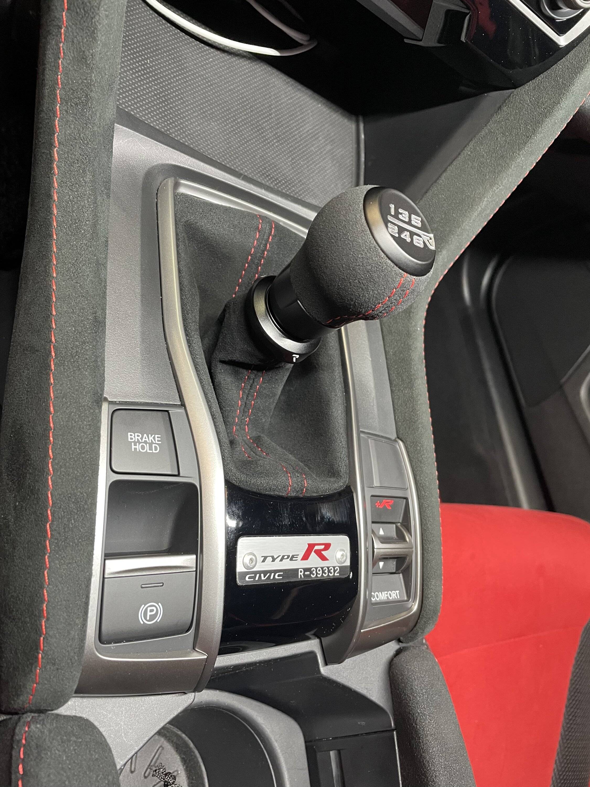

I can concur it was an absolute pain in the ass to remove. I ended up twisting the knob off and then getting the boot to pop down that way. Never had this issue on the fk8. The shift lever is also curved at the bottom and not straight like the fk8 so it took some different screw hardware with my raceseng knob and collar to get it to fit.
Thats a good looking knob!

That is beautiful IMHO. In US dollars, how much is this Knob and where do you find it ?
Thanks. The OEM Shift Knob is great as well as long as it’s not hot or cold where you live.
