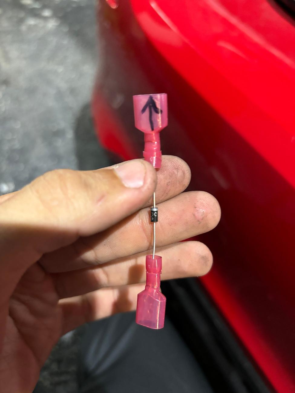

I crimped two of the T-wire connectors to each diode and marked the diode direction:

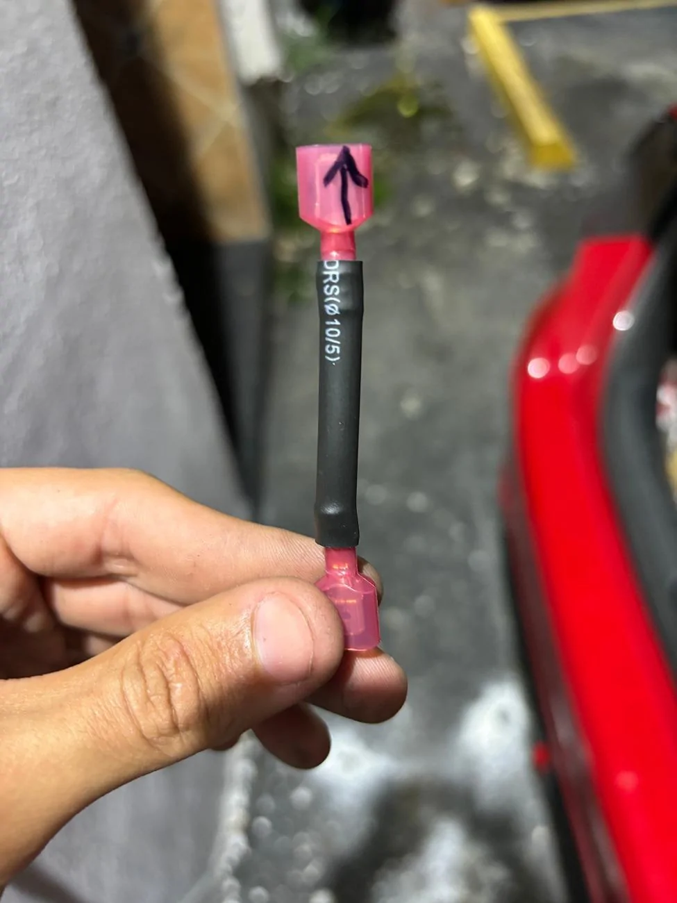

Then, I applied some thermal wraps to ensure the conductors don't touch any parts of the car and cause a short:

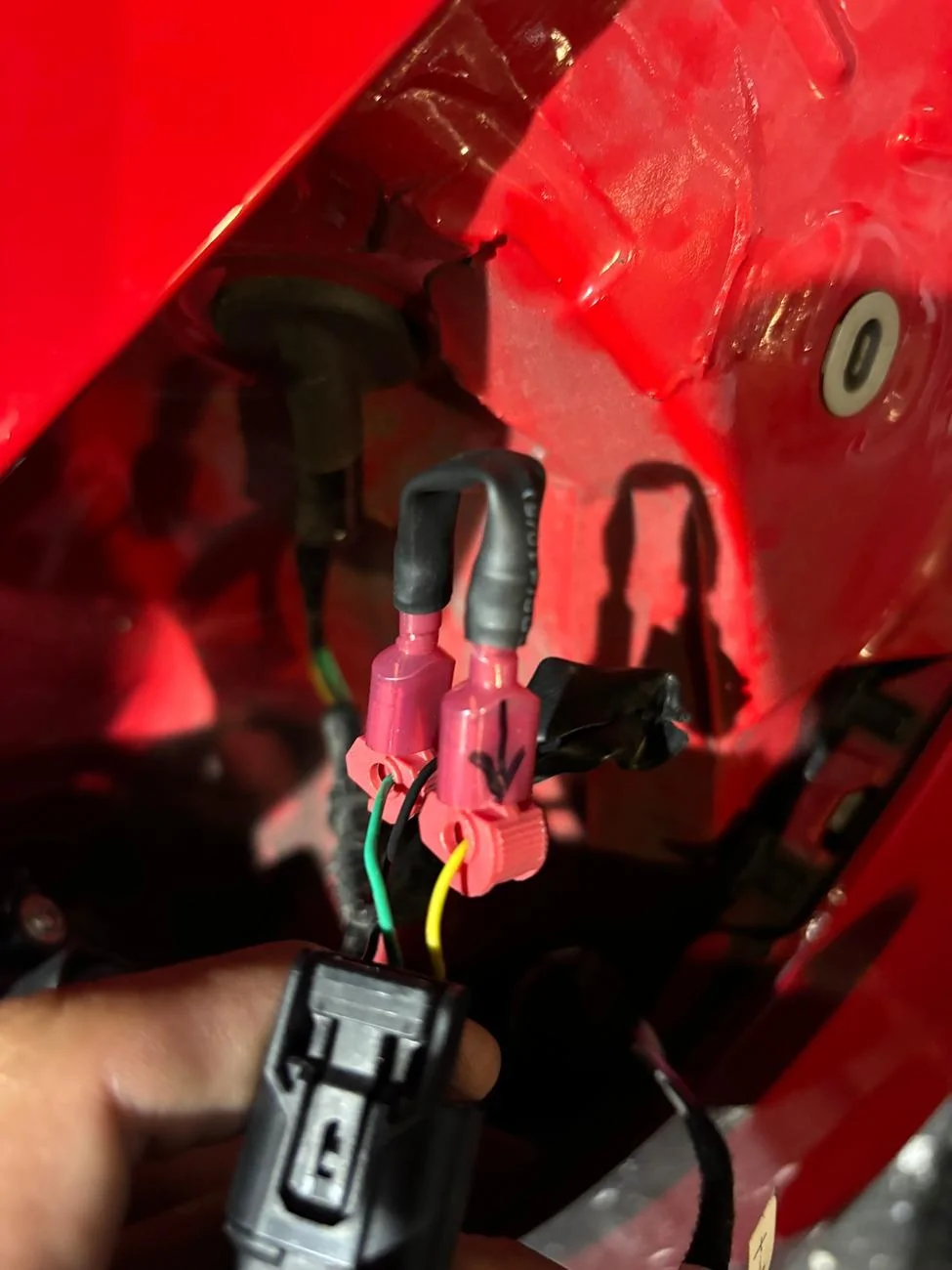

Connect the diode to the lights: the green wire is for the brake light, and the yellow wire is for the tail light. Make sure to position the diode in the correct orientation so that the current flows only from the green wire to the yellow wire:
