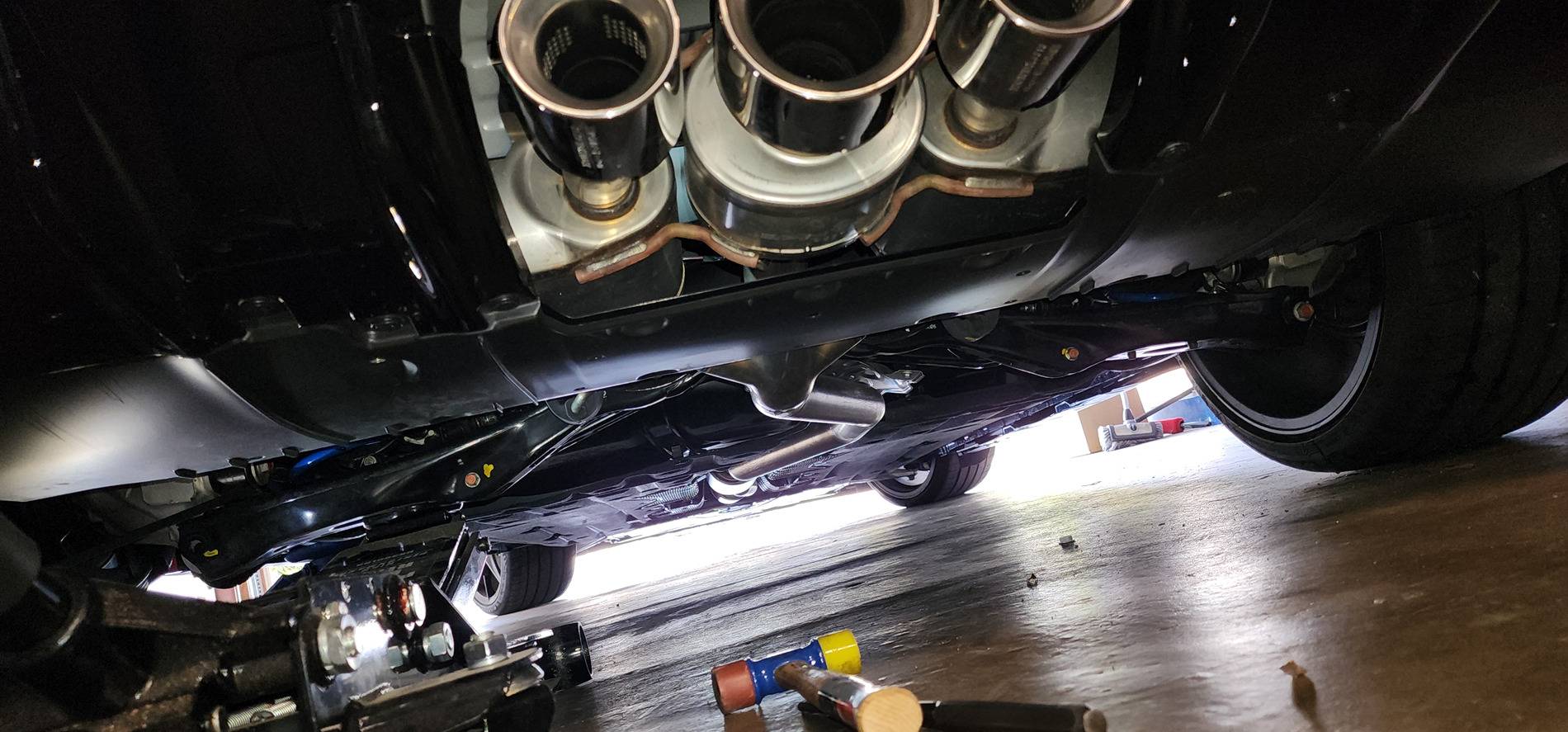

Just installed my Spoon Sports Progressive springs with my father-in-law. At first it didn't look much lower, and there wasn't noticeable difference in the ride. After about a week, the springs settled and the ride was more bouncy in R+ mode. I typically drive in Comfort as I enjoy the difference when I switch it to R+ mode, and now that difference is much more noticeable with the Spoon springs.

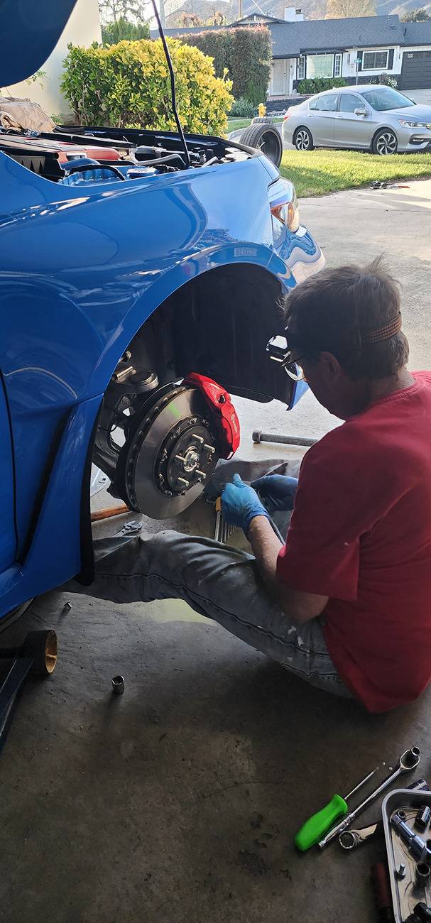

The install was a bit of a bitch. I think we got the rears done in under an hour, but the front was another beast. We watched all the top youtube videos and started with the driver side. One mistake was loosening the tower nuts as it lowered the strut into the knuckle that it needs to be removed from. Every millimeter counted here, so we ended up disconnecting the sway bar end links to add some play to both sides of the axle.
We didn't have a knuckle spreader, so we had to pry the strut up out of the knuckle while shimmying the top of the rotor to work the strut up. Another trick was to place the strut bolt back in after it was lifted to prevent it from sinking into the knuckle while also providing a pry point.
Finally, I wanted to see how much we could gain by tightening those tower nuts to lift the strut and sure enough it cleared just enough to be pulled out.
We thought it was smooth sailing from here, but somehow the passenger side was even worse. I thought I was gonna have to leave the OEM spring in at one point and drive it over to a shop lol. After much persistence, I don't even know what we did differently, my wife came out to check on us as it was dinner time, and the strut popped out.
Long story short, it's not a terribly difficult job, but have a knuckle spreader handy. 80% of it was dealing with that.

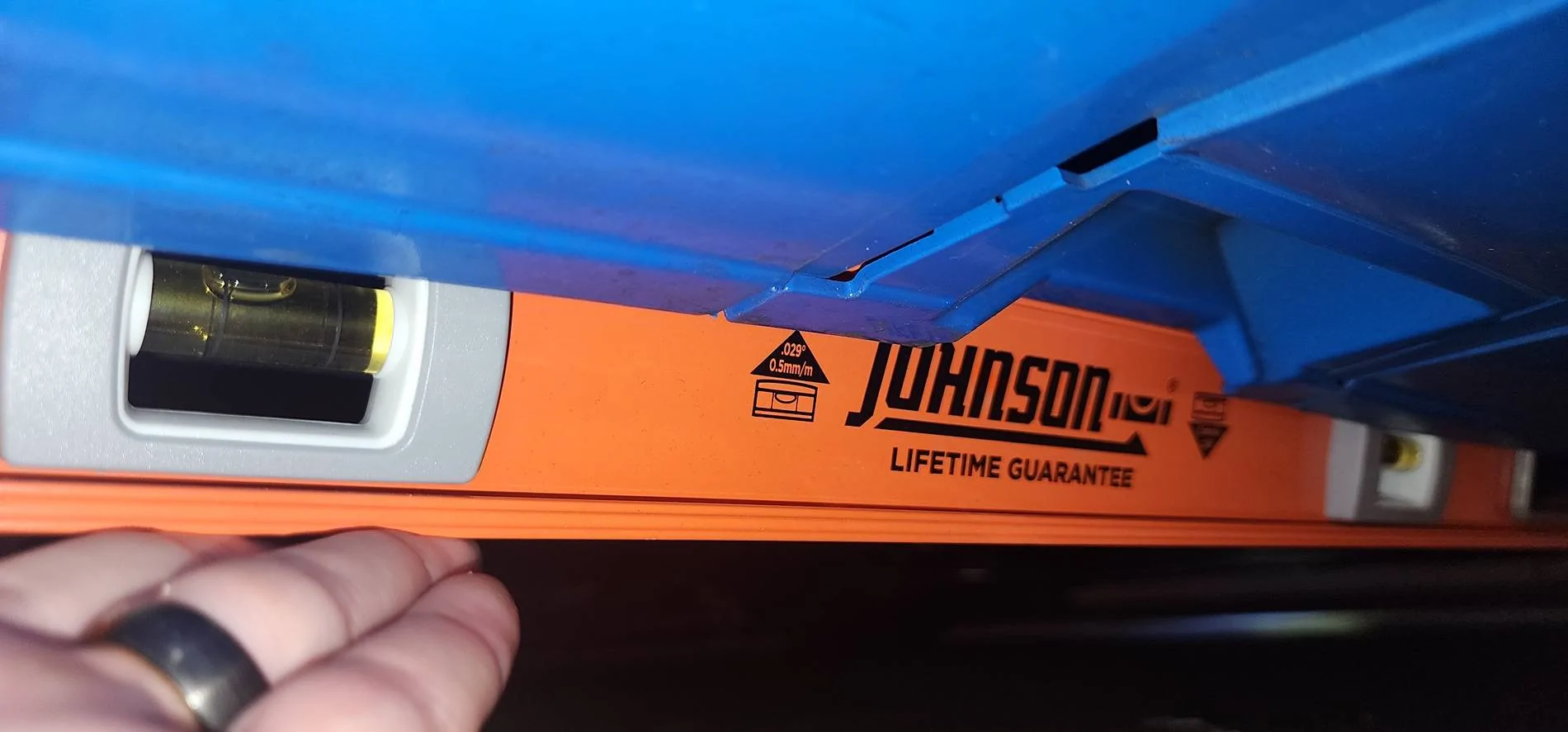

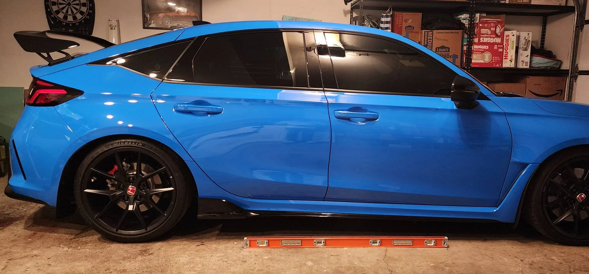

In the pics, I was measuring for negative rake using a level against the underside of the frame (after verifying my garage is also level lol) and it looks to be good. Spoon fixed this issue apparently, I'm curious if anyone has updated their springs or noticed any negative rake even with their new replacements.

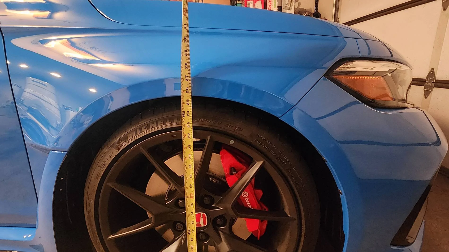

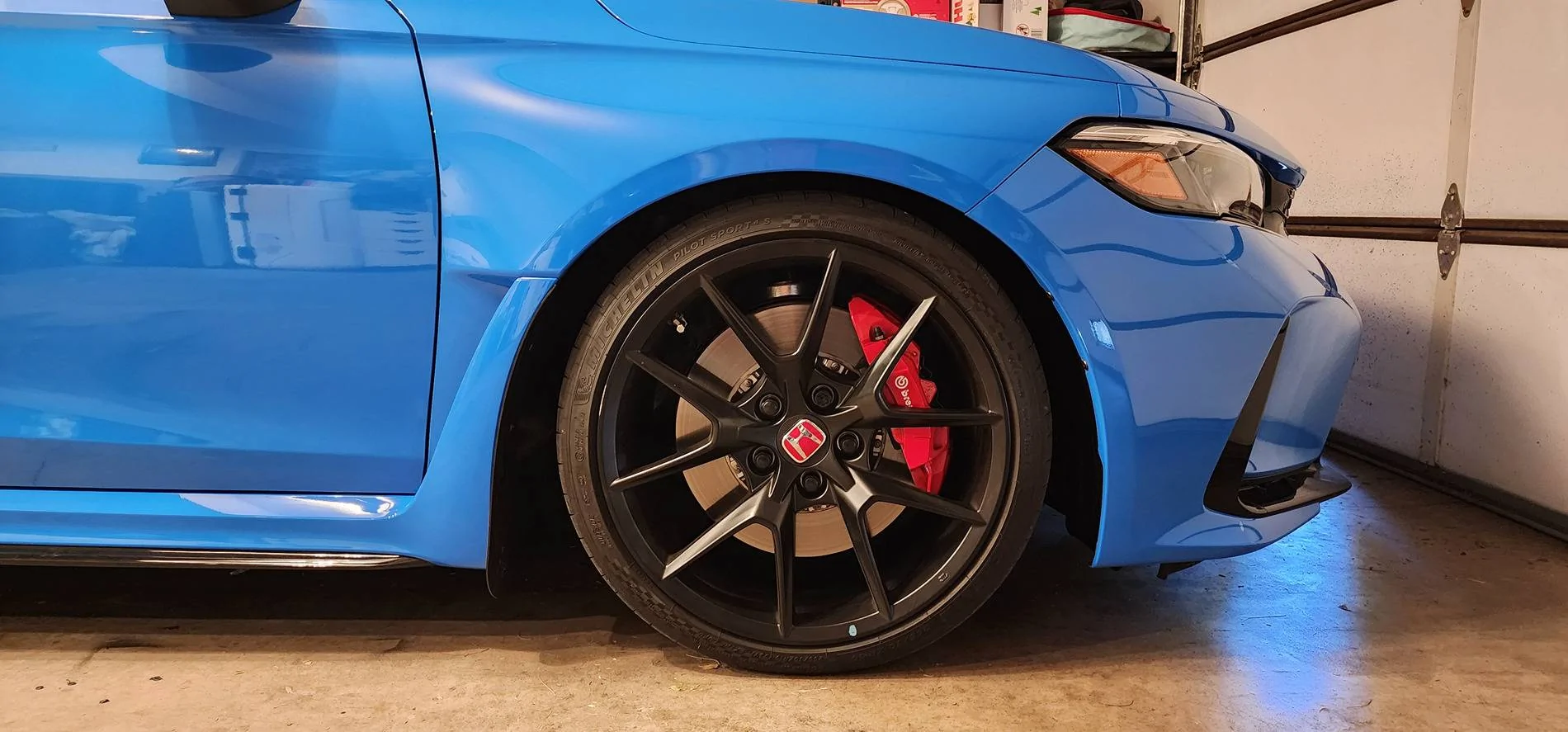

Can you please measure the distance from the top of the wheel arch to the ground for front and rear? I’m curious. Also a side profile photo showing the entire car in the daylight will show if the reverse looks fixed visually. Looks great from what I see! Thanks for the write up.

Front is a hair over 25 1/2" and the rear just under 25 3/4" . Is this the actual rake measurement? Rear arch is about an eighth to a sixteenth inch higher.

Nice yours seems to be an even 3/4” drop on both front and rear which is exactly as advertised by Spoon.
