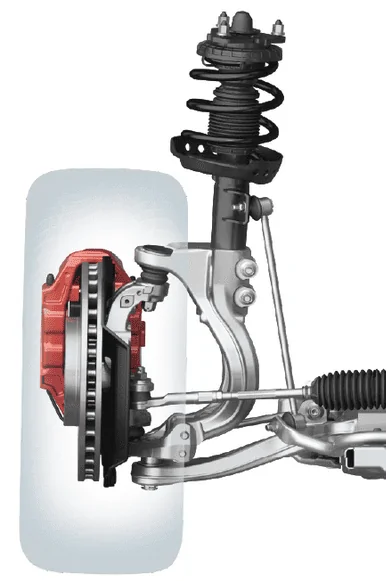

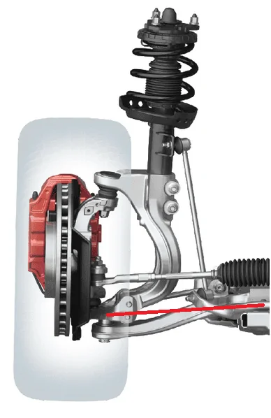

Yeah, that makes sense. I figured it was tested enough in real life. Since you removed your strut pins, it's also friction that is holding your strut in position. If any of these camber adjustments change on track, the resulting change in toe is definitely concerning. Wunderladen has recently started selling locks for the strut tower.
-2.7 is both on Spoon springs and without. As the macpherson strut doesn't benefit from natural camber gained from lowering. In severe cases it actually gains positive camber throughout the bump stroke.
I didn't expect that. Here's a FK8 just lowered on spoon's and strut pins removed with -2.1 of front camber. His bump steer kit improves the camber gain a bit, but I'd have expected a similar result in your FL5 i.e. closer to -3 deg after the lower ball joint.
Since the strut is slanted (even more after pulling the top pin) and the LCA at static height has to point down, I really expected some camber to be gained during initial compression (like after lowering a few mm). What am I missing? This is a drawing of the fk8 front suspension at static ride height, for reference:
This is a good point - however I figure that you've got the length of the strut as a form of lever and force reducer by the time the latitudinal forces make its way to the top. The math in my head roughly calculates a heap of greater forces acting on the knuckle than at the strut top. Additionally there are 3 bolts there instead of 2. I could be completely wrong though and I'm sure there are many who have experienced strut top adjusters on their coilovers moving after hitting a ripple strip too hard.. I guess all we can do is select parts we believe will be most reliable.
As a side note - the hardrace lower ball joint is advertised to increase negative camber in 1 degree increments - however I have found it closer to 0.9 degree's per increment. This however could be due to inaccuracies in my camber gauge or discrepancies during installation (some potential slop between the bolt and the bolt holes of the flip chip).
While the angle of the control arm appears to point downwards at stock height under static load in that concept render - the key angle is made between the centre point of the lower ball joint and the lower control arm pivot point at the subframe. Its difficult to tell where that exactly is in this diagram but here's a rough estimate - and it shows a far straighter line than the control arm angle suggests.
11th Gen Honda Civic Stock Front Camber and tire wear on track 1687933317871
From my testing I have found no gain or loss in negative camber at stock height vs -20mm. I believe its right where the articulation of the control arm is at its peak equillibrium in terms of the front camber curve on this chassis.
I'm not sure how the other's have gained camber there. However, I will remeasure to double check and report back.
