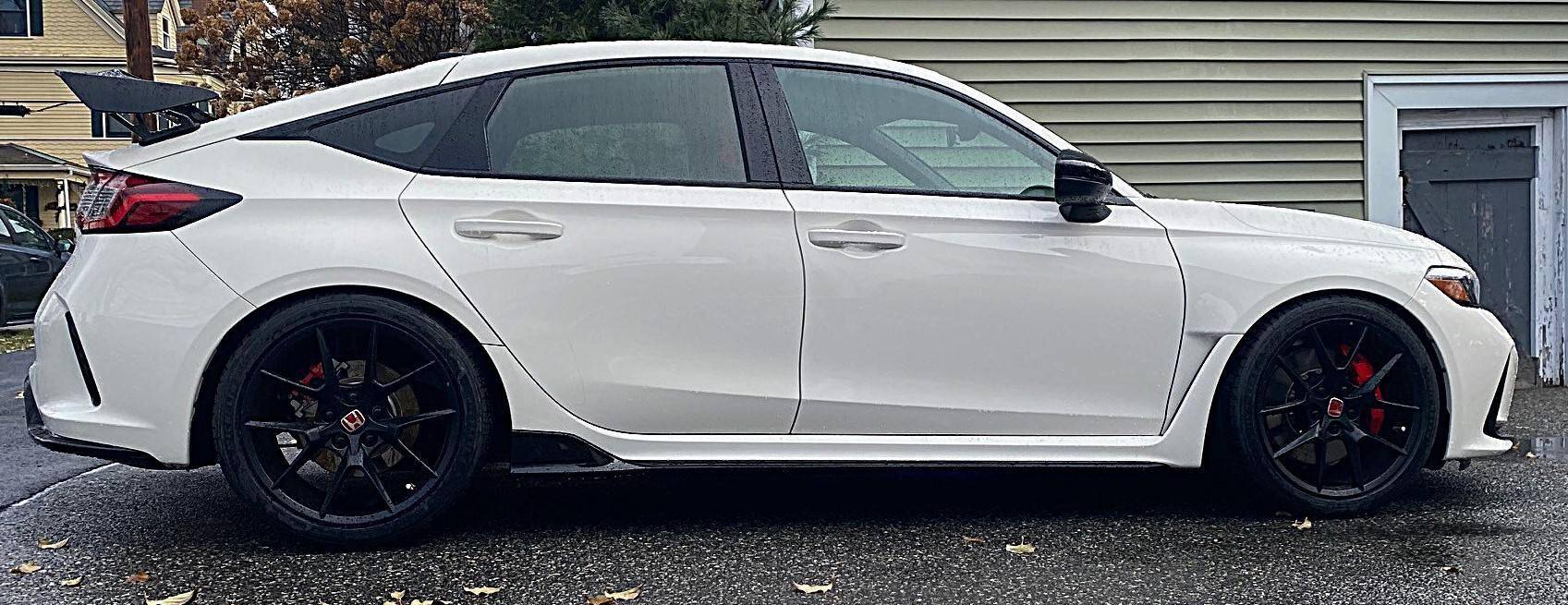

FL5HondaGuy
Oct 11, 2024
Boston
2024 Championship White FL5
This is my FL5 on H&R's. Mild drop that requires no bump stop trimming. Rides mildly stiffer in comfort and with the extra sidewall on the Pilot 4 A/S is more compliant around town. Car is not as sharp as stock but I don't track the car. I knew going in there would be some trade-off but I did not want to slam the car and grit my teeth every time I went over uneven pavement. Trust me, if you slap Swift springs on this car it will be stiff. With my slight changes I wanted to maintain as close to stock driving characteristics while improving its look. Moreover, I wanted to achieve a stock + look as I actually love the stock wheels and the white/black contrast. I know I might be in the minority but I think 19's look better than 18's. Unless you really close the wheel gap (i.e. losing stock driving dynamics) 18's look small. I know in the future I will be pursuing a forged 19 with a 40 offset. For now saving $4k on wheels, maintaining a very close to stock dynamic and improving the car's aesthetic will keep me happy. Good luck with your decision.
