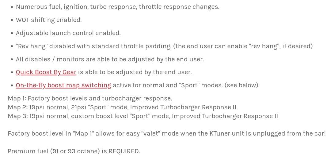

Got my TSP 1 Tune and the guide states that it takes advantage of the On the fly Switching Feature. I was hoping to get information on how map 1 and 2 were setup but that option is not on the tune or have been locked out..
Does TSP just follow Ktuners default map 1 or 2?
Ktuner Notes:
Our Ktuner maps take full advantage of their exclusive On the Fly Map Switching feature. Typically we leave map slot 1 as a stock (or near stock) map, map slot 2 with a bit more power, and map slot 3 as our full power custom tune. If you are not familiar with how to utilize this feature, instructions are available here: http://www.ktuner.com/KTunerHelp/on_the_fly_map_switching.htm
