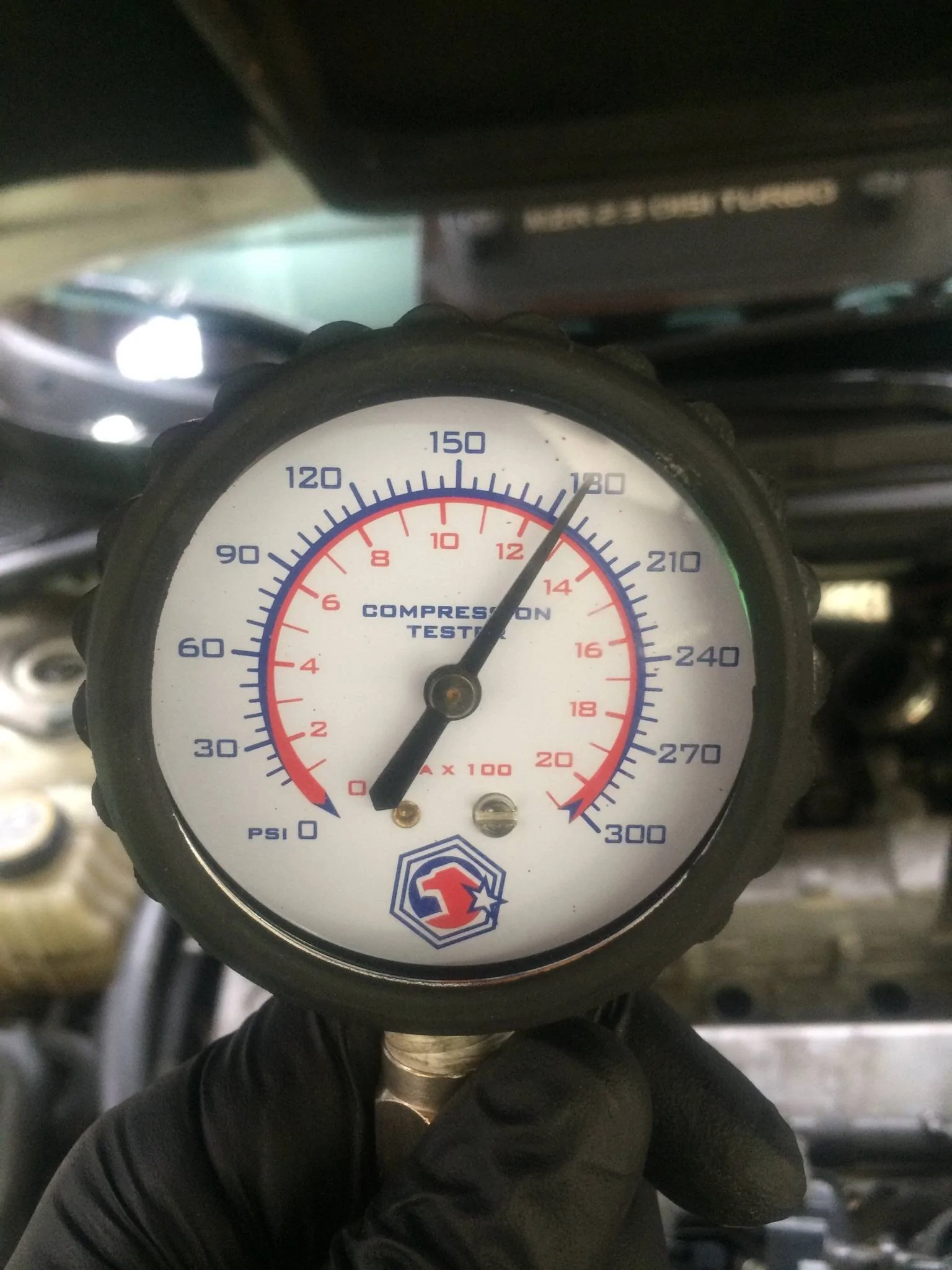

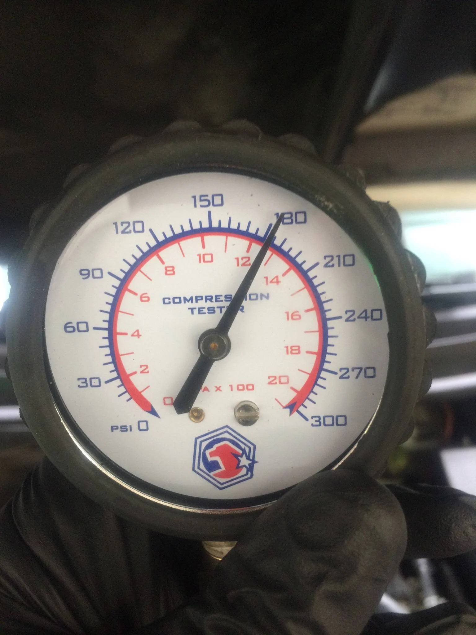

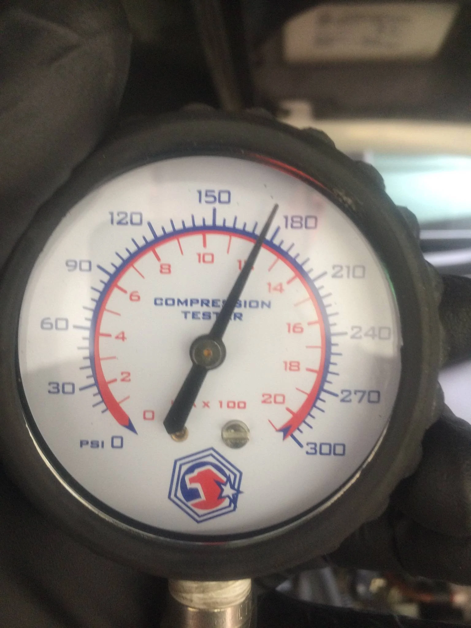

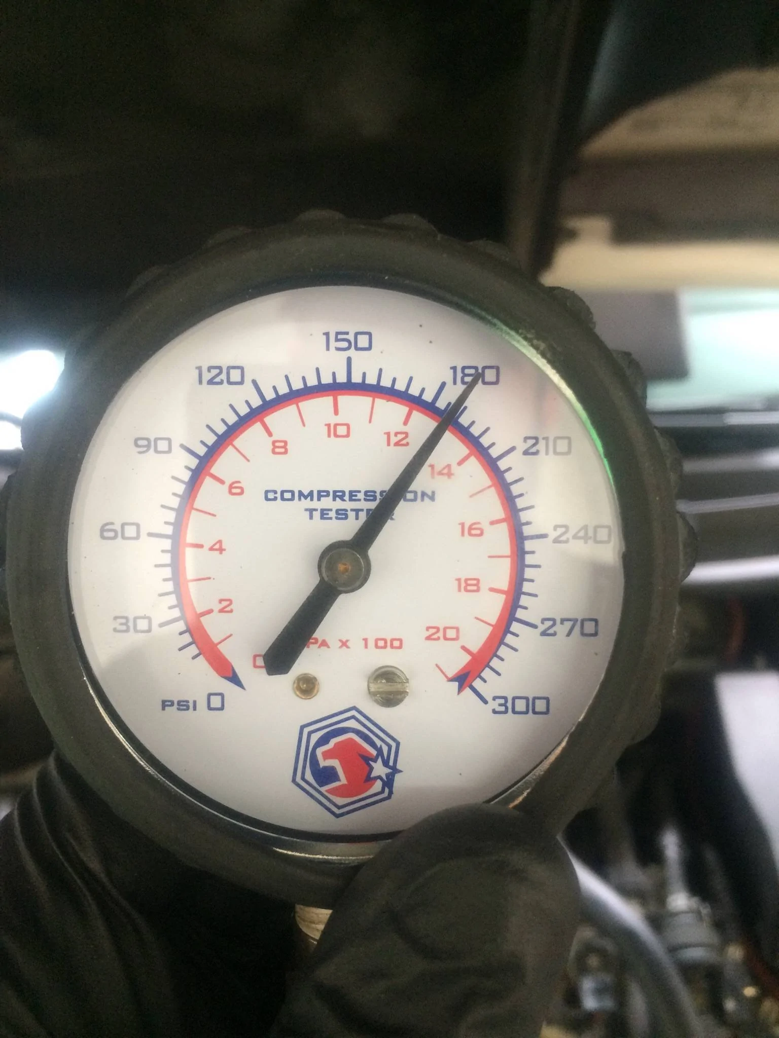

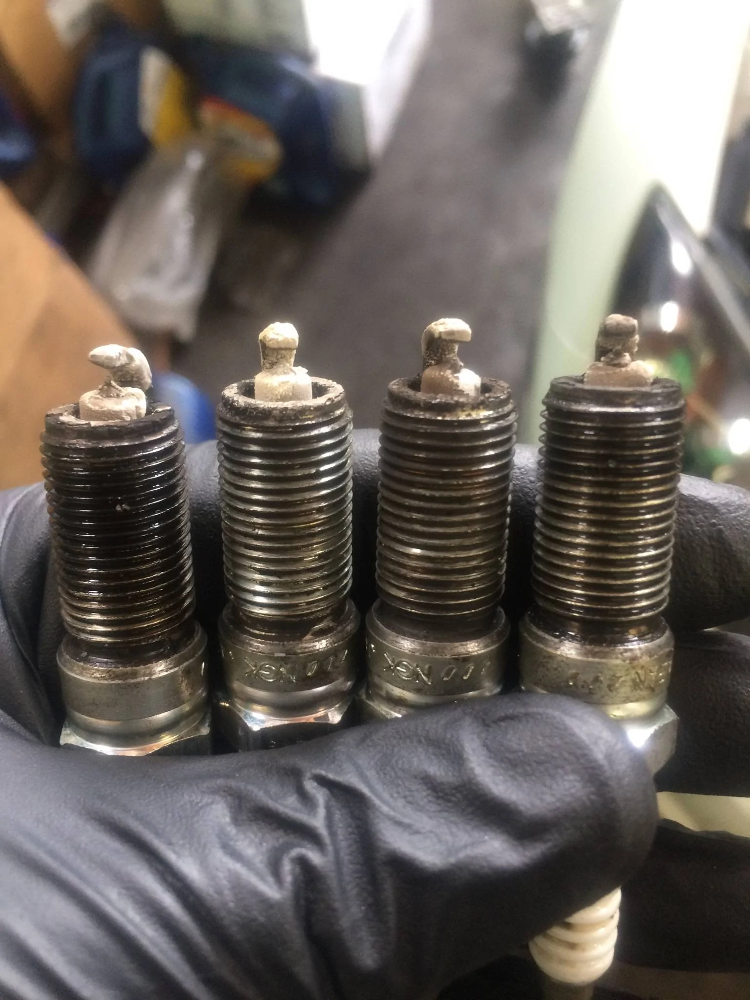

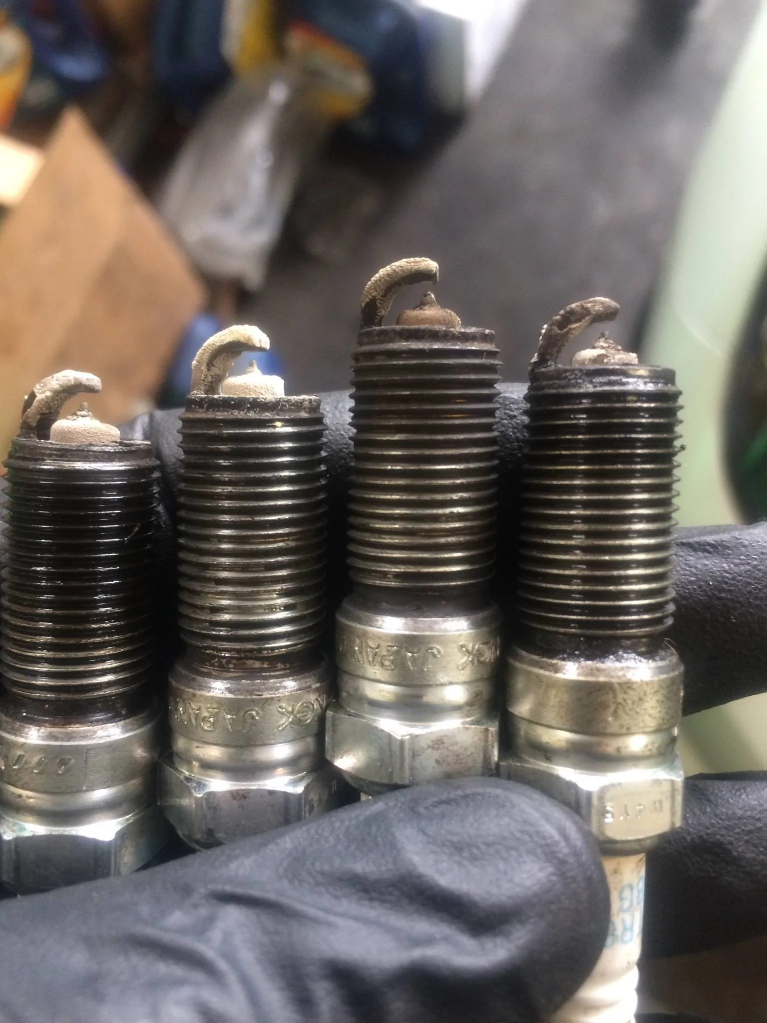

Below is an analysis taken on a high mileage turbo direct injection motor with carbon buildup. As cheap insurance, it is HIGHLY recommended to install a basic catch can kit and monitor carbon/oil deposits both on the intake/exhaust valves and the cylinder heads. If left unchecked, the deposits can accumulate on the oil control rings and lead to aggressive oil consumption, despite strong compression results. Increased oil residue can make it way down the turbo, 02 sensors and cats, and can cause further damage over time.
It's unknown as to what degree this will impact Honda's direct injection motors. Temps, valve timing, and oil/fuel quality all play a part. But it's worth mentioning here for those who are considering a mod path.
This motor: 164K with 12K on the plugs. Oil being consumed at 1QT every 200 miles. The 02 sensor (replaced 200-300 miles prior to the plugs being pulled) is believed to have partially contributed to a lean condition as higher quantities of oil were burned/passed along the sensor. Oil changed with OEM filter and Penzoil Conventional 5W-30 for 90% of its life.

Except that Maperformance did extensive research and determined that factory pcv system performs exceptionally well on the L15 and a catch can is not recommended
https://www.civicx.com/forum/thread...-system-catch-can-testing-observations.31076/
