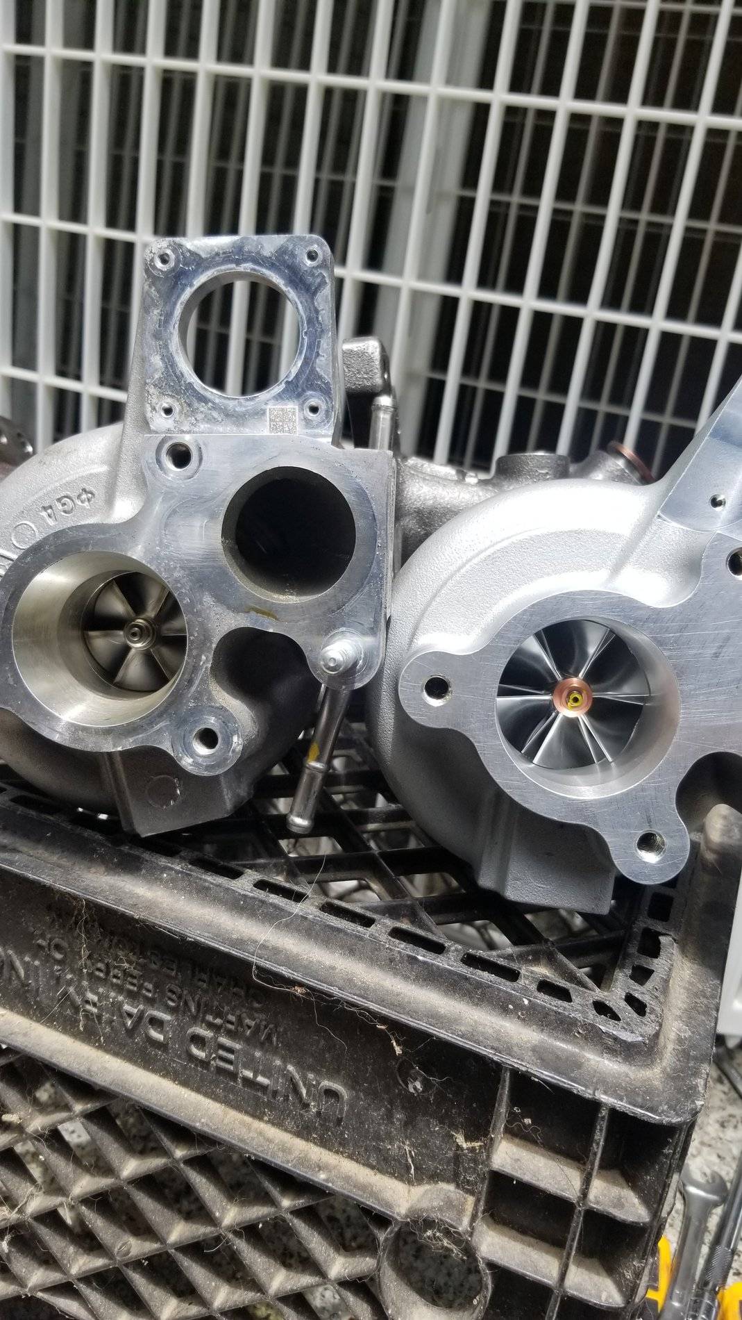

Hello all,
I am a cvt guy and just installed the 27 won turbo this past weekend. My initial comments... 27 won made a beautiful turbo. I will try to attach a comparison picture of the factory turbo and 27 won's turbo. I was a bit worried with how the installation would go. The instructions could not of been more clear! I did end up breaking a head off of a bolt in the engine block when installing the return oil feed. Luckily it only took about 15 mins to back the stud out.
Performance wise I can already tell a world of a different in the top in where the cvt shines! Pushes you back in the seat all the way to redline. I am waiting for my initial tune to come in. As of right now my installed mods are the 27 won turbo and prl intercooler with upgraded pipes. I am waiting for an intake with a race maf and my prl front pipe and downpipe. If anyone has questions I am willing to give in my 2 cents

Hello all,

I am waiting for my first tune to come out from my tuner. Right now I am using ktuner just a base map nothing specific for the 27 won. I emailed ktuner support and they said you can run any ktune base map with the 27 won. They do advise no long wot pulls. Previously I ran ktuner all the way maxed on all quick adjustments with a bbg. Now i am running bbg 1st gear 16psi and mild ramps and spool rates and cant forget to always check that early spool especially since the new turbo takes about an extra 500rpms to spool. The

The bolt that was removed had an odd 10 marking on it. Not like the graded 10.5 ect but it was a soft breakage rather than a hard snap like you would get from a graded fastener. Not sure if the heat from the block weakened the bolt
I highly recommend that BBG be tapered (Low to High). In the LOW range of any type of transmission is where the hard stress is present. Although we have not seen a compressor map for the W1, you probably wouldn't wish to go beyond 17-18psi with a CVT and will definitely need 93Oct or higher to run as smooth as possible. You won’t achieve 16psi in 1st as you will be well out of 2nd before that charge reaches it’s peak.
The DP will help keep your torque lower initially down low and The WG will need to somehow be managed precisely to keep you from spiking.
Don’t forget a “catch can” most definitely....
