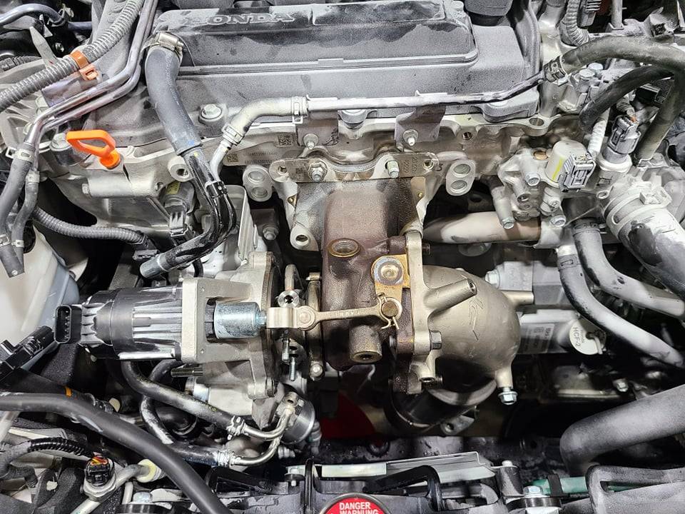

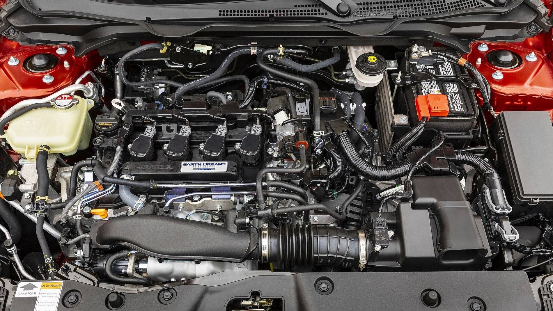

At first glance, there are a few obvious differences in the engine bay. There is a notable increase in space between the radiator, fans and downpipe. – We suspect that this added space may be an effort to reduce engine bay and intake air temperatures.

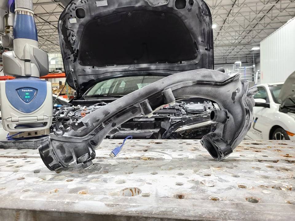

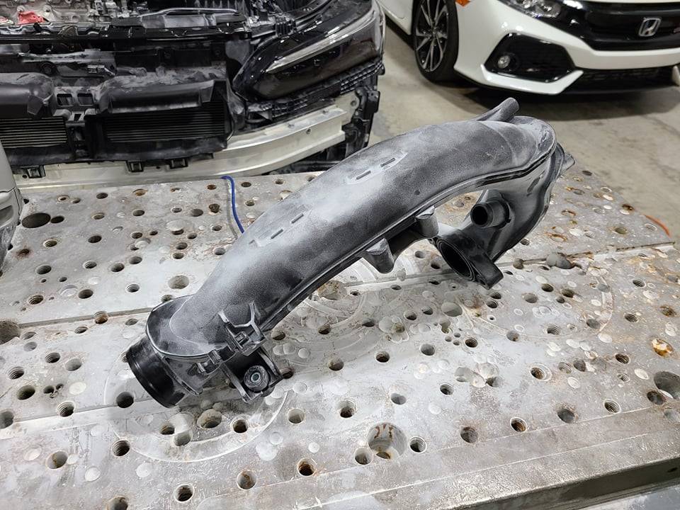

The entire intake system is vastly different from the 10th Gen. From the turbocharger inlet pipe, to the bypass valve (which are both very reminiscent of the 10th Gen 1.5T Accord), the inlet hose, the MAF sensor orientation, the air box, and air duct. After looking into the intake system and air duct routing further, we can see that the 11th Gen utilizes rather efficient intake ducting, unlike the previous generation. For this reason we will be looking into continuing our High Volume Intake Air Box line that utilizes factory ducting.

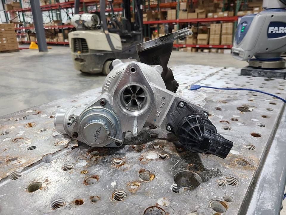

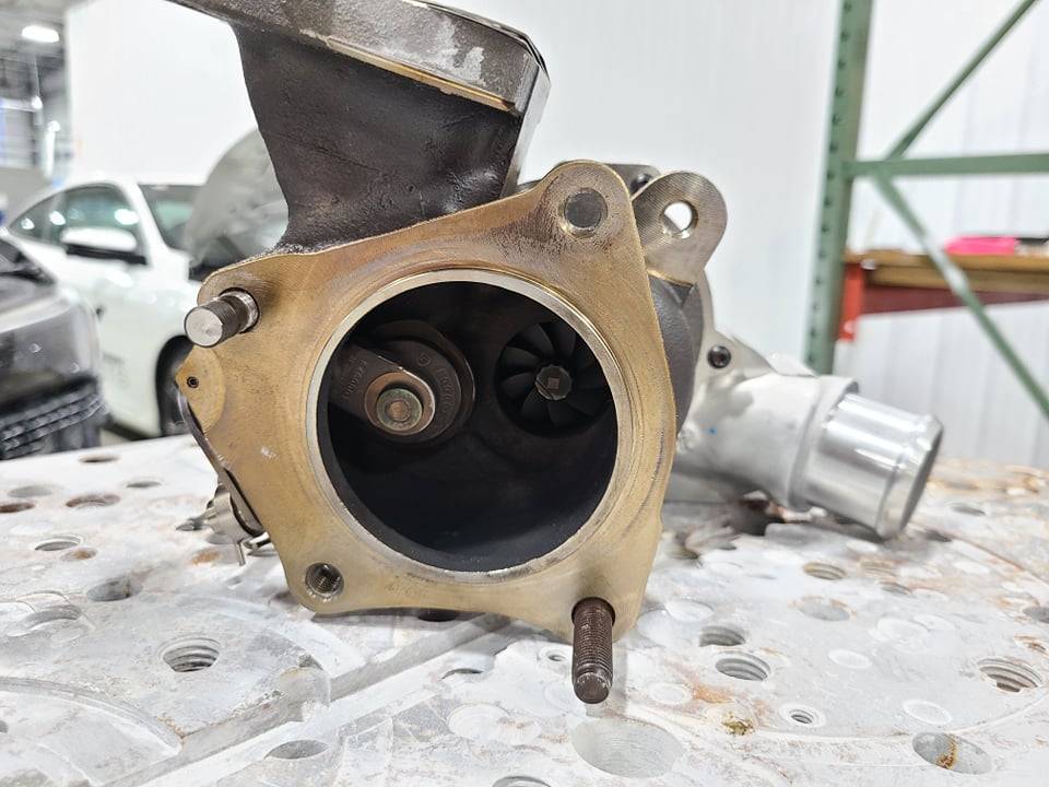

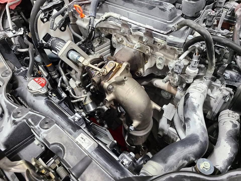

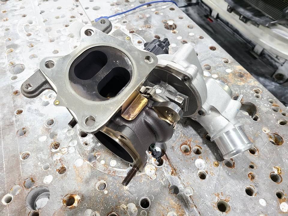

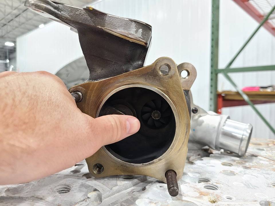

We can also see that the turbocharger is different in terms of compressor outlet routing and the fact Honda didn’t locate the BPV into the turbocharger inlet pipe. However, there are quite a few differences that aren’t so obvious to the naked eye. Honda implemented a new part number for this platform and which has been seen described as a high-efficiency turbocharger.

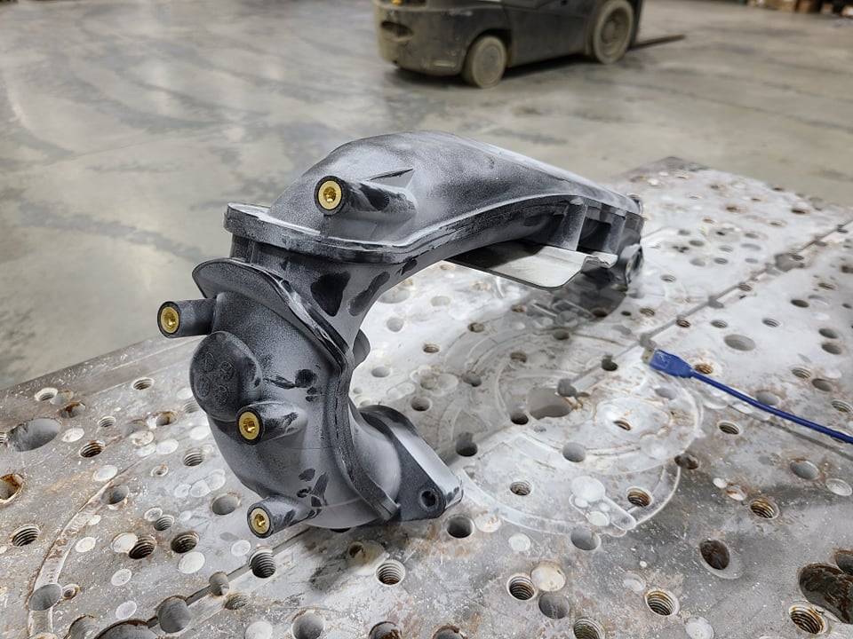

As with the turbocharger, Honda has changed the cylinder head to a dual port design to suit, whereas the 10th Gen used a single port. This “new” head utilizes a different valvetrain and gets VTEC on the exhaust cam now. These changes helped increase response, fuel economy and bumped Honda’s base rated power about 6 horsepower and 15 lf/lb of torque more. We use the term “new” loosely, as the 11th Gen shares the same cylinder head and camshafts as the 10th Gen Accord. Talking with James from Ktuner and Derek from Innovative MotorWorks, 10th Gen 1.5T Accords make a bit more power than the 10th Gen Civic and shows all signs of having more power potential. The community can expect the 11th Gen Civic to outperform its little brother.
Downpipe, front pipe and exhaust system fitment has changed from the previous generation. No worries, though, we’ve already got the downpipe and front pipe part covered!

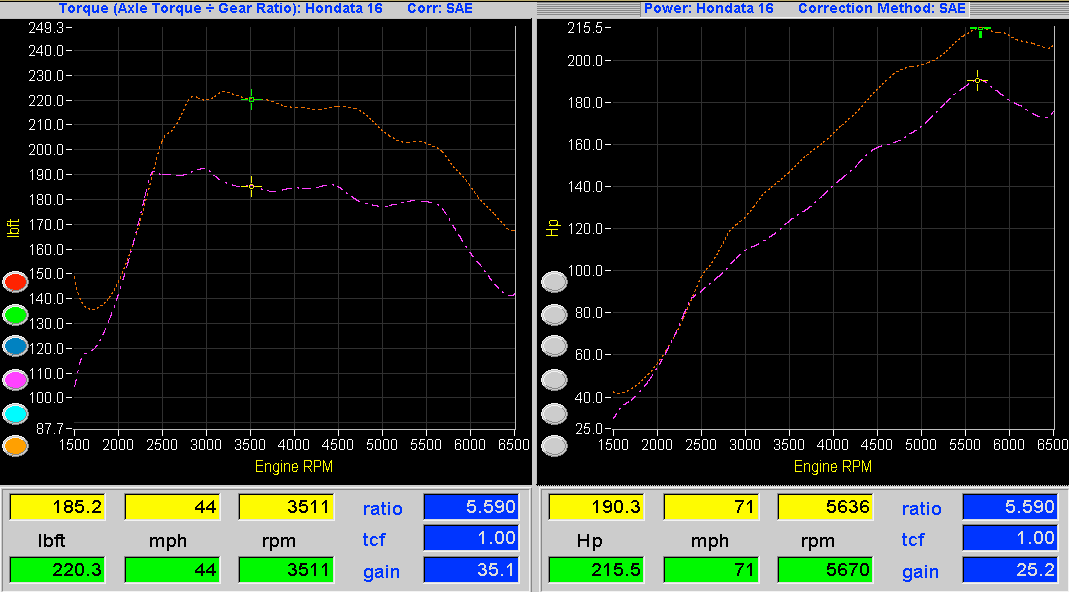

They both were perplexed with the super slow times. Sure the car is the equal to having a passenger in the car heavier than the last gen, but with the supposed power increase that shouldn't take a mid to high 6 second car to a 7.5 to nearly 8 second car. There's obviously more to it than that. And I think Hondata's testing is a great place to look. They use the same dyno (Church's Dynapack) for all their runs.
Back in 2016 their bone stock Touring dyno'd at: 190 hp / 185 tq:

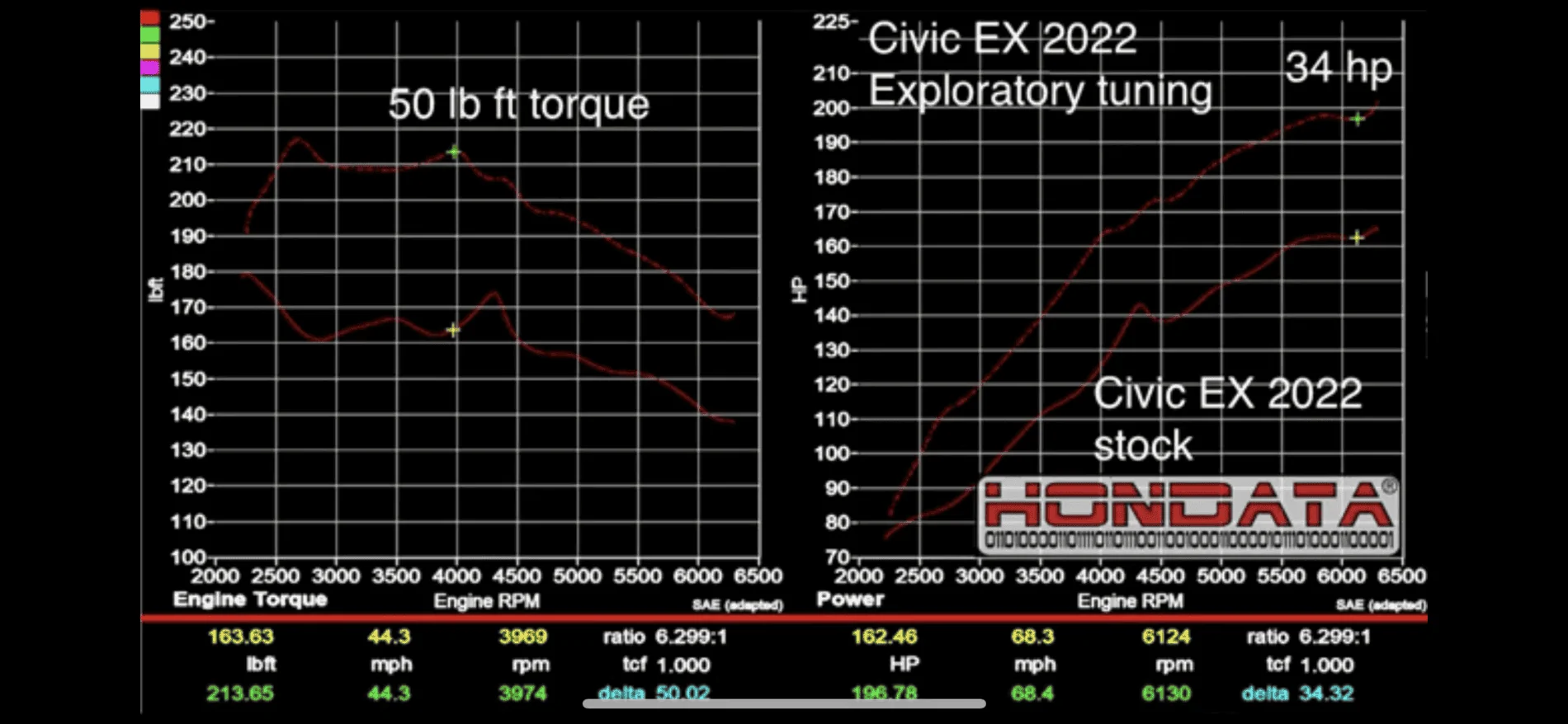

Their 2022 EX dyno'd at: 162 hp / 163 tq:
Clearly, Honda seems to have done some sort of detune to keep reliability and mpg numbers higher.
On the other hand, maybe what PRL is saying is that the 11th gen's 1.5 ultimately has more headroom to create more power than the 10th with the right parts/tune. Hopefully, PRL will publish their dyno results on a stock 2022 as well.

Our 2016 1.5T Touring (CVT) baselined at 183 hp https://tiremeetsroad.com/2017/05/0...ipe-front-pipe-combo-adds-10-hp-and-14-lb-ft/, while Honda rates these at 174 hp.
Our 2022 1.5T Touring (CVT) baselined at 169 hp http://prlarmy.com/Blog/2022-honda-civic-1-5t-silicone-hose-upgrade-release-dyno/, while Honda rates these at 180 hp.
It's worth noting the 2022 Civic ECU targets less boost than the 2018+ 1.5T Accord ECU for whatever reason. Could this be the reason for the power difference? Unfortunately we weren't able to log any type of data during our initial dyno runs. There may be some sort of background table or algorithm affecting power output as well - maybe not. We will find out more information regarding this shortly. Judging from previous data and Honda's factory output ratings (however you want to take that), we see the 11th Gen platform having a bit more headroom than the 10th Gen.

So this kind of confirms it. Where the 2016 power was underrated by Honda, the 2022 stock power seems to be overstated at bit and certainly reduced from the 10th gen.
Your numbers, Hondata's numbers and all the road testing pretty much show that.
