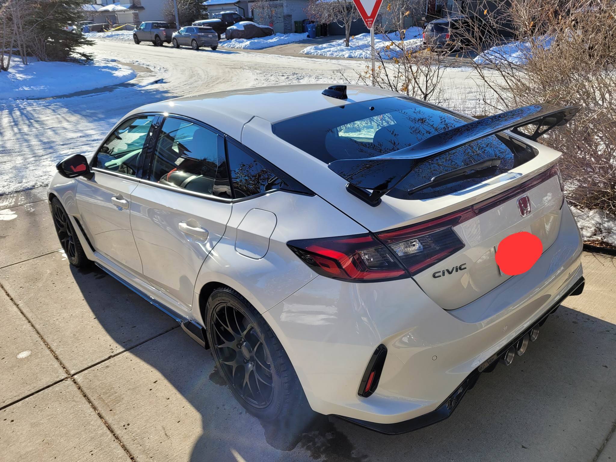

Due to short notice on my pickup date I had to source a cheap set locally. I ended up getting some knockoff wheels and Khumo wintercraft WP72 tires
18x8 +35 5x120 RAC wheel R01
245/40/18 Khumo Wintercraft WP72
This setup cost me only $2300CDN and since I dont winter the car I didnt feel the need to spend any more money.
The fitment turned out really good with this setup and couldnt be happier!
