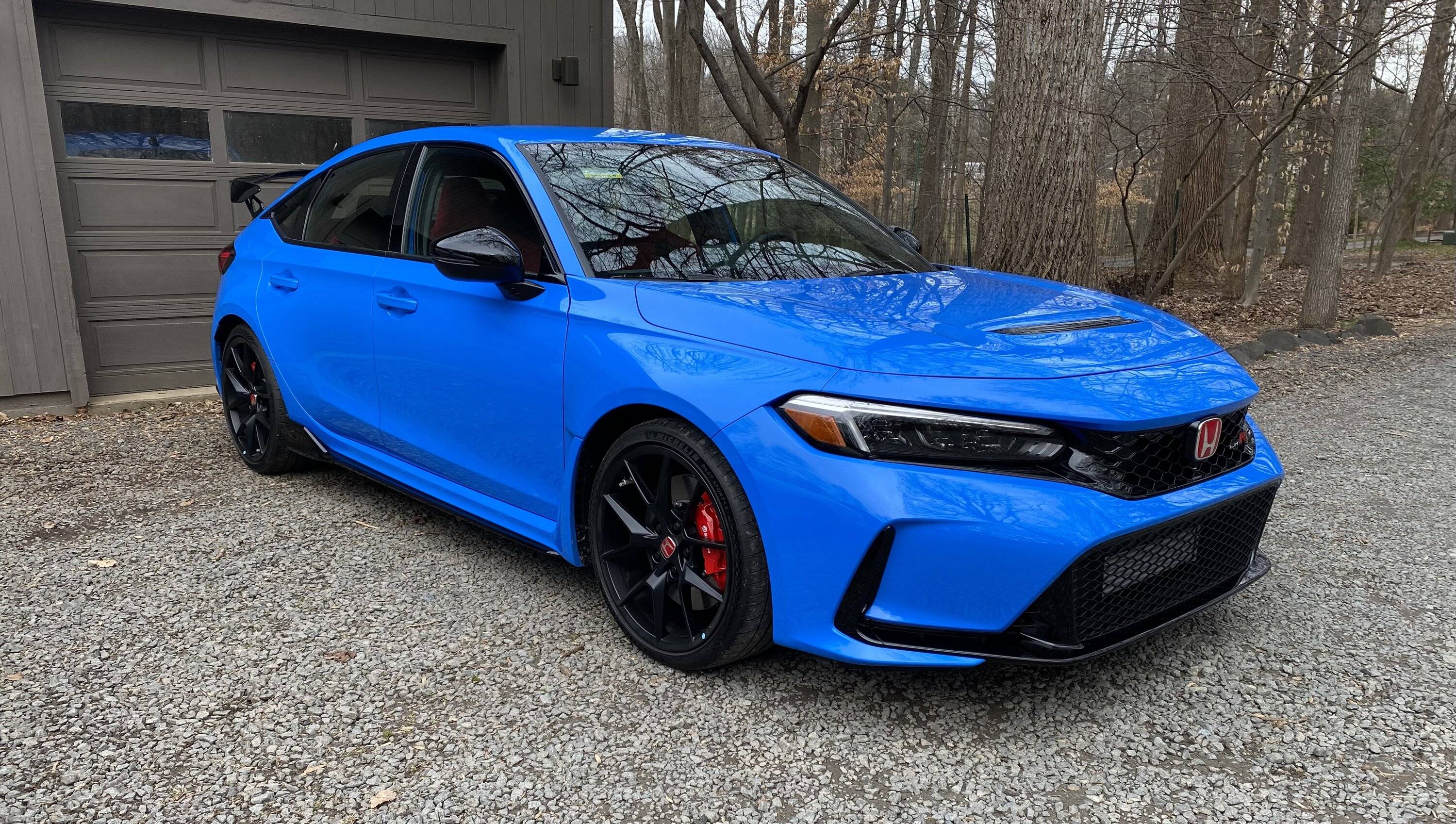

This won’t be much of a build thread as my plan is to keep the car mostly stock. Mainly wanted to start a thread to keep track of any little things I do to it and keep some notes about the car.

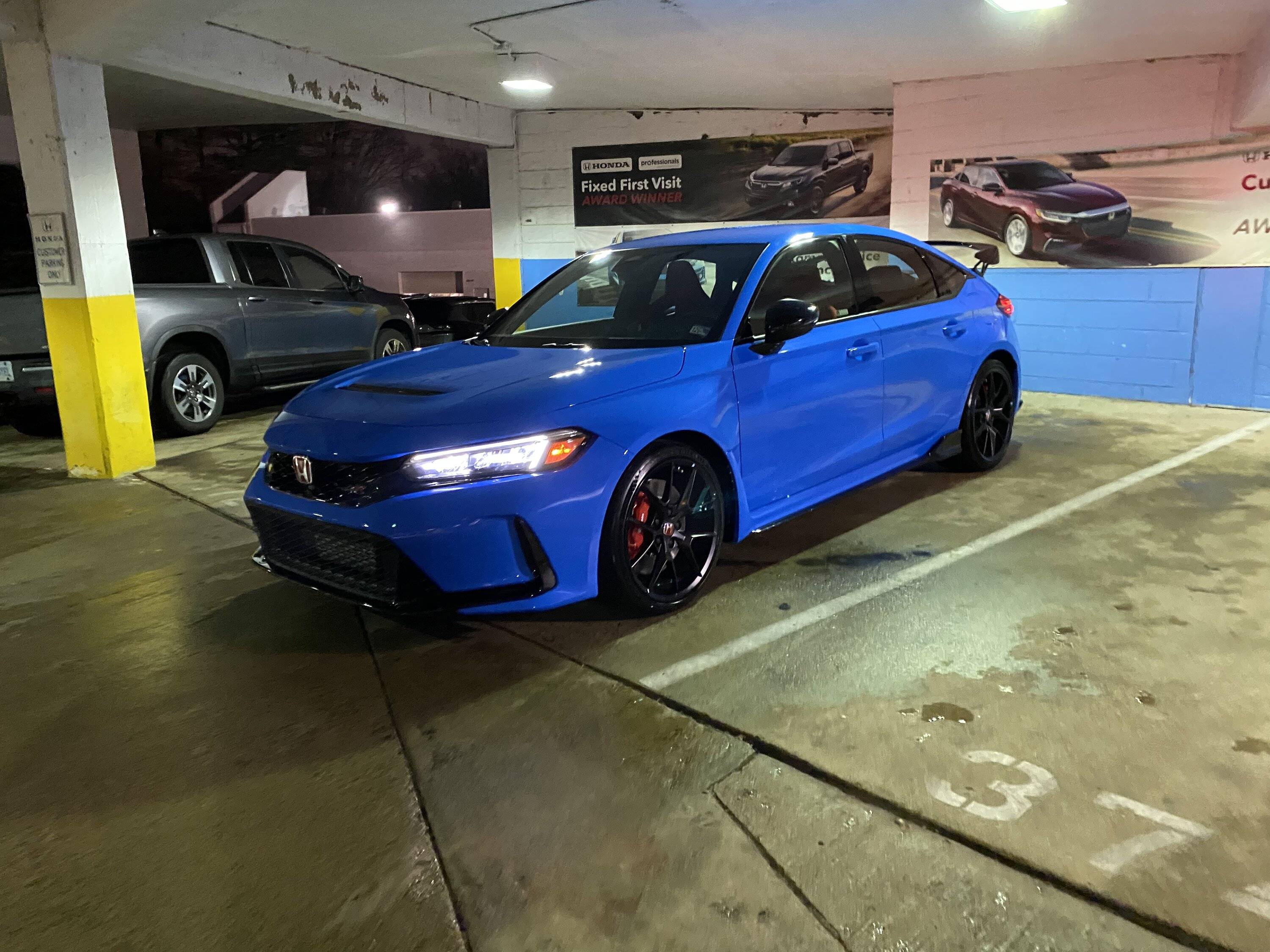

Here it is the night I picked it up from the dealer.

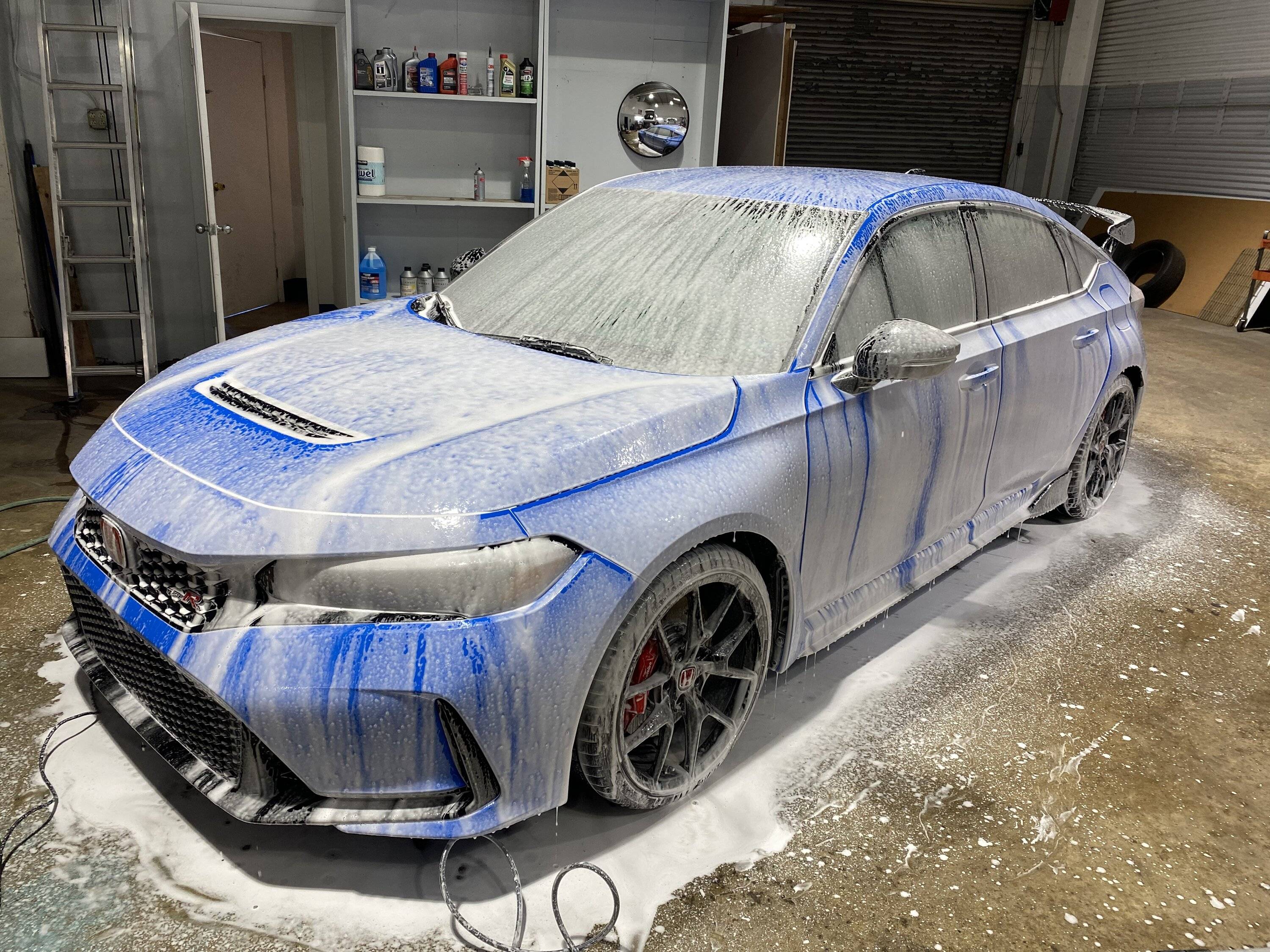

After a month of ownership I finally broke down and bought a car washing starter kit from Chemical Guys. Foam cannon is fun but I still hate washing cars. Here it is during and after the wash.

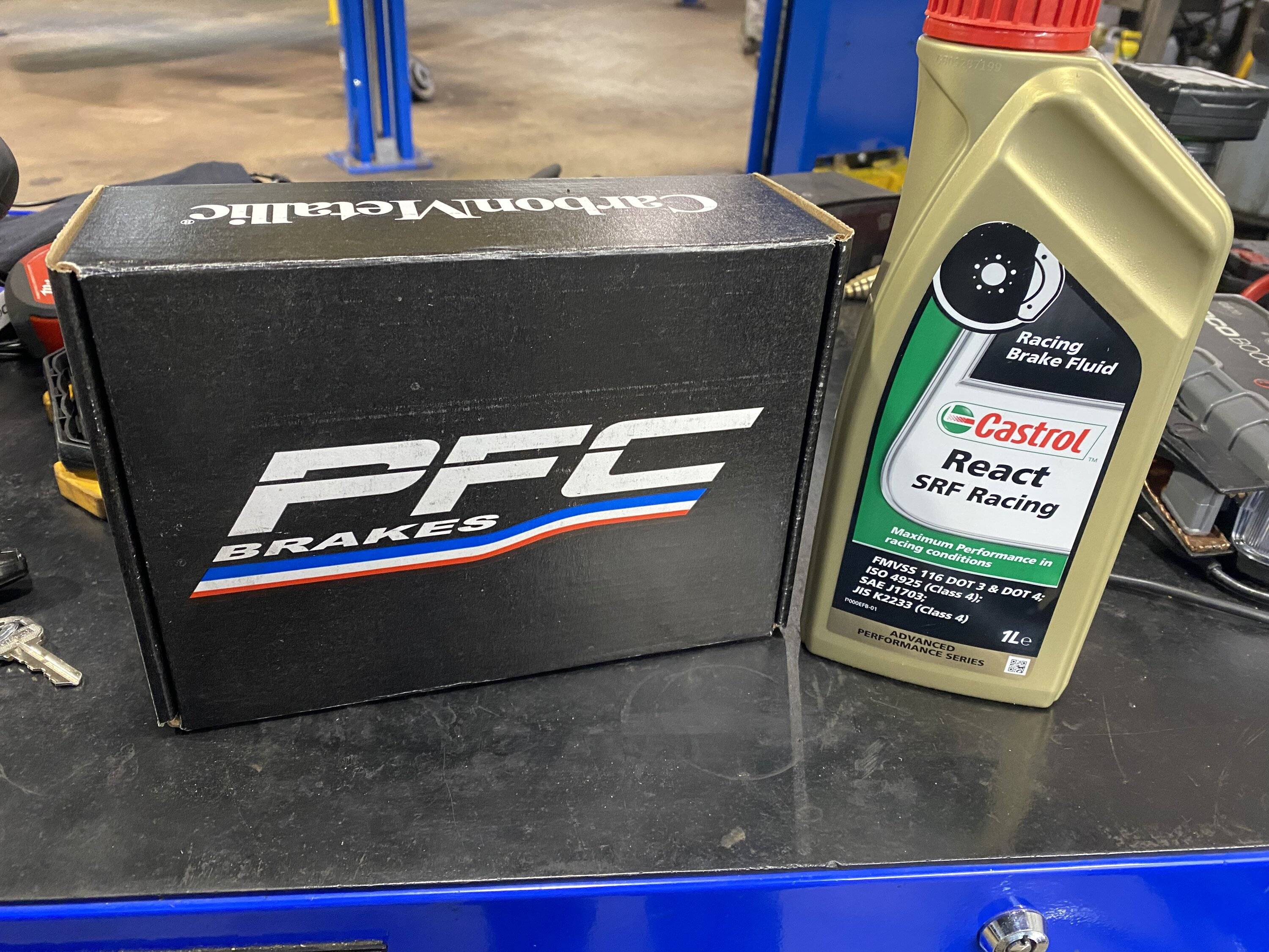

Some small work to get done before a track day weekend coming up in early March. Going to change the oil, swap out the front pads for a set of Performance Friction 08 pads, flush the brake fluid with Castrol SRF, remove the front strut pins for more negative camber, and then align it. Then just hope and pray that the weather is warm enough in March to drive on the factory Michelins. Excited to see how the car performs on track.

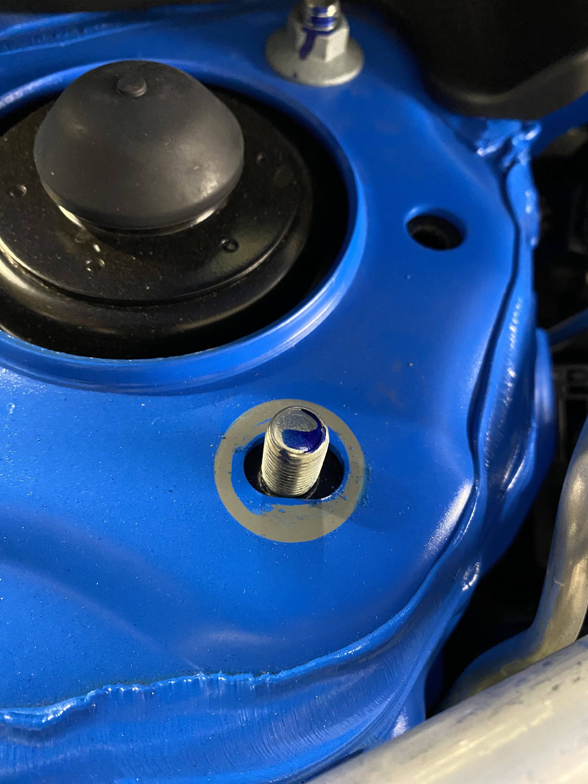

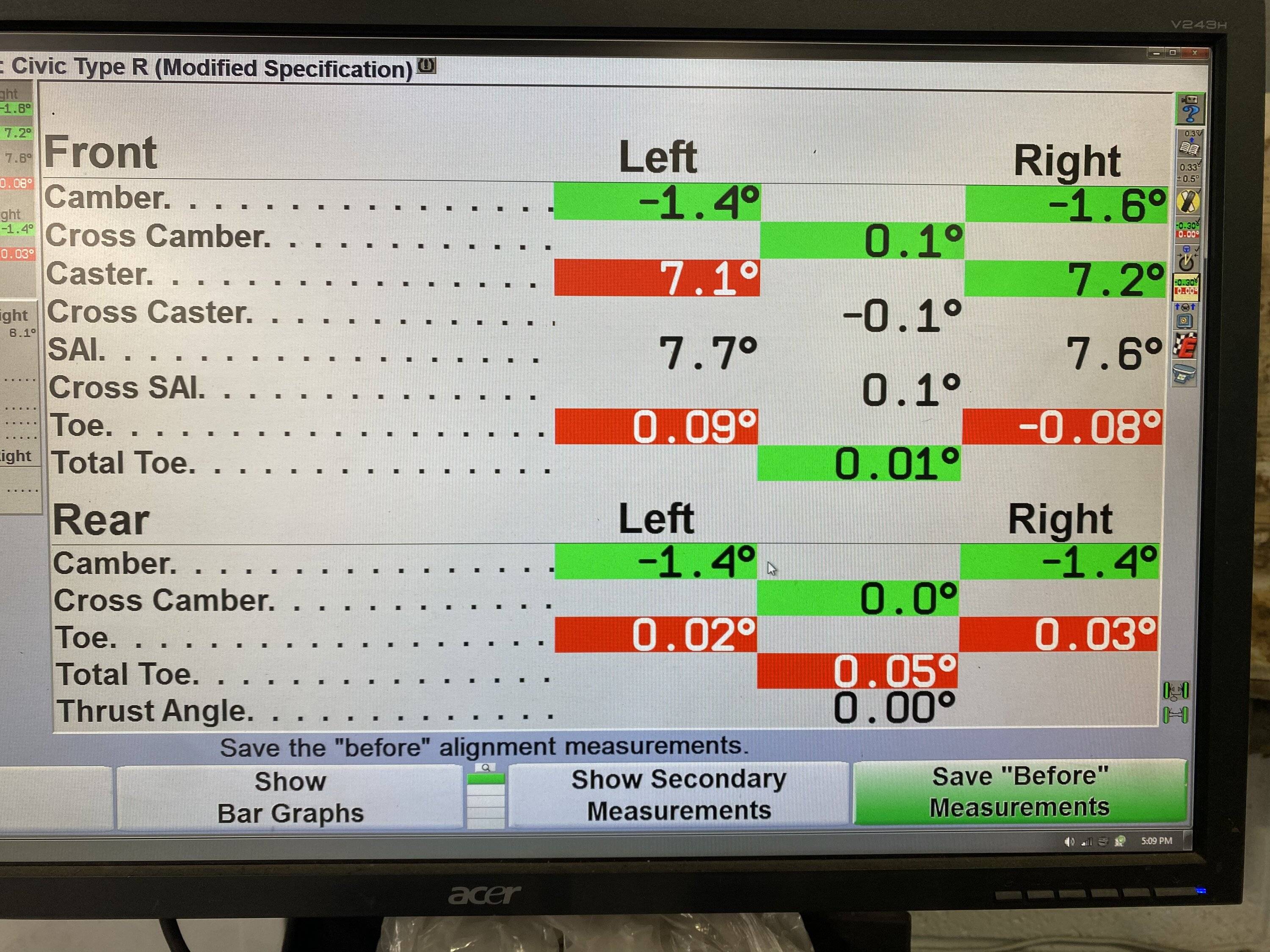

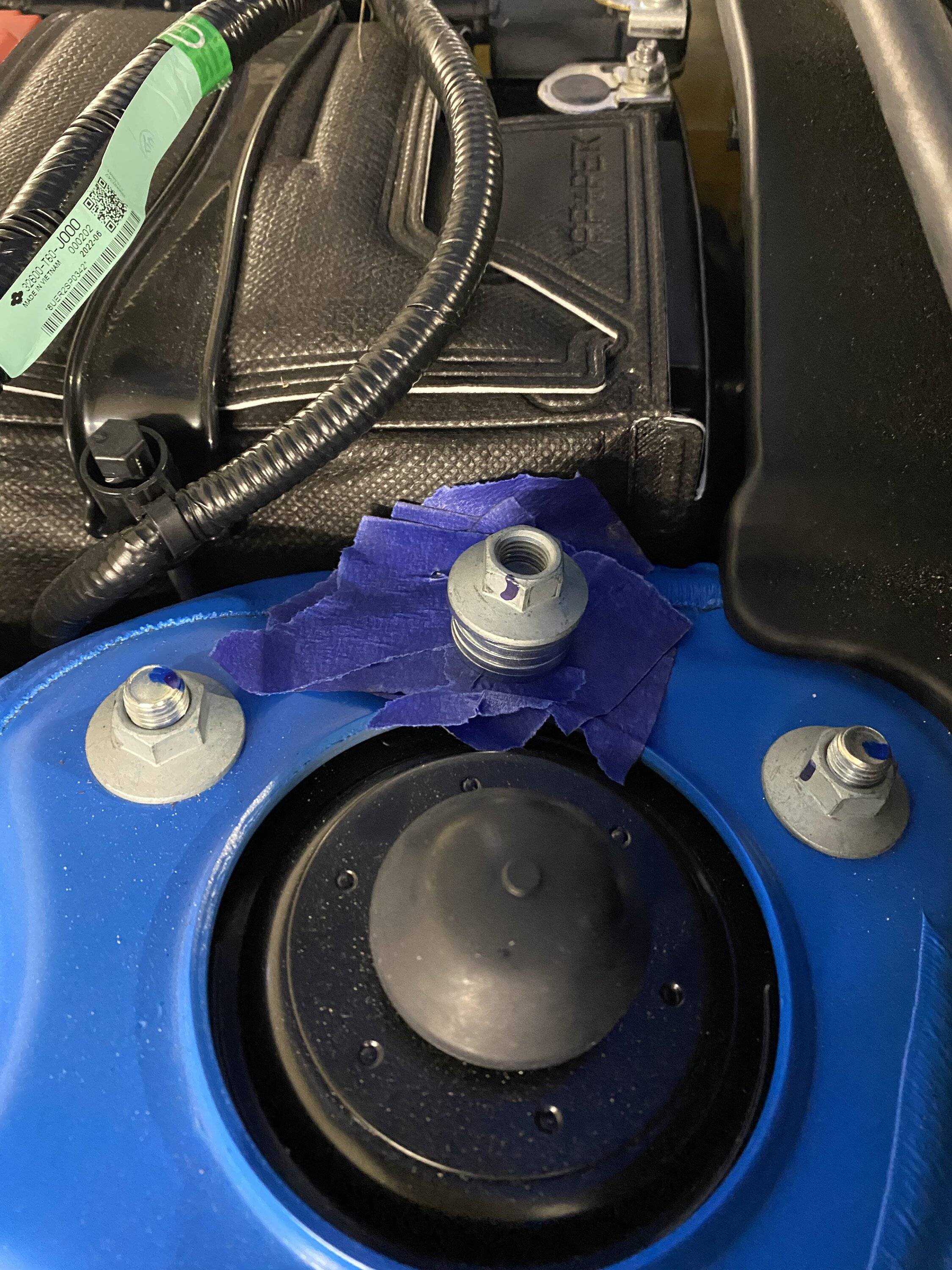

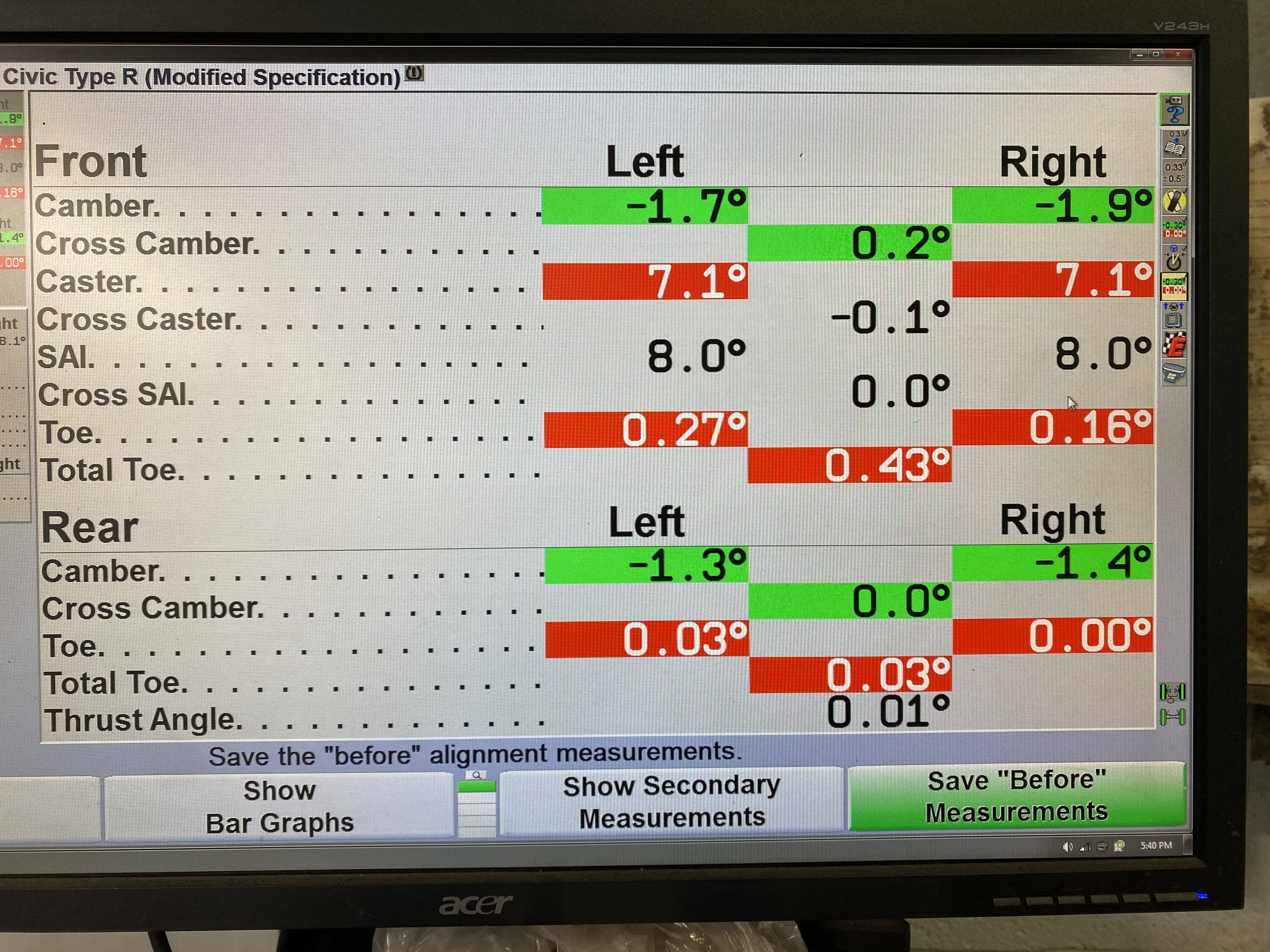

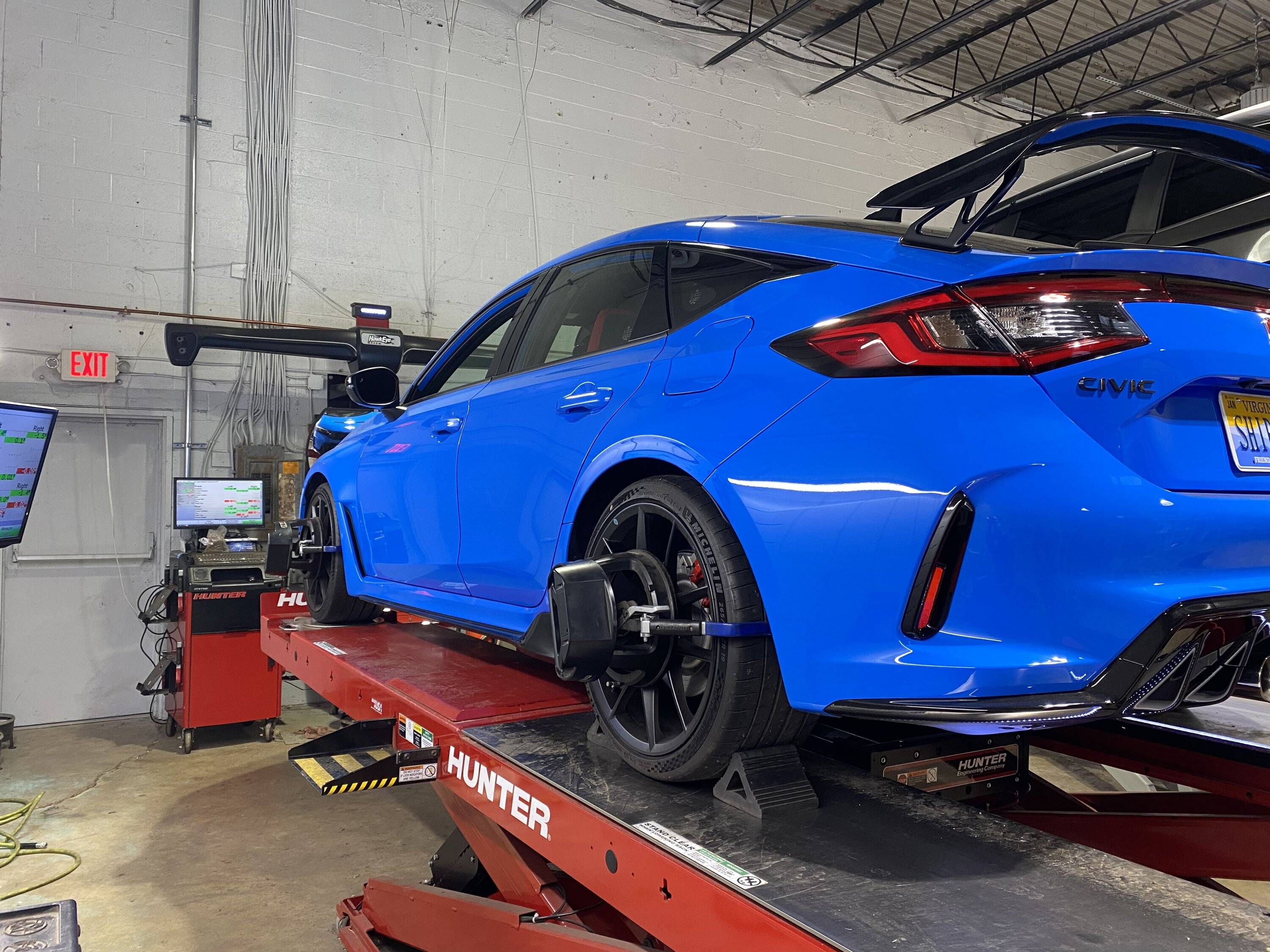

Got the alignment done tonight. Removing the pins for the front struts was pretty easy. Took camber readings before and after. Removing the pins gained -0.3 degrees of camber. Not a ton and unlikely to noticeably change how it handles but hopefully it will help with tire wear on track. Note- it did change the front toe a lot so if you plan on doing this you will need to check the toe.
Here she is on the alignment rack
Alignment numbers before doing any work.
Getting the strut pins out. Put some painters tape down to keep from scratching the paint with the washers.
Here is a pic showing how much room there is to move the strut. I’ll need to get some touch up paint to cover where the nuts were.
Alignment numbers after moving the front struts.
And finally the completed alignment numbers. (Caster is now green because I changed the specs at the end to make it green. Didn’t actually change anything on the car)

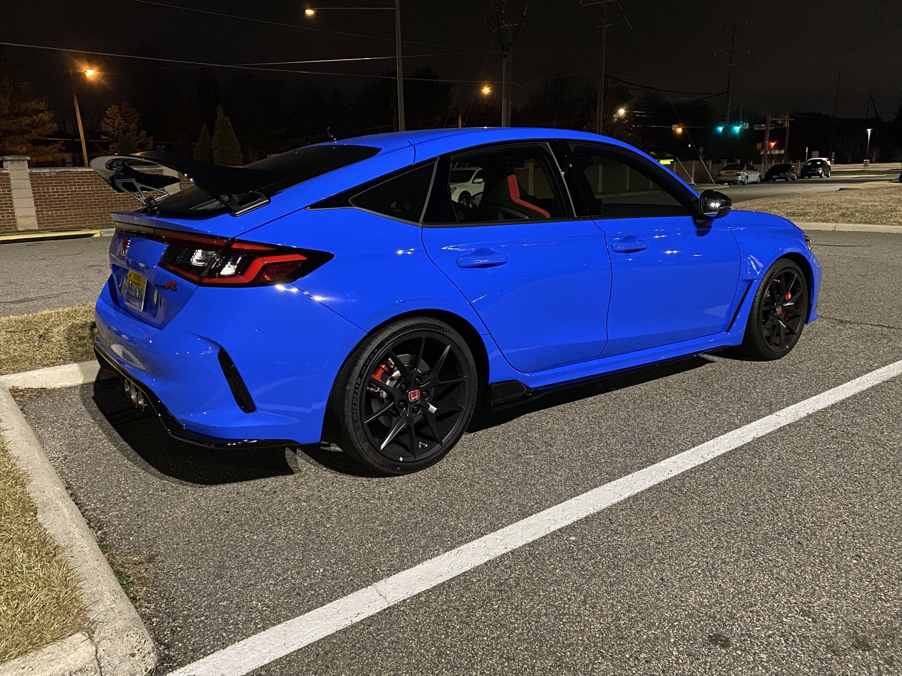

Shameless parking lot pic at dinner afterwards

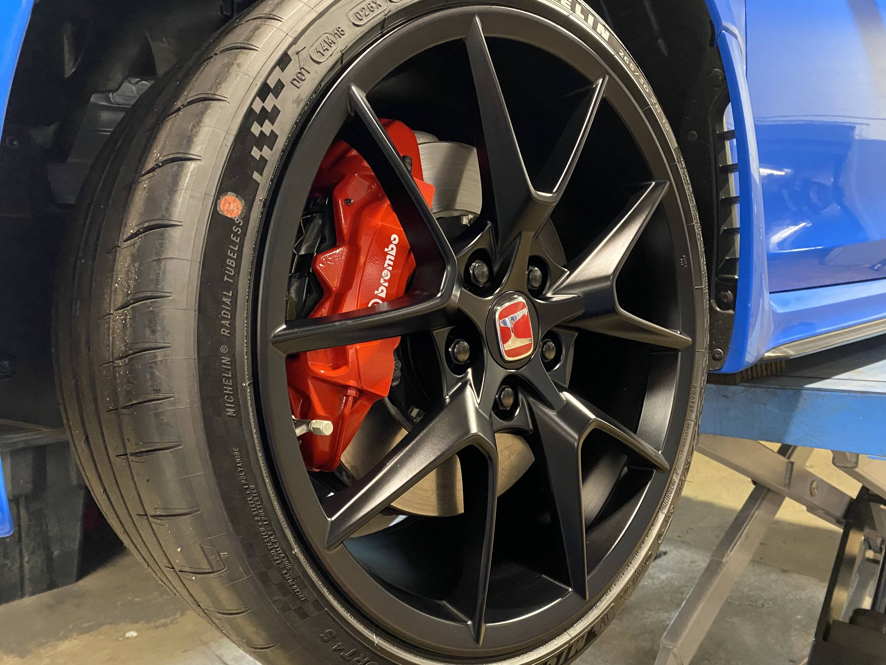

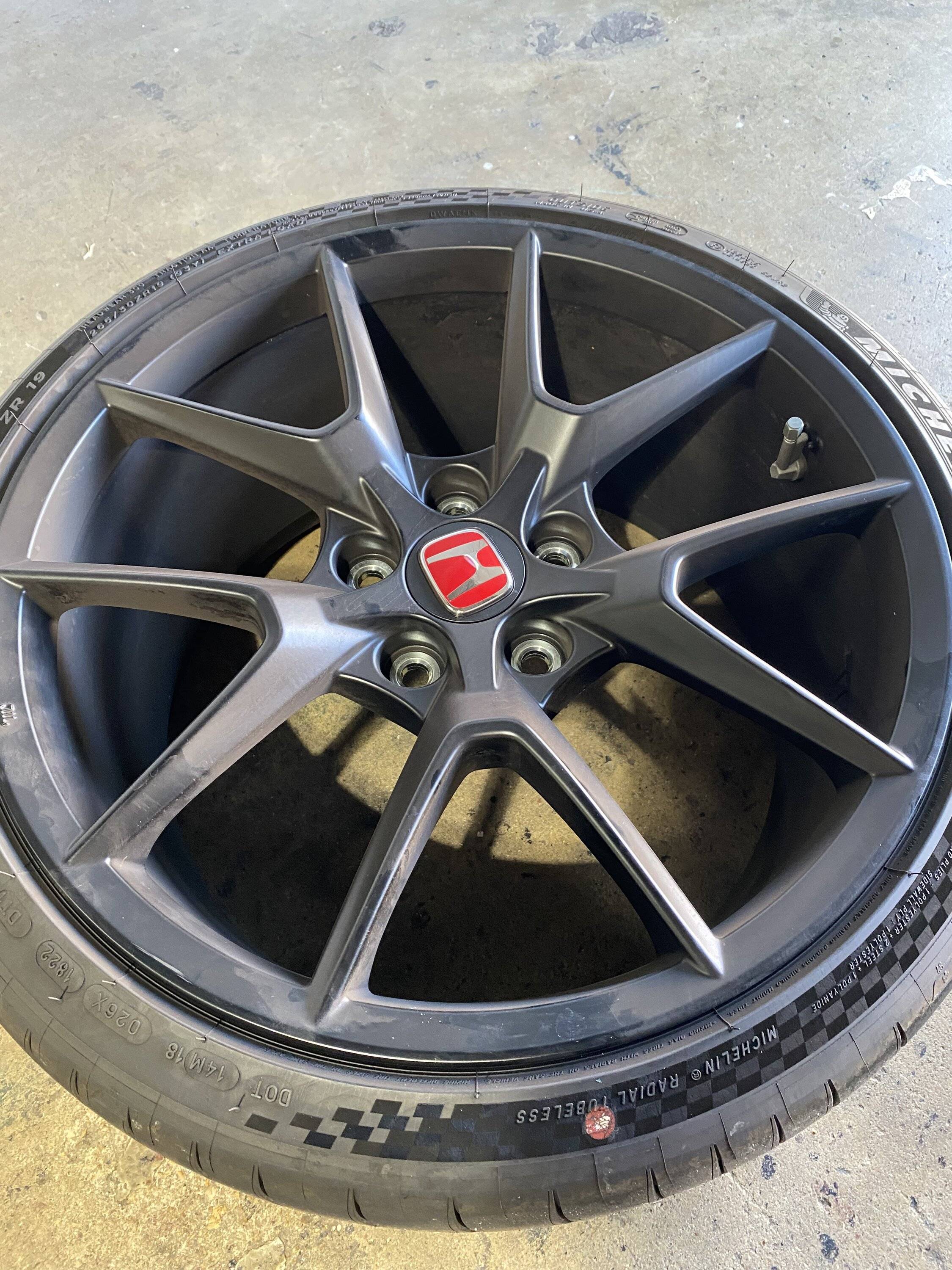

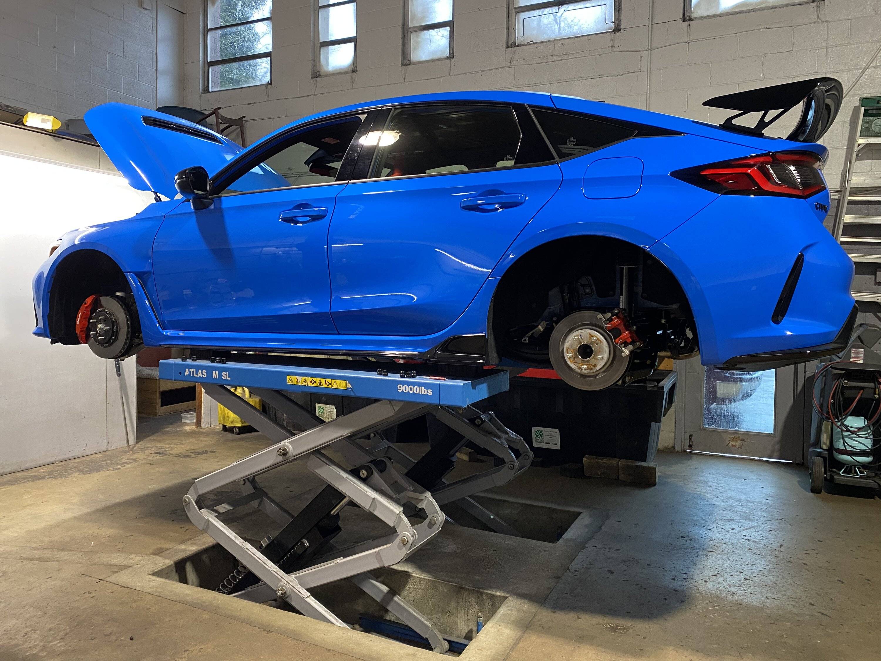

Solid weekend of playing with the car. Nice weather yesterday so got to take it out for a blast. Then to the shop to get some track day prep done. Started with washing the wheels. Then came back today to ceramic coat the wheels and the Brembos. Got the front pads swapped out and the brake fluid flushed. 3 weekends until the track day where I’ll really get to see what this car is all about.
Dirty wheels
Cleaned and ceramic coated wheels and calipers
Lastly getting the brake work done

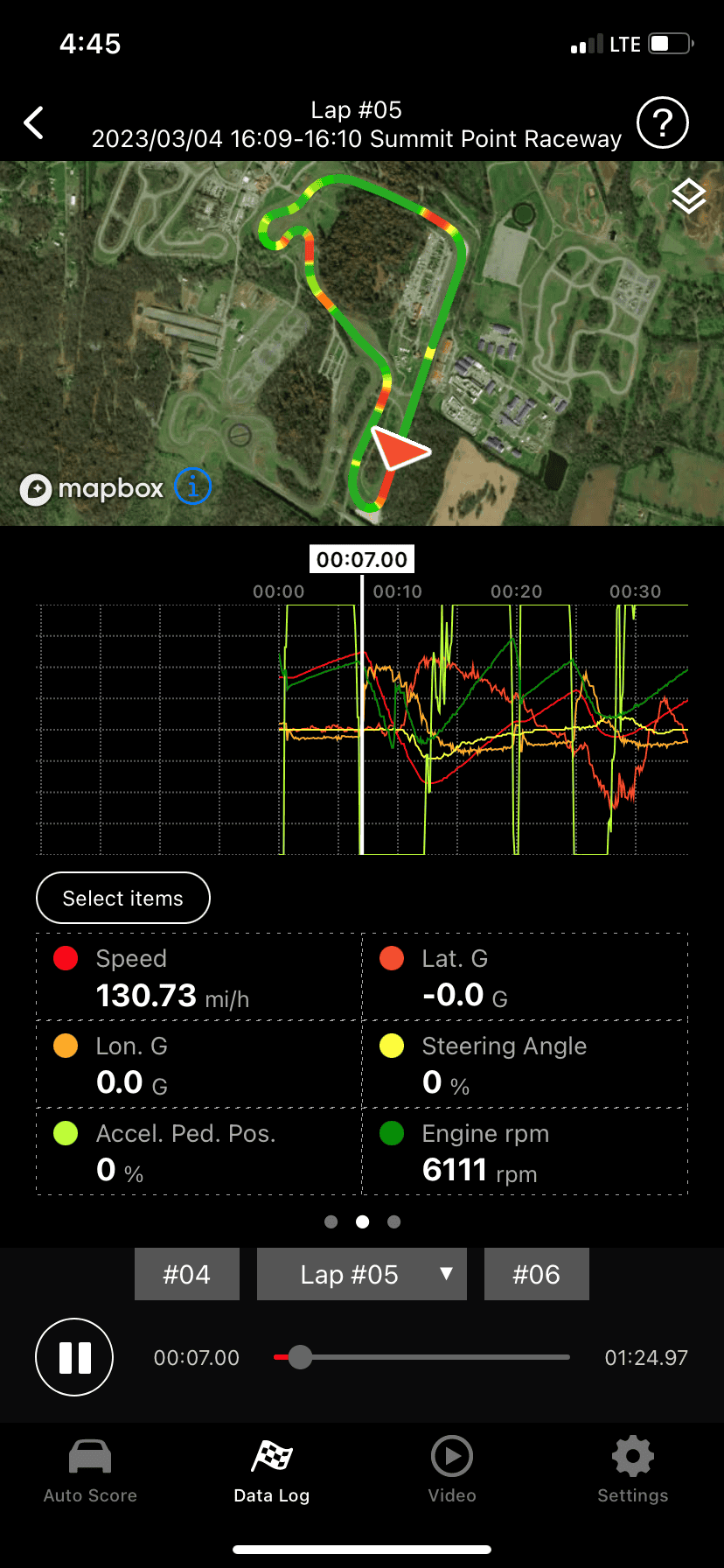

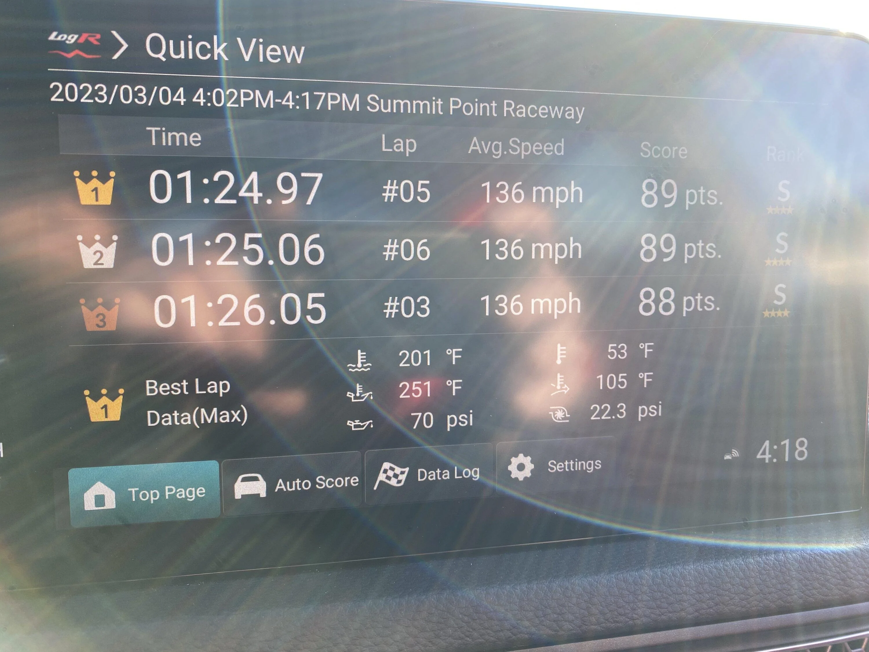

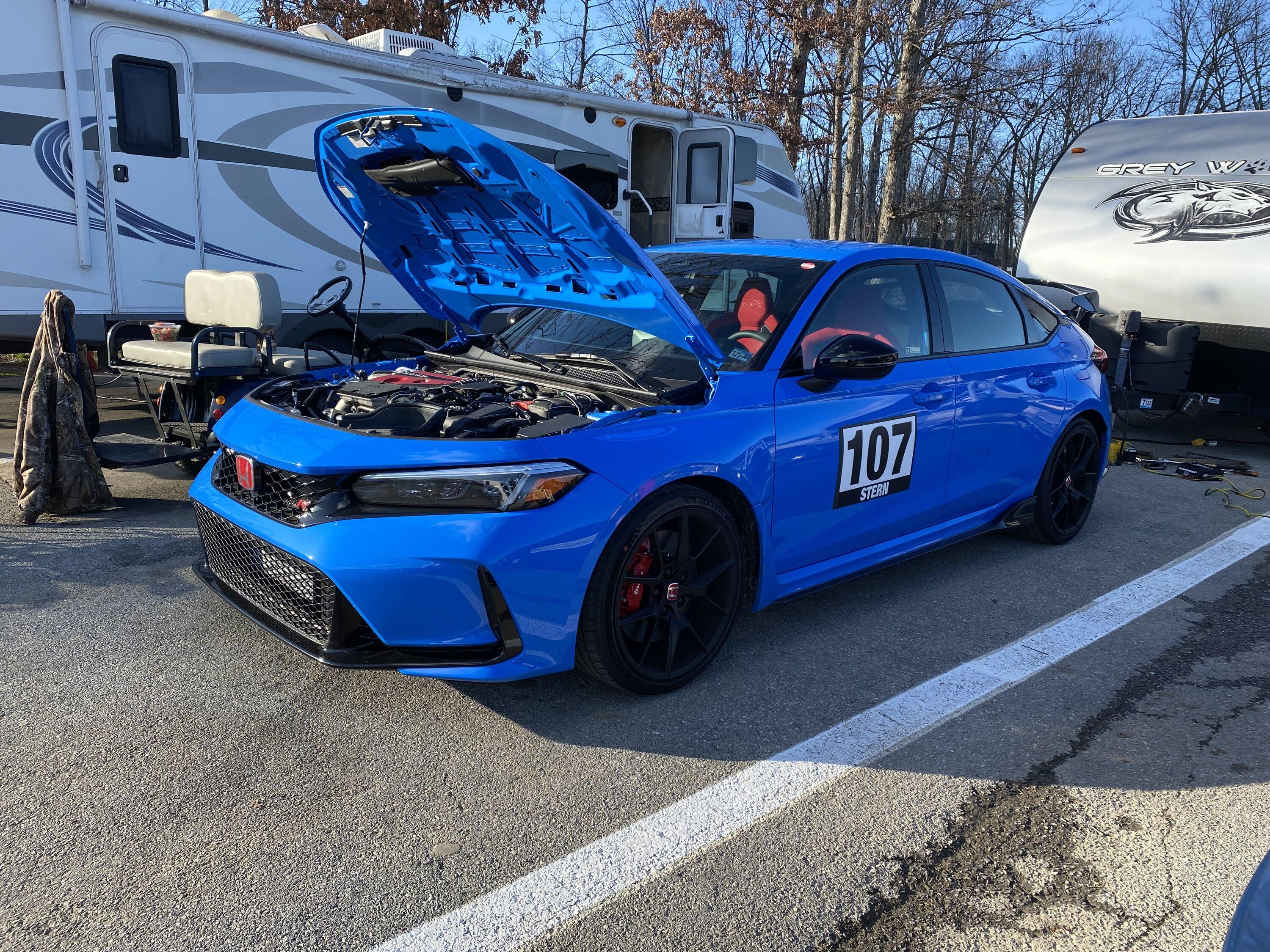

First track day in the Type R is done. Holy shit this car is fun. I think I’d have to agree with the reviews I saw before buying it that unless you’re on a perfectly smooth track the +R mode is too stiff. Ran my best lap time in Individual mode but without being able to turn VSA off there is still some more time to be had. The VSA kept it from rotating in the slow speed turns and really forced me to slow up corner entry.
I did have some braking issues. The PFC pads that I put on it were causing a pretty bad vibration so I went back to the OEM pads. With both sets of pads I keep getting the yellow Brake System warning light coming on. Unsure what’s causing that but it seems to stop fine.

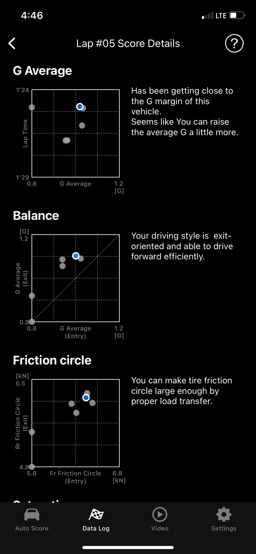

I was able to get the LogR to work and it’s very cool. Seeing lap times as you start cross finish is nice and the extra data available on the app later is fun to study.
