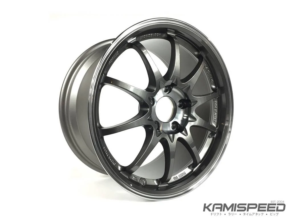

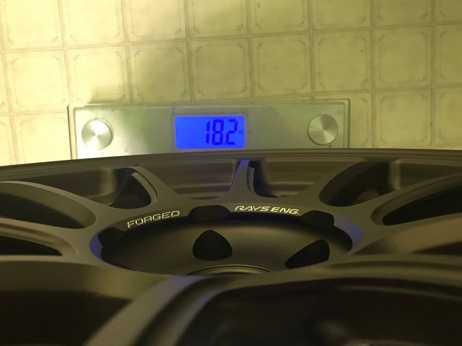

The lightest Volk wheel without fender work will be the CE28SL in 18x9 +48 5x120. I do not have the exact weight on that wheel but I have the weight of 18x8.5 +45 5x100 at 17 lbs and 18x9.5 +22 5x114.3 at 17.95 lbs, so from that the 18x9 +48 should be right under 17.5 lbs.
For comparison Volk Racing TE37 SAGA are 18.2 in the same size.
18x9 +48 (18mm more poke than OEM) - Face 2 no fender roll will be required

Ok, thanks all for the information. I like the CE28SL design and also the graphite color, maybe it would be a better match with my blue CTR than the black of the original wheels. Does anybody perhaps has an original wheel to weight, in order to know the weight difference? EDITED: I found 28 lb in another post

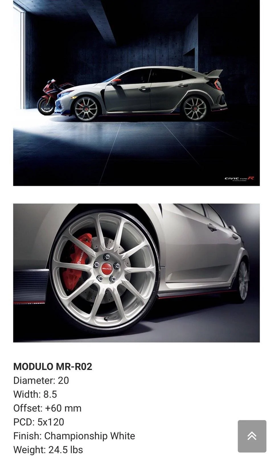

I found the 20x8.5J Modulo's to be 8.4 kg (= 18.5 lb) lighter than the originals.
So an original weight of 28 lb - 18.5 lb difference equals to only 9.5 lb, or 4.3 kg!
That is very, very light IMO. Is it possible or were they talking about complete wheels instead of just the rims or is it 8.4 kg for 4 rims/wheels? Not very clear...

18x9 +48 will not poke out, we have sold a handful of 18x9 +50 and those allow for maximum tires without poke. And 265/35 will be heavier than 245/30. The 18x9 +48 will be a good size for what you need.

The modulo weight I found to be about 24.5 lbs, there's no way the wheels are only 9.5 lbs for 20x8.5 lol. I believe the weight savings they posted were for the full wheel and tire package.

I believe it might be total weight savings among all 4 wheels combined. If anyone can confirm the weight of these wheels that would be great. But for the price per modulo wheel you might as well look into a set of 19” nsx front wheels or Volks and call it a day that is unless you have the funds for them. @Kami Speed posted these specs a while back. 24.5lbs sounds more realistic on wheel weight per wheel in my opinion.
11th Gen Honda Civic 2018+ Civic Type R FK8: Volk Racing Wheel Guide BB07EFE3-BF22-4602-B62F-BEE6BF97CCF1
