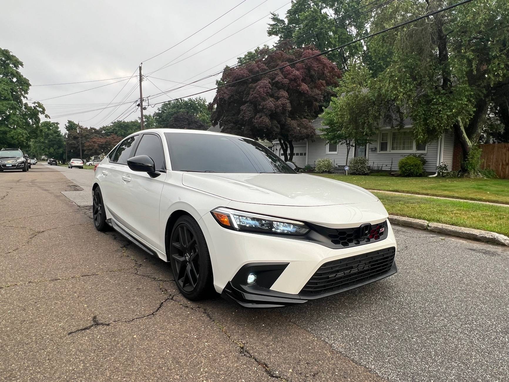

Hey guys so I recently added my down pipe for my 22 Si half a day driving it was smooth but following day I got the CEL light for the o2 sensor but I disabled it on my ktuner but now It’s bogging out at 5k rpm and going into limp mode. I played around with the tuning but still bogging at 5k and it’s running too rich. Any suggestions? Currently it’s back to factory and it’s my weekend car so not too worried but wanting it to run good.
Mods -27won SRI, Inlet pipe and Downpipe.
