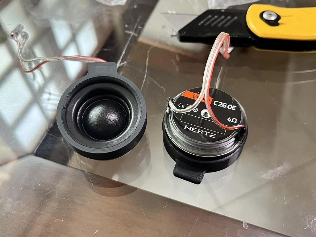

Tweeters: This bracket is designed to replace the original front tweeters with the Hertz C 26 OE tweeter (38.63mm outer diameter) and can also accommodate smaller tweeters with a gasket around them. Since it's not a structural part, you can print it with low infill and secure it with hot glue to prevent rattling.
11th Gen Honda Civic 3D printed Speaker Brackets/Adapters tweeter.JPG

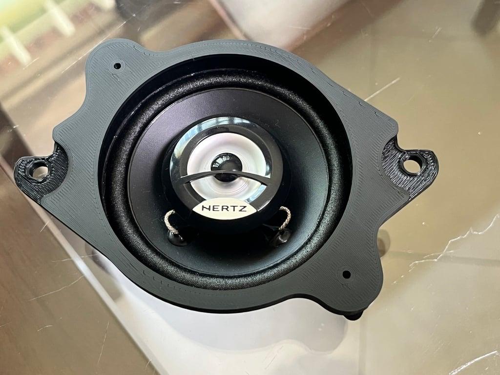

Center Speaker: This bracket mounts a Hertz DCX87.3 speaker at a 45-degree angle, aligning the tweeter with the factory position for aesthetics. The bracket has 2.5mm mounting holes compatible with the screws provided by Hertz. There's also generic brackets in there that should fit most 3.5" speakers without a spacer ring and offers additional mounting options at 25 and 35 degrees. The 2mm holes can be drilled to size if needed.
11th Gen Honda Civic 3D printed Speaker Brackets/Adapters center

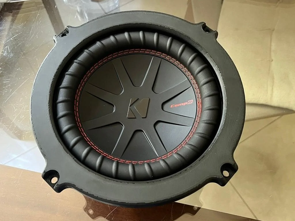

Subwoofer: This bracket mounts an 8" Kicker subwoofer (like the 48CWR84) to the rear deck of the sedan. It has 8 locating pins to help aligning everything during instalation and to prevent rotation during use. You can reuse the original bolts, but M6x20 bolts are recommended for easier alignment and securing.
11th Gen Honda Civic 3D printed Speaker Brackets/Adapters sub
