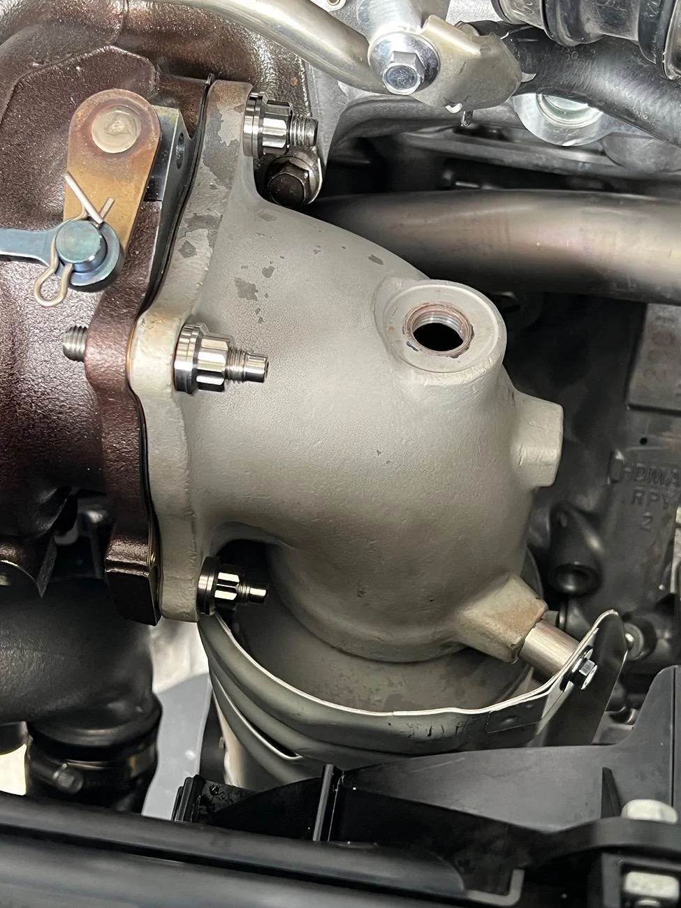

Yup. No need to keep it pretty. It will be hidden under the factory heat shield anyways.
11th Gen Honda Civic Advice for not snapping turbo/downpipe bolts IMG_9771
The titanium nut helps make it look a little better too.

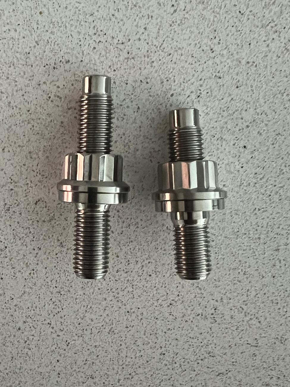

This is interesting too. TSP Titanium stud length vs Rampage stud length. TSP on the Left and Rampage on the Right.
I wish the TSP were just a tad bit shorter just for the sake of simplicity on installation. I had to play tetris when installing mine. But it all fit without any issues.
