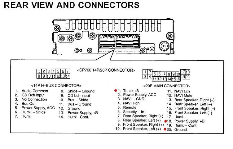

so you basically, starting from the factory wiring that goes to their speakers:
-tie in the front “4” factory speaker’s wiring to LC7 channel 1 inputs
-Tie in the rear “4” factory speaker wires to the lc7 channel 2 inputs
-tie in factory bass signal (if there is one, if not create it) into lc7 Chanel 3
Then:
- LC7 channel one and two go to the 4 Chanel amp,
- lc7 channel three to the mono for the sub,
…… then it’s just everything I’m familiar with after that?
is it going to be this simple? That sounds too good to be true if it’s that easy!!!

Actually, there is no sub channels on the non Bose system. Front driver is ch 1, front pass is ch2, ch3 and ch4 are the rear. Use auto sum from ch3/4 to create the sub signal then feed into AMP that way. You'll need to run separate wiring for the new speakers as the OEM is really low end. Make sure to watch videos and read up on how to setup your LC7i and make sure you setup your AMP after you're done with the LC7i. Going back after setting your bass and channel signal strength messes with AMP gains so LC7i first then the rest is the AMP.
thank you, that seems simple enough!
for some reason I always imagined setting up with a factory head unit would be so much more complicated but this all sounds pretty cut and dry.
indid see a few blurbs about setting up the lc7s when I was quickly checking prices on them.
I’ll figure that out, my main worry was having to dig deeply through factory rats nest wiring but seems it won’t be bad at all..
thanks again man, this thread really eased my mind
