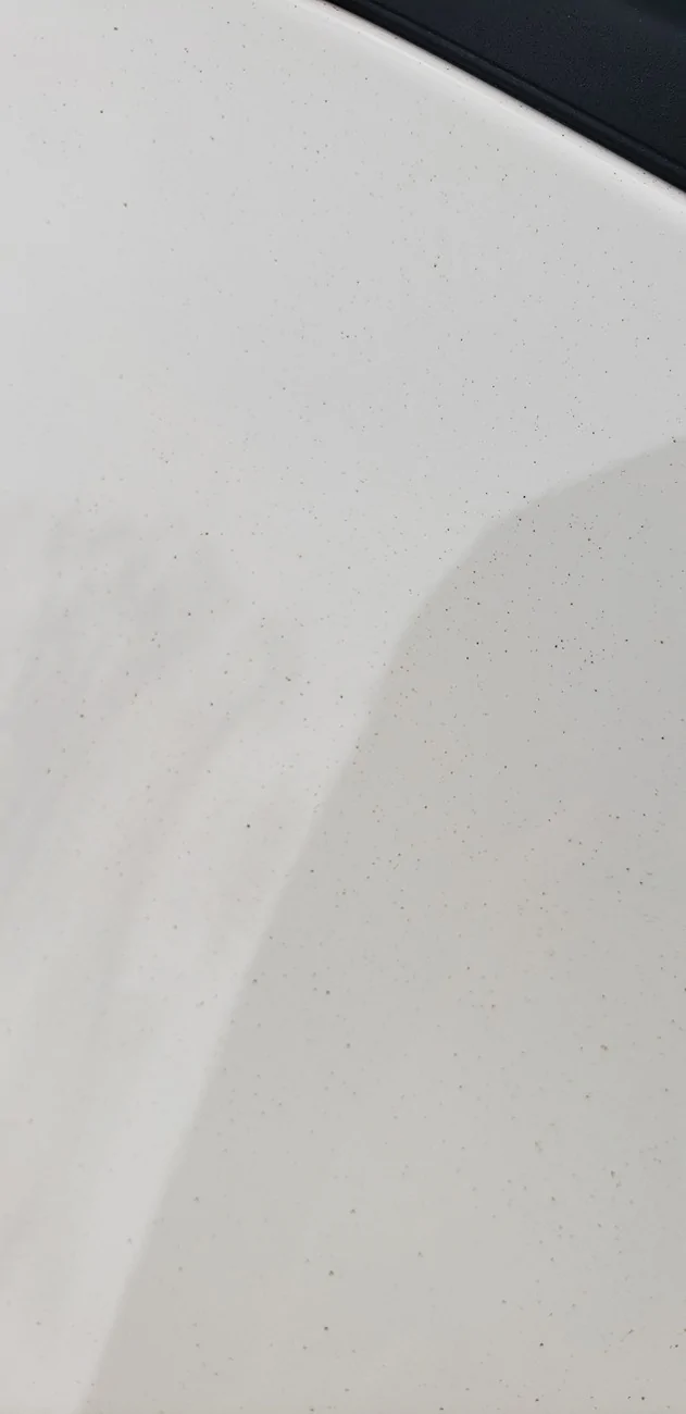

Mine was in bad shape when I received it. Wash, decon, polish, prep, ceramic coating. Adjust your steps based on the condition of the paint and your expectations.
