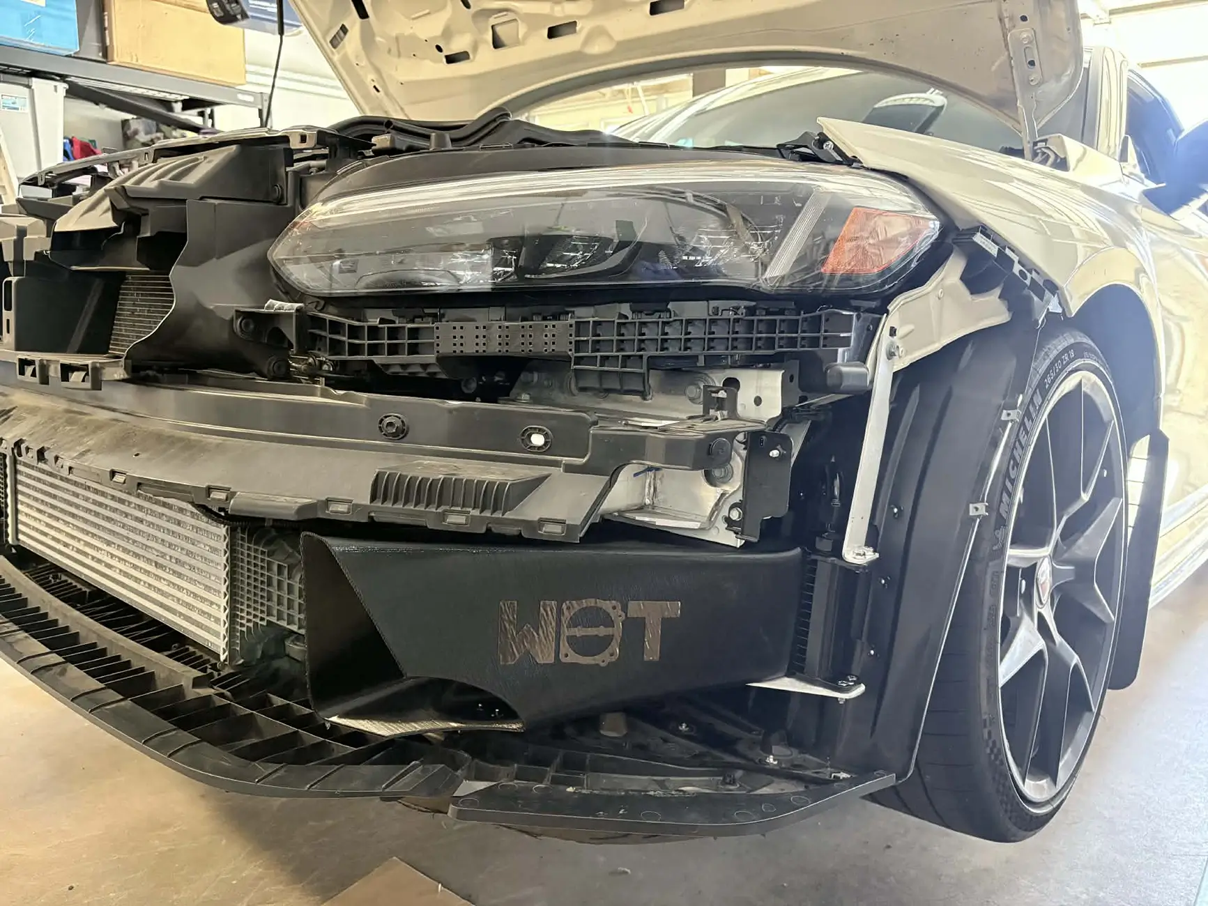

Sebring at 88 degrees with:
93 Tuned, HKS intercooler, CSF radiator, HEL oil cooler and WOT cooling plate = I would get to 235 coolant by 12-15 minutes into session and I’d have to cool down.
Sebring at 93 degrees with:
E30 Tuned, HKS intercooler, CSF radiator, HEL oil cooler, WOT cooling plate, CANFLEX AND PTP HARDLAGGED DOWNPIPE BLANKET = 233 max coolant on the last lap of 20 minute session while pushing the car to the limit.
The cat can get over 1,000 degrees on the track so insulating that was huge I think. Dream turbo heat shield and Acuity reverse flow hoses to be installed next.
