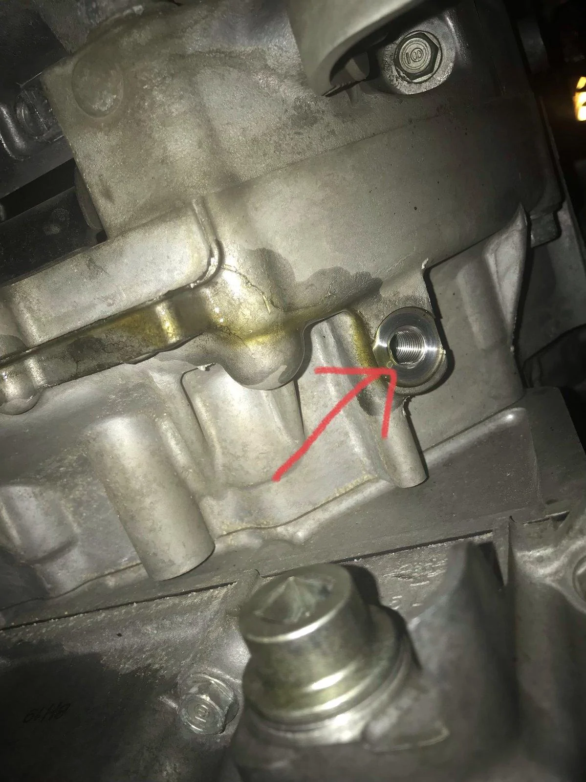

It's a slight angle, but I get it. Allow to warm up a little until it spills over. Where is the fill area inside the engine compartment? I will upload pictures of both areas in question later today.

I have to circle back to this. The CVT fill plug on the 1.5 Turbo is accessible and easy to get to. Draining cold, measuring, and filling cold may be best, especially if no leaks. Yes, it may not be filled properly at the factory, but I would hope so.
My nephew has a 2023 and it is hidden behind all this mess (The fill plug). I probably will change mine at 20,000 miles with OEM and assuming 3 to 4 quarts will be sufficient.
