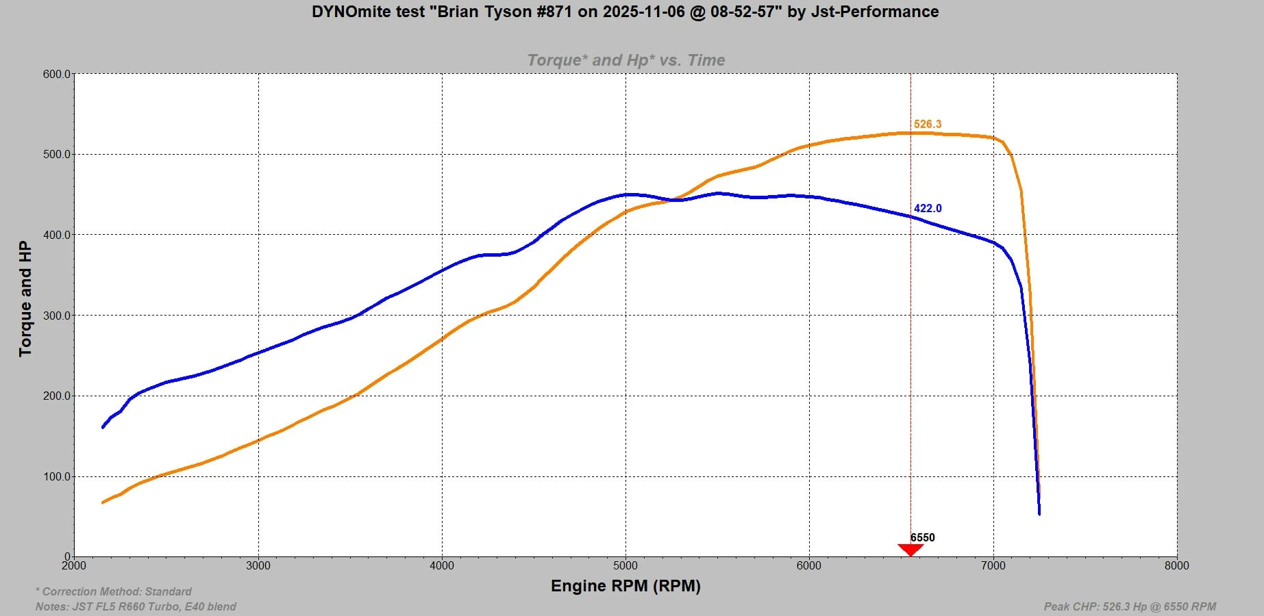

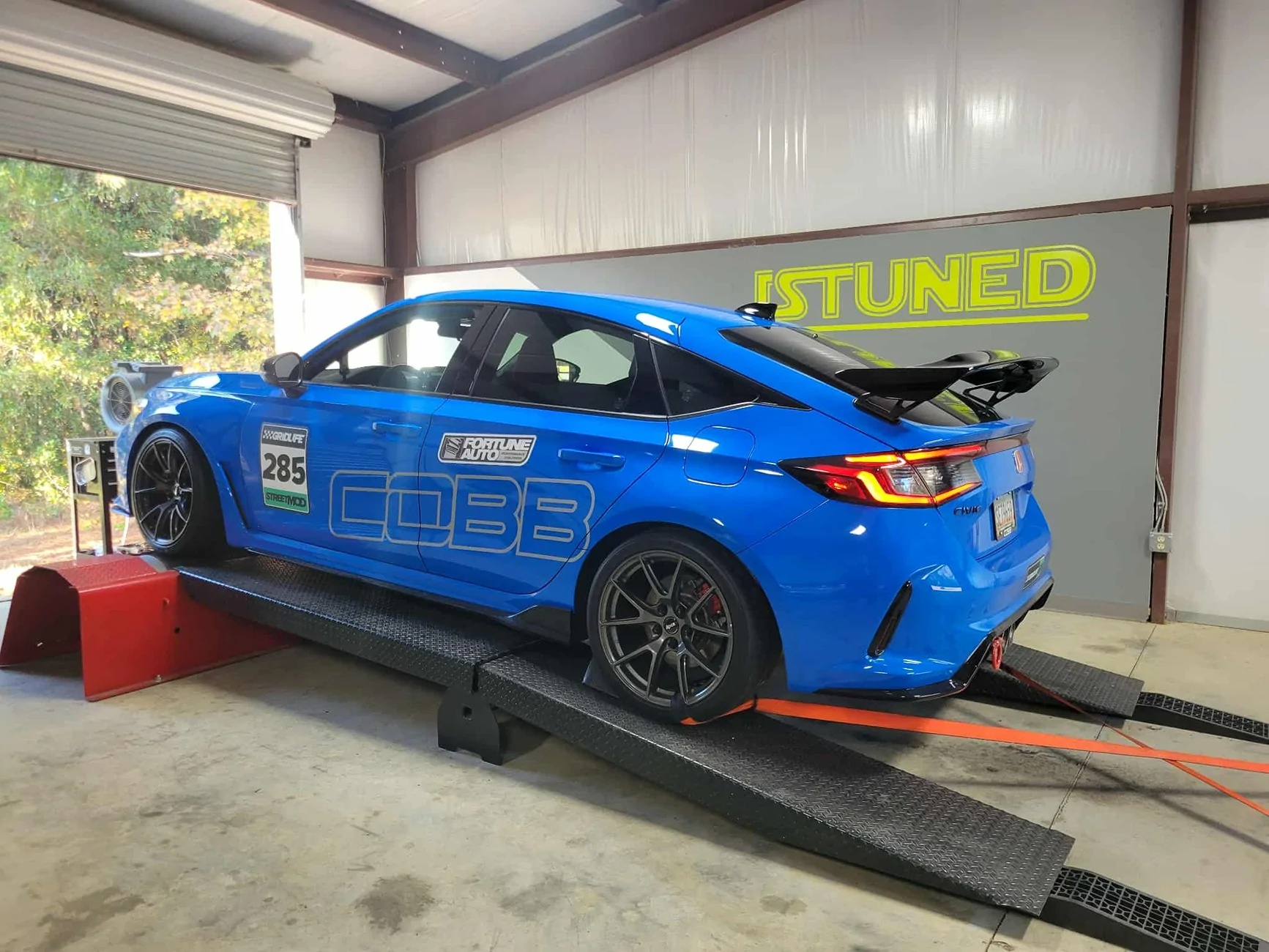

This morning a customer had to reschedule, and the weather is great, So I decided to put my FL5 on the dyno to see how things look and where its sitting at.
The most this car has made on the dyno was 512Whp back earlier this year. However with a lot of improvements to the COBB Tuning software and the addition of the new Cobb Intake and FMIC, The car made 526whp on the very first pull. I had retuned the car on the street for the new parts, but this is the first time I've put it on the dyno like this. The car could make more, but since its stock engine/ trans/clutch, I don't really see a reason to push it further. It already makes 240WHP over stock haha.
Did 3 pulls and the logs showed no changes needed, so the car is back off the Dyno already. Can't as for much more than that!

- Custom tuned by me at JST-Performance using COBB Tuning Accessport V3
- RV6 R660 Turbo ( standard kit), RV6 Catted Dp and FP
- Cobb Carbon Intake, Fmic, charge pipes, and RMM
- XDI Evo HPFP and 1400cc injectors
- E40 ethanol blend
