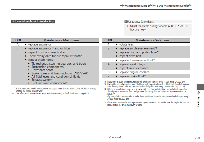

I didn't find the maintenance schedule in the manual, or I missed it in the book?
I want to know how often to change oil, coolant..., what to do at 1 year, 2 year...
I drive very few, 800 miles on my current car the past whole year.
The maintenance minder will let you know. Driving style regulates oil change intervals.

I believe it tells you somewhere to change the oil at least once a year even if the MM doesn’t get down to 15%.

Hmm, valve clearance check at 74,500 mi eh? You know you've got a gnarly vehicle when there is a valve job in the routine maintenance schedule.
used to be every 15k lol. at least thats what i followed with my b16
