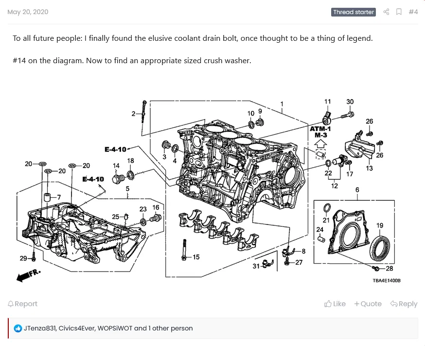

The drain plug gasket part number is 94109-20000.
90401-pr4-4000 is the correct part number for the engine block coolant gasket.
https://www.civicx.com/forum/threads/where-is-the-engine-coolant-drain-bolt.49501/
11th Gen Honda Civic Transmission & Coolant Plug Washers 1759770854228-dn
#18 in the pic. 28 mm.
