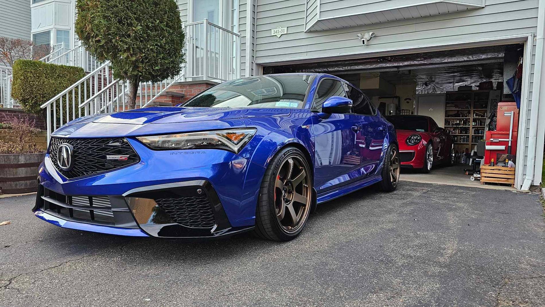

@lmtlsauto I'm interested in TE37's but only in face 3.
I'm lowered on H&R springs and am running AD09 tires in 265/35 R19. I'm guessing that 19x10.0 +37 will be too aggressive to fit without excessive camber. Have you heard of anyone able to make this fitment work?
No excessive camber needed but you will need to be on 265/30.
265/35 will require a camber kit to adjust a more inwards to help with clearance.
What camber kit is recommended? Would rear camber be needed?
For front the EVS ball joints, we have them in stock
For rear the Eibach rear camber arms, also in stock
