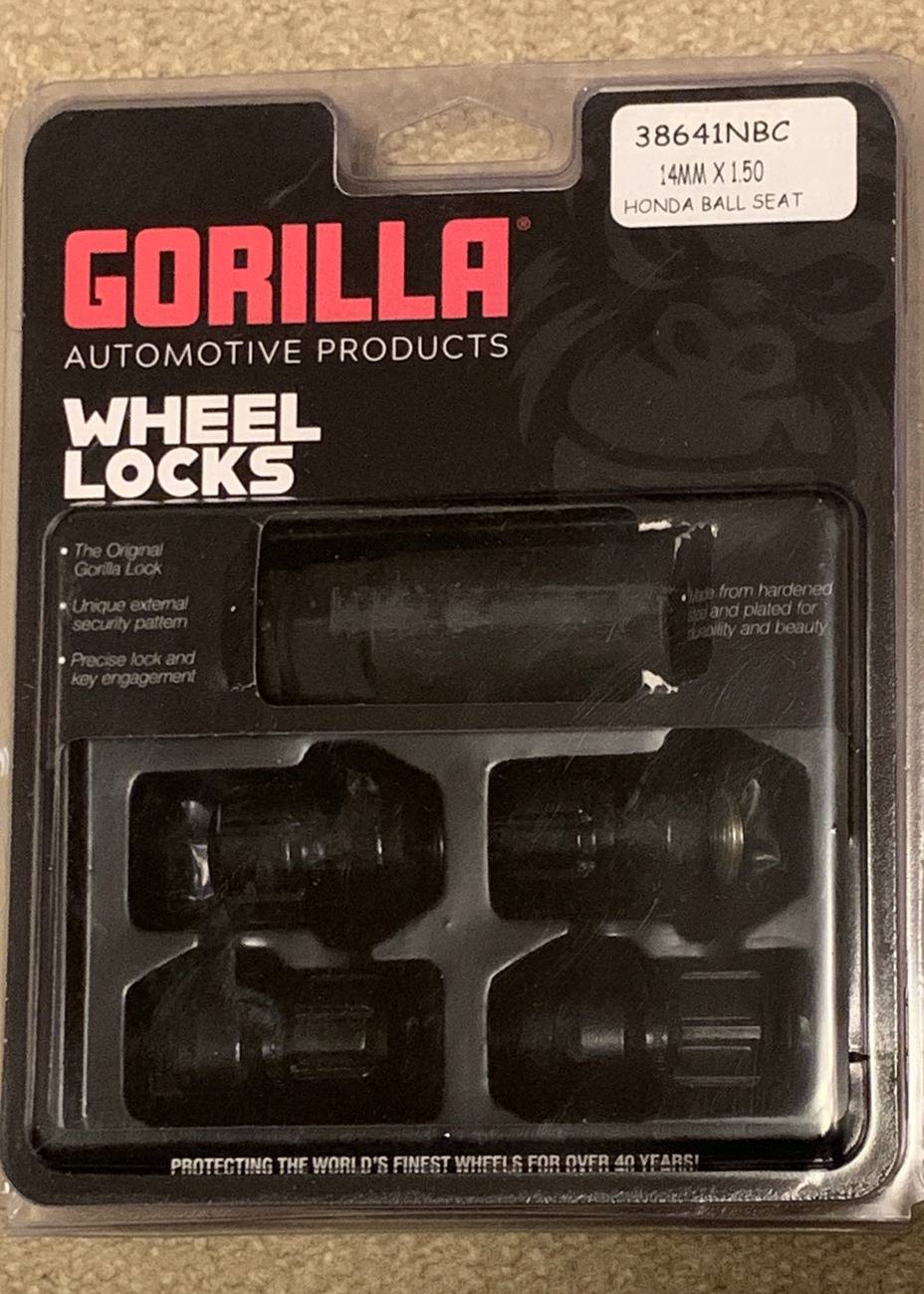

I just researched the same, and purchased Gorilla M14x1.5 with the Honda Ball Seat (curved rounded seat, not the tapered conical 60 degree seat)
it was the correct size and seat for the Type R OEM wheels.
however, I had to return them...
the Gorilla nut was too tall and was protruding above the OEM wheel

still thank you, I was about to give up on locking wheel nuts, and your post made me research the McGard. just ordered a set.
anyway, I can confirm that the bolts are indeed M14x1.5
