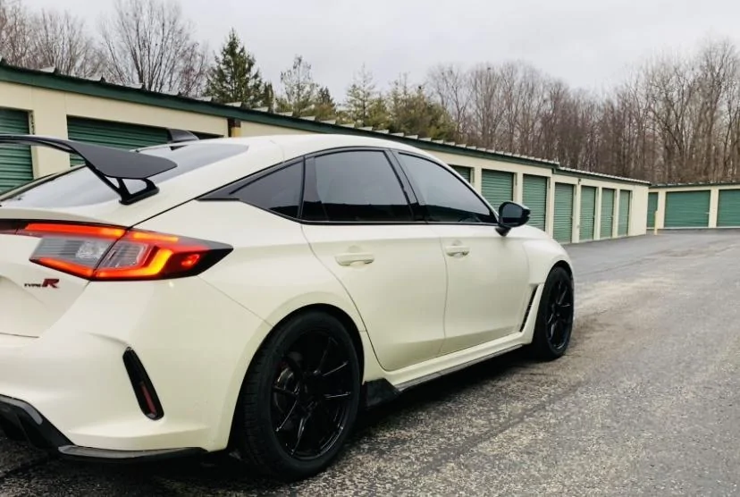

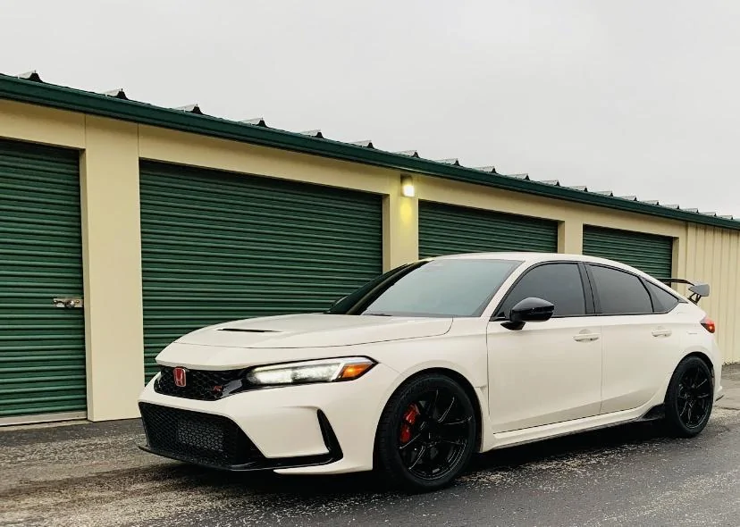

18x8.5 Enkei TS-V + 255/40 DWS06+

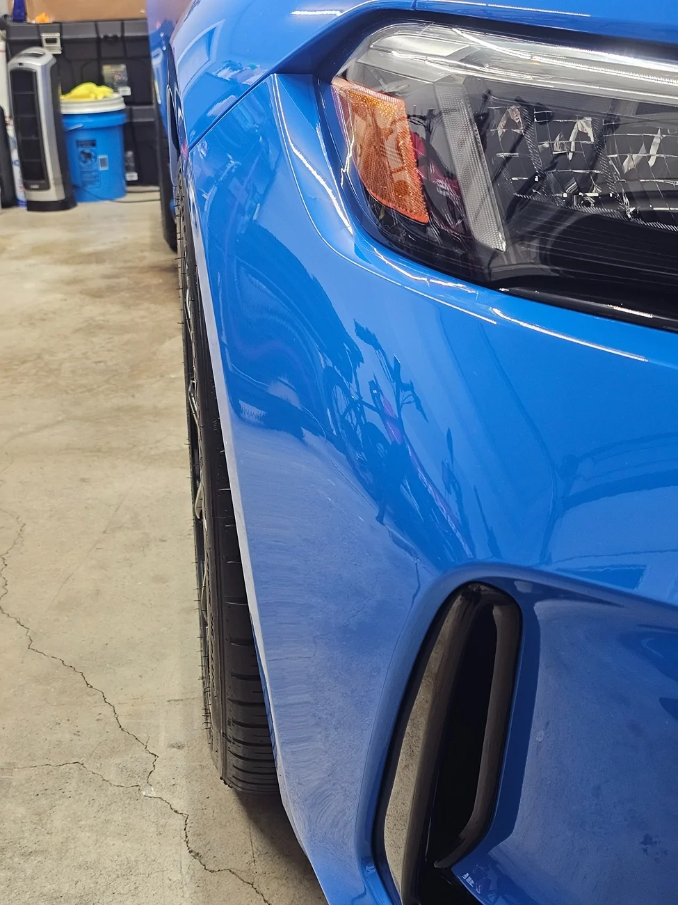

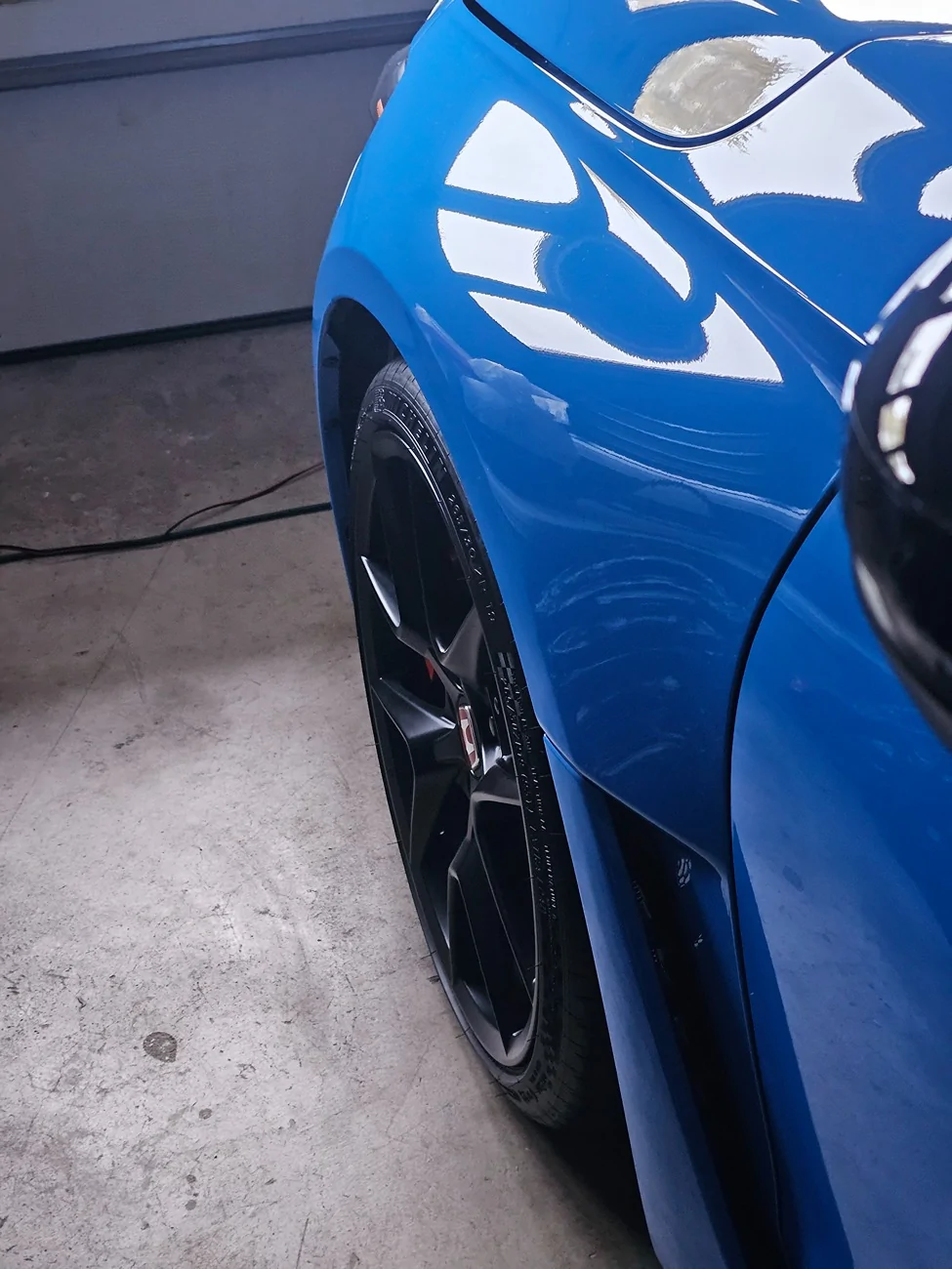

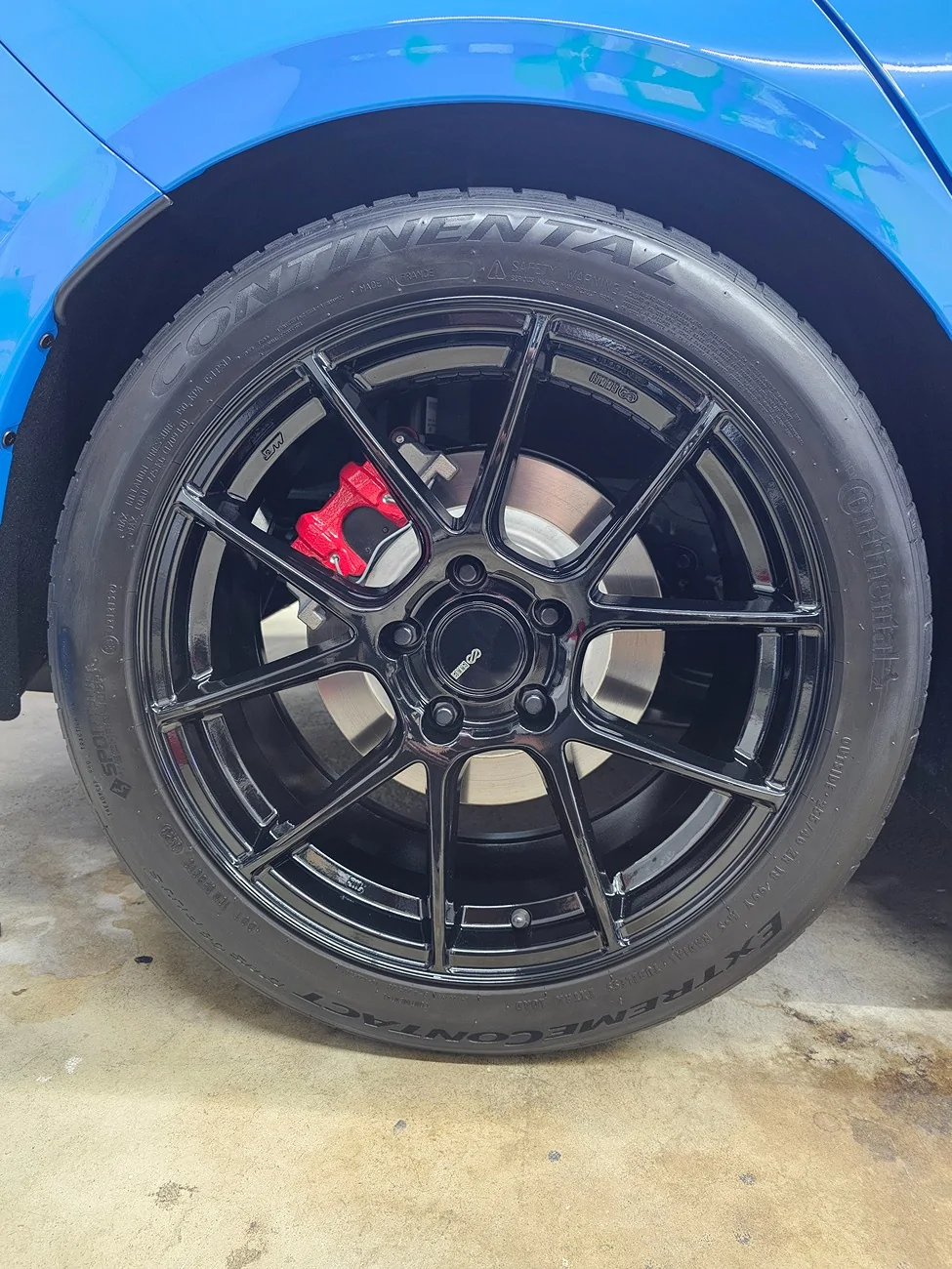

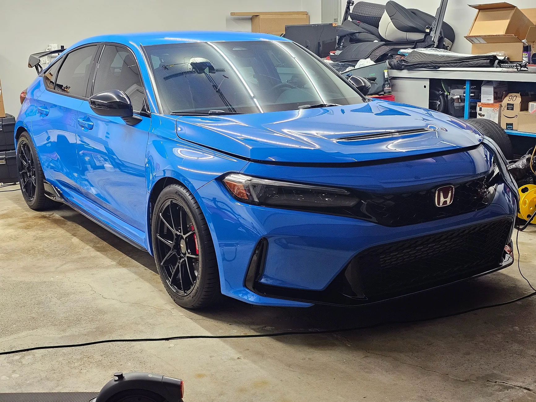

There is a wheel (Enkei PF06) I like that comes in 18x9+42, which is the next fit down from 19x9.5+45. I'm torn between running 265/35 or going narrower to 255/35 or 255/40 so that the sidewall is better supported. I don't want to lose much steering sharpness, but I also don't know what I'm giving up with narrower tread. My use case is street driving only, lots of rain, generally poor road surfaces (sometimes loose/gravel).
Do you have any input?

Given what you've said, I stand by my 255/40 recommendation. After you go this route, come on back and tell me how little you actually lost in regards to steering sharpness, and how happy you are with them across the board.
