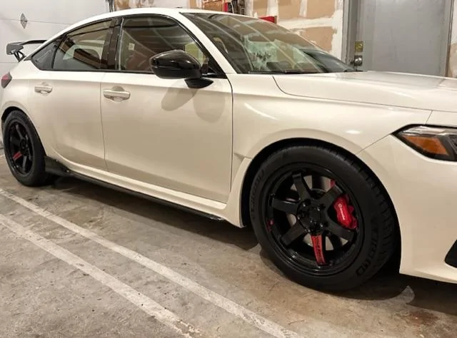

Does yours rub at all? Do you see any risk in it? I'm planning to get a new set of 18" wheels with 43mm and tires for 265/40/18 as well.

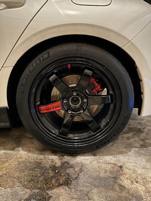

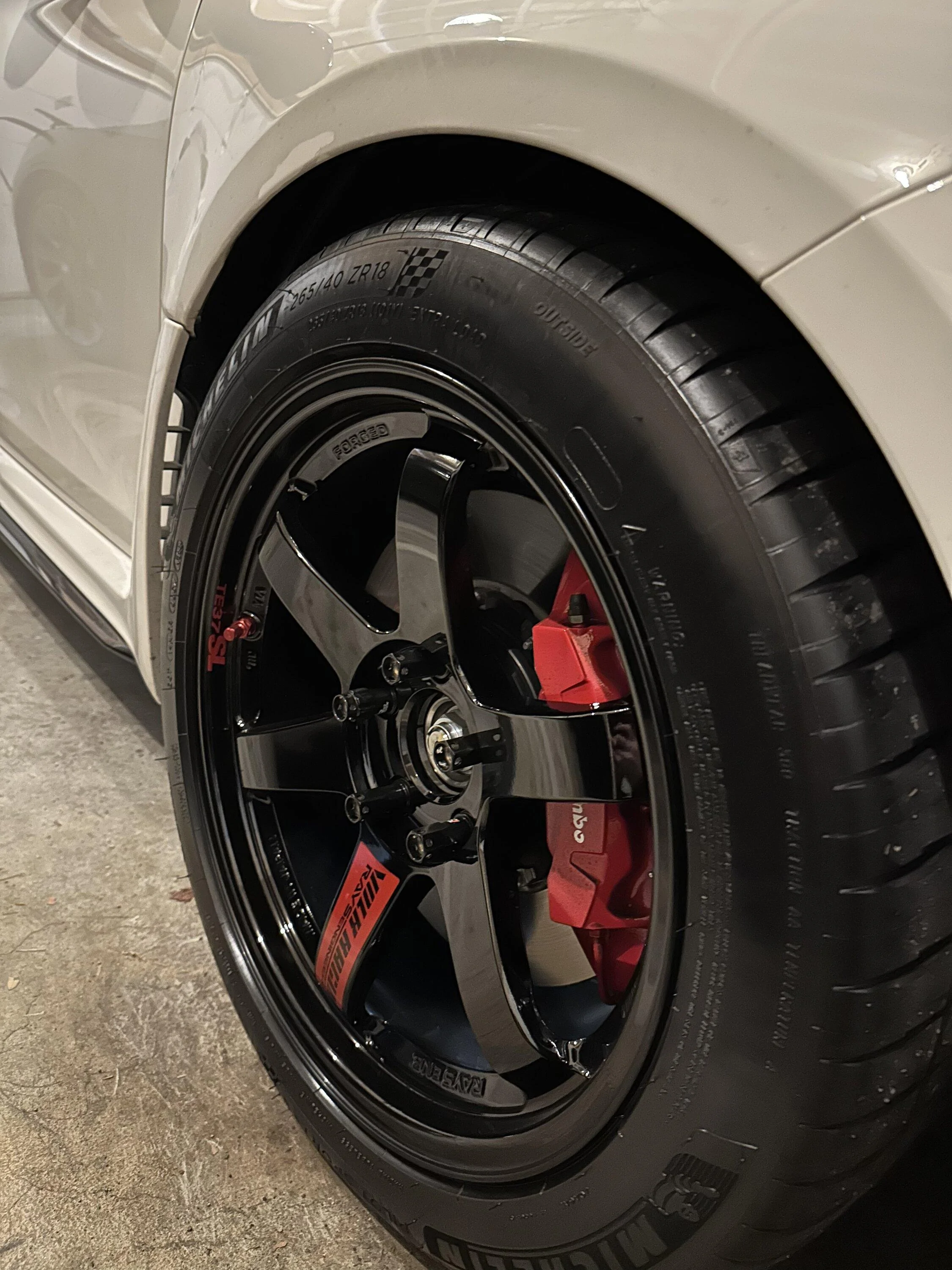

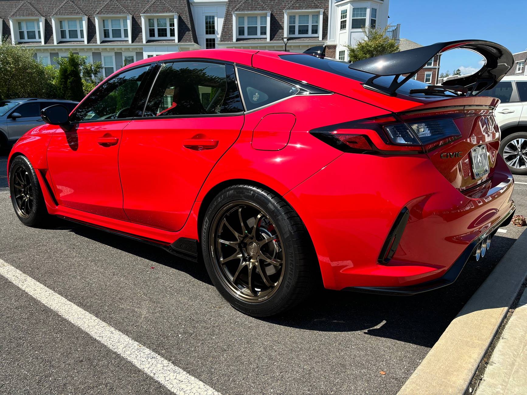

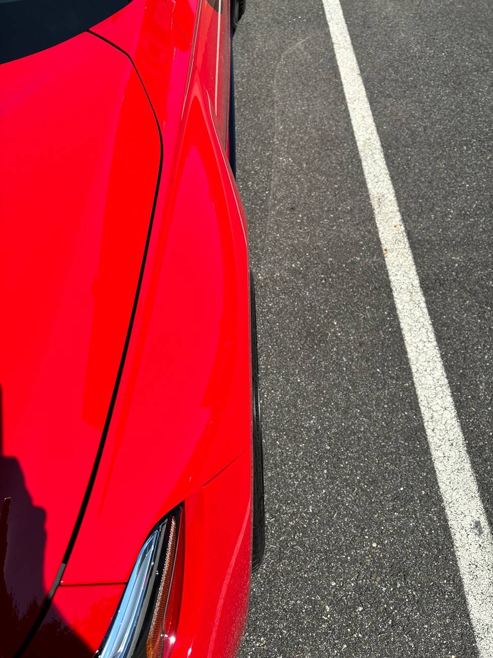

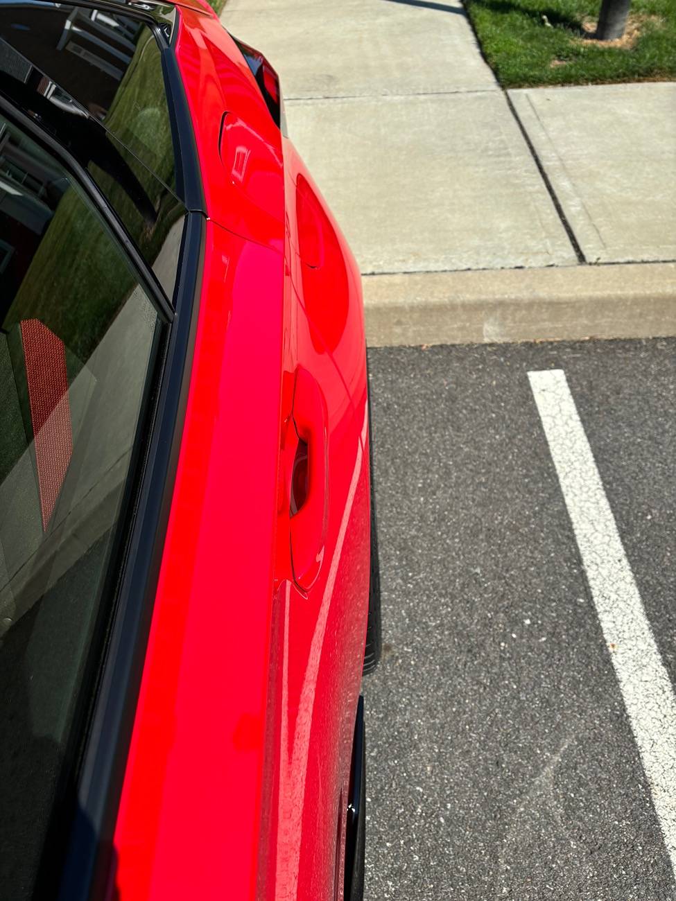

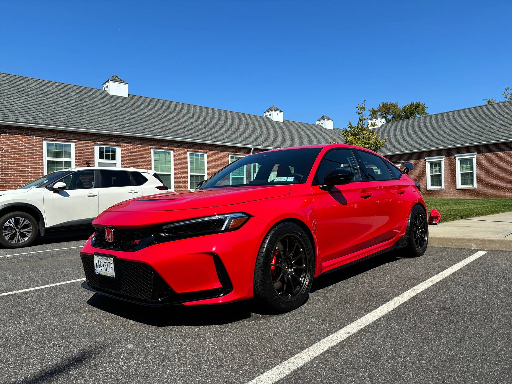

Thanks! I haven’t had any rub. This set up I believe, works out to a 0.5in raise. I have some rough roads and speed bumps here. This helps me clear it with ease. I plan on keeping it stock suspension for now.Dude!! Sick set up. Thanks for sharing!
Do your wheels stick out?? The pic of the front wheel gives that impression
Great looking setup! Could you share the part number for the wheels and tires? Thanks!
No it does not poke out, it’s tucked in nicely, no rub.Do your wheels stick out?? The pic of the front wheel gives that impression
The wheel is TE37 SL in gloss black 18/9.5 +45, and the tires are Michelin PS4S in 265/40/18.Great looking setup! Could you share the part number for the wheels and tires? Thanks!
Thanks for posting. How is the ride comfort compared to stock? How does it feel on the highway?Thanks! I haven’t had any rub. This set up I believe, works out to a 0.5in raise. I have some rough roads and speed bumps here. This helps me clear it with ease. I plan on keeping it stock suspension for now.
The ride is definitely more plush, and comfortable especially on the highway. There seems to be less tire noise compared to the stock set up. I went with a lighter wheel too, to help with suspension compliance. I believe the stock wheel was ~26.1 lb and tire was ~25.1 versus the now ~18.5 lb and ~26.1 lb. In addition, I believe that the fl5 ground clearance is about 20mm lower than fk8, which i think the set up is good for bad roads. The ride is not completely plush by any means, it is still sporty, but now it is not punishing. Still have stock set up to use if I ever have the chance to hit the track or auto cross. Hope this helps!Thanks for posting. How is the ride comfort compared to stock? How does it feel on the highway?
Any issues with the 40 sidewall? I just got a set of Advan GT Beyond at +45et and want to do 40s instead of 35s for ride quality. Any rubbing or turning restrictions? Hard bump rubs?I run a 265/40/18 on a 18/9.5 +45 wheel. Very meaty tire, but can deal with potholes, tall speed bumps and steep drive way easily now
Had this set up since March. No issues with rubbing or hard bumps. Have some tall speed bumps at work no rub with that either. I am at stock suspension though not lowered.Any issues with the 40 sidewall? I just got a set of Advan GT Beyond at +45et and want to do 40s instead of 35s for ride quality. Any rubbing or turning restrictions? Hard bump rubs?
