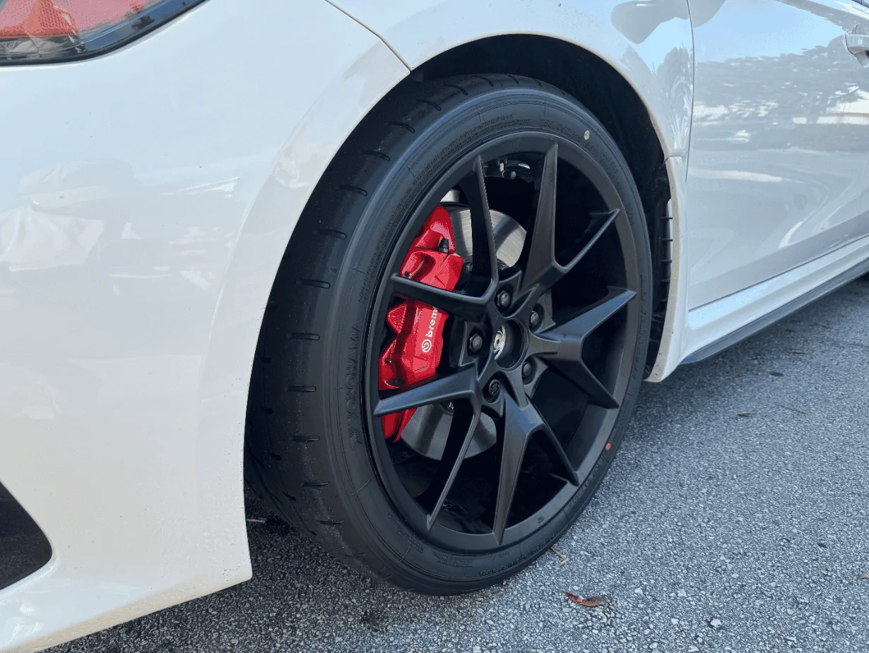

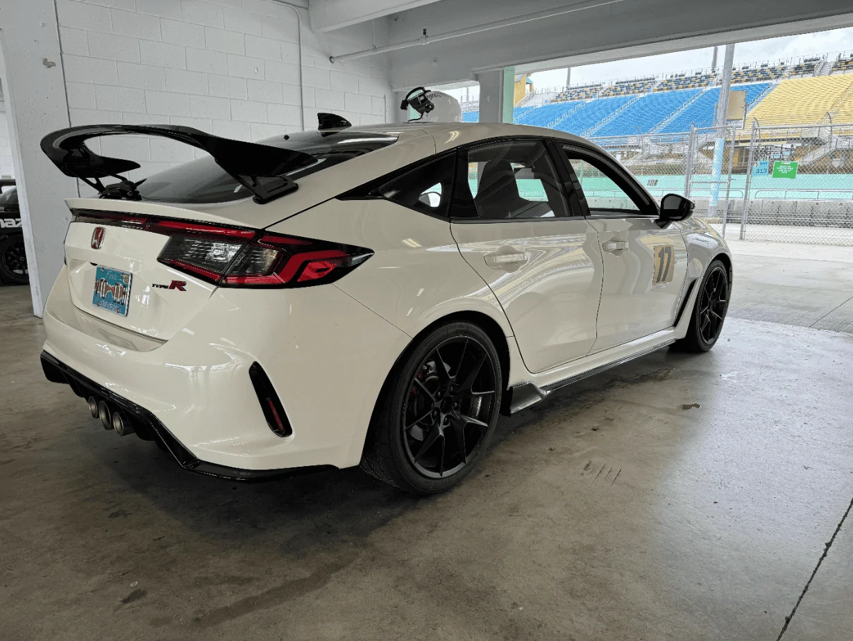

A little preface; after 4 track days on the factory tires I had enough of the lack luster performance, especially after swapping in more aggressive track pads. So I decided to go searching for a 200TW tire in the OEM size, unfortunately there aren't many options out there. So I had to do a little digging to see if I can swap in a slightly different size but still maintain the same or similar overall diameter.
As such, I pulled the trigger and purchased the A052's. After some research I found out that the 255 35 R19 size has a marginal increase in overall diameter but a wider tread width then stock. After a month of driving on the street and a full weekend at the track I'm happy to report it has been the best mod I've done to the car. At my local track I was able to improve on my PB by 3-seconds and pound them for full 25 minute sessions. In addition, with the slightly taller sidewall the ride comfort has improved, but road noise has increased. If you are picky about road noise this is not the tire for you.
Anyways, enjoy the following pics of how it looks on the wheel:
11th Gen Honda Civic 255 35 R19 Yokohama Advan A052 (OEM Wheels and Height) Cropped in 0
11th Gen Honda Civic 255 35 R19 Yokohama Advan A052 (OEM Wheels and Height) Cropped in 1
