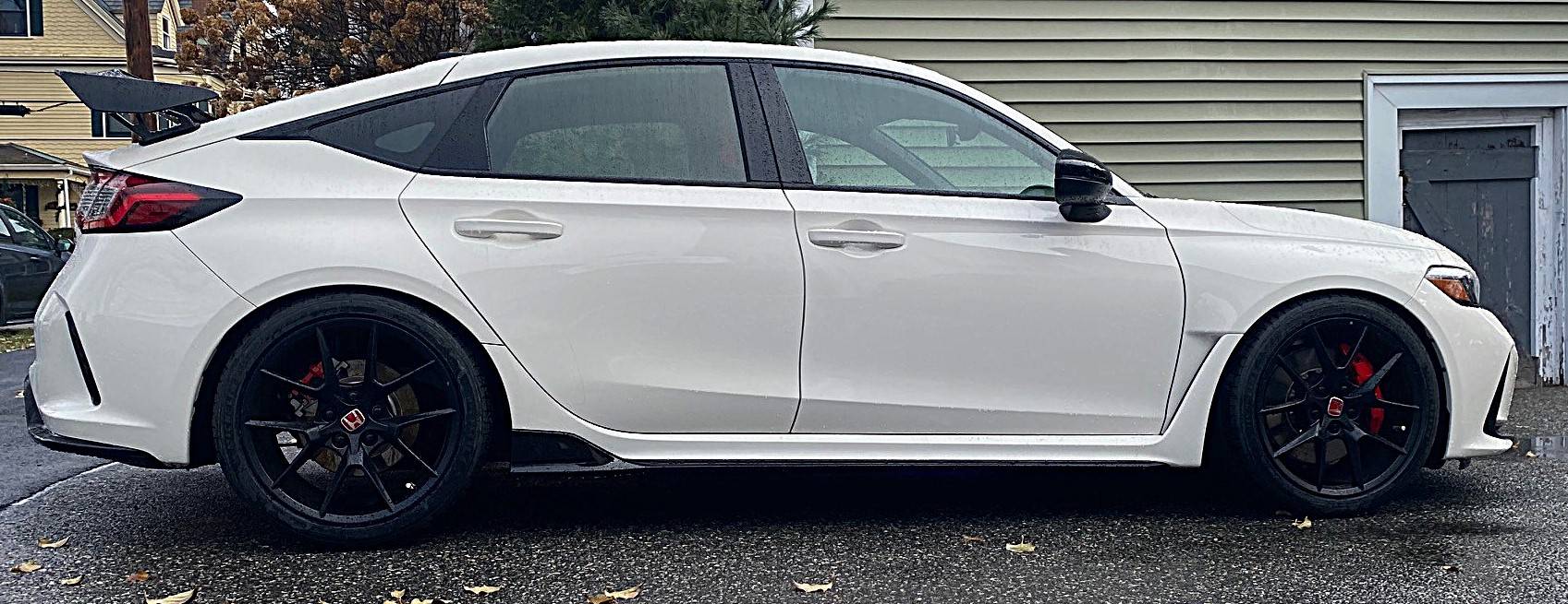

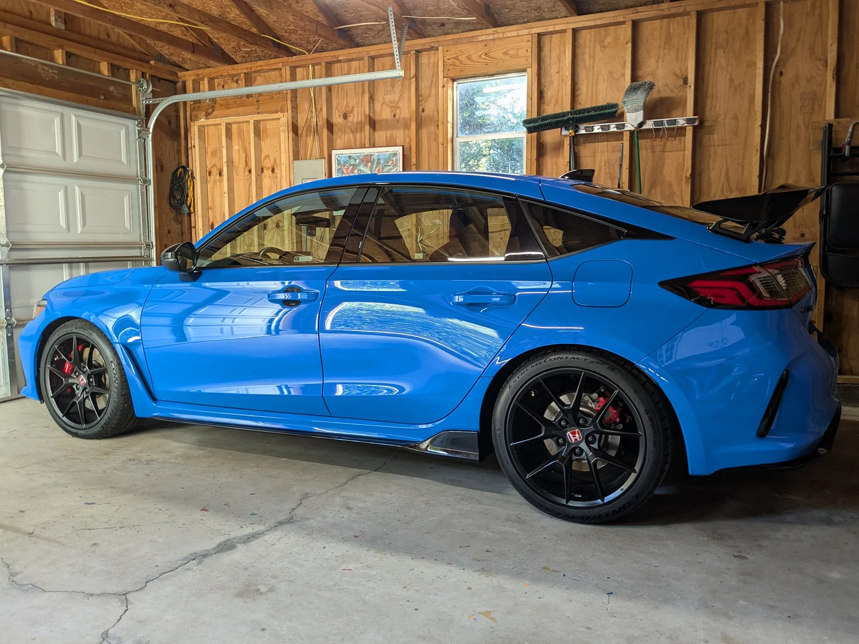

I am running 265/35/19 with H&R springs and H&R 20MM front and 25MM rear spacers with no issues. 275's are only .4 inches wider so I don't foresee a problem. There are a number of users here running 275 width tires.
I am about to lower on H&R and I have 275/35/19 and some people are saying it will rub. Based on your setup I dont see how it would. I may even try to run 15mm F&R spacers. If your not having issues with 265’s, I hope I will be fine.

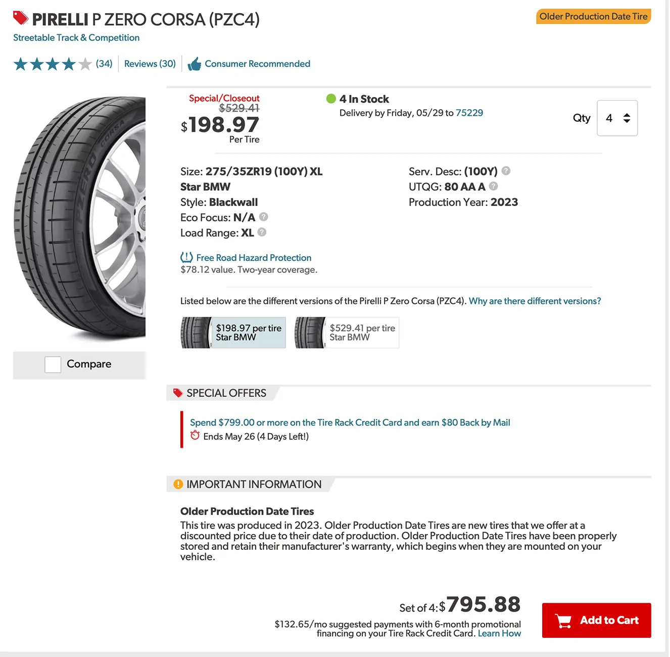

Has any one tracked tires in this size, without any rub. I'm racing COTA next week, and have to be 1000% sure. I'm on stock suspension, stock ride height, stock OEM Rims. I was not sure if I saw anyone tracking this tire size on stock rims. My only suspension modification is ball joints ~ 3 degrees negative in front tires.
  • Front camber: about -2.8 LF / -3.2 RF
  • Front toe: -0.07° total toe-out
  • Rear toe: +0.28° total toe-in
Would appreciate anyone that's tracked these size tires with sustained loads on track, braking, sustained high g level turns, etc, . Let me know asap your experience! Am I 1000% safe to run these at COTA?
I just ordered 8 PIRELLI P ZERO CORSA (PZC4) track tires, in 275/35/19 because they were a crazy deal.

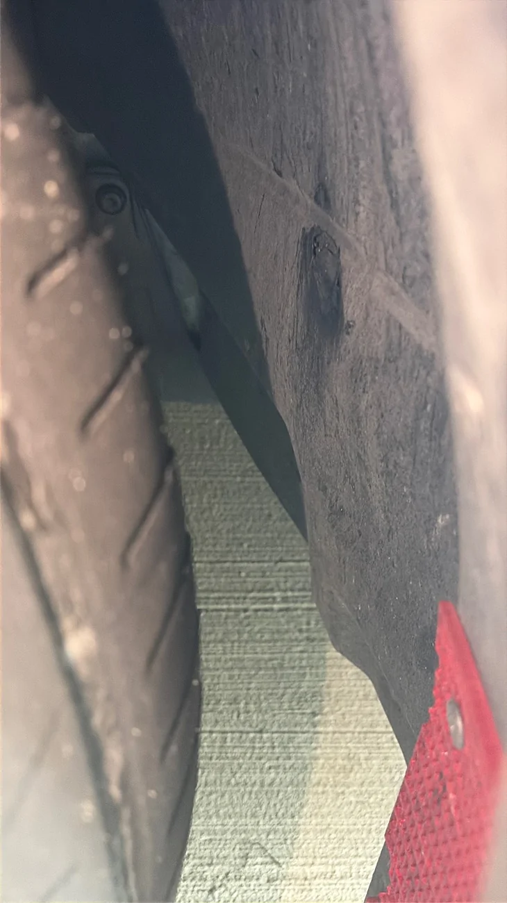

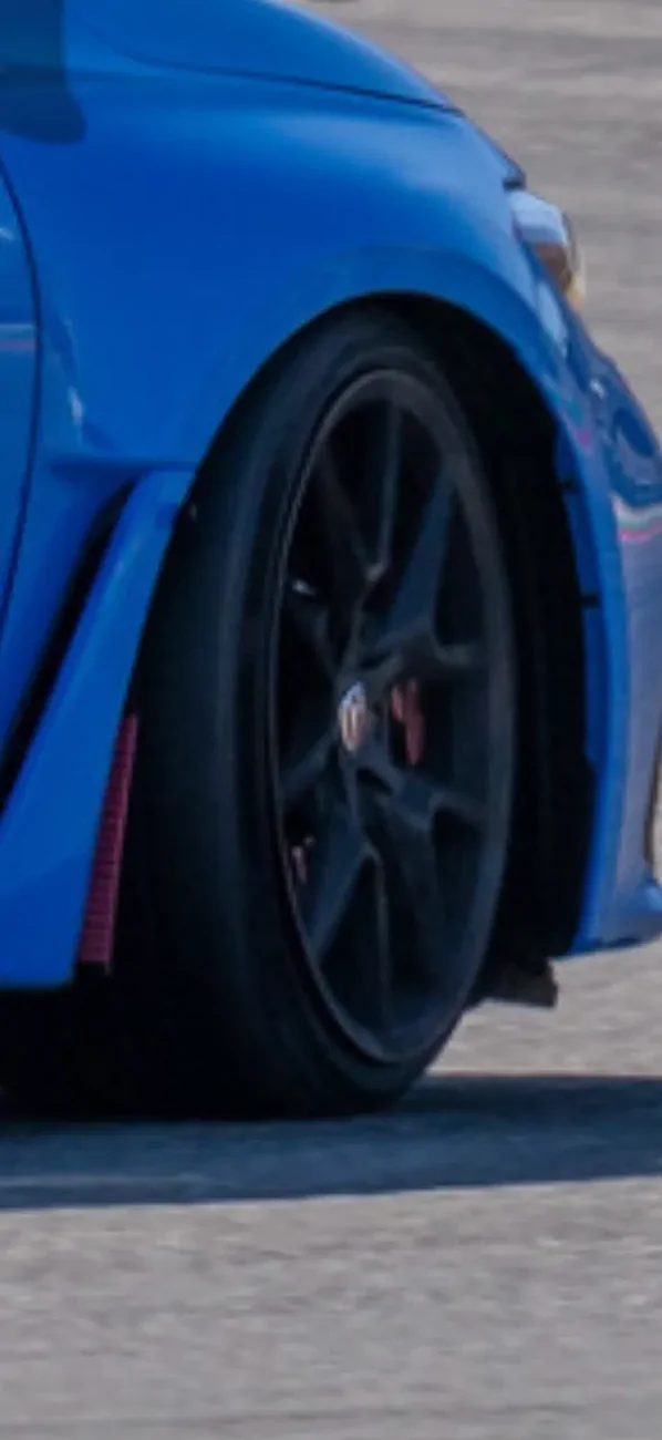

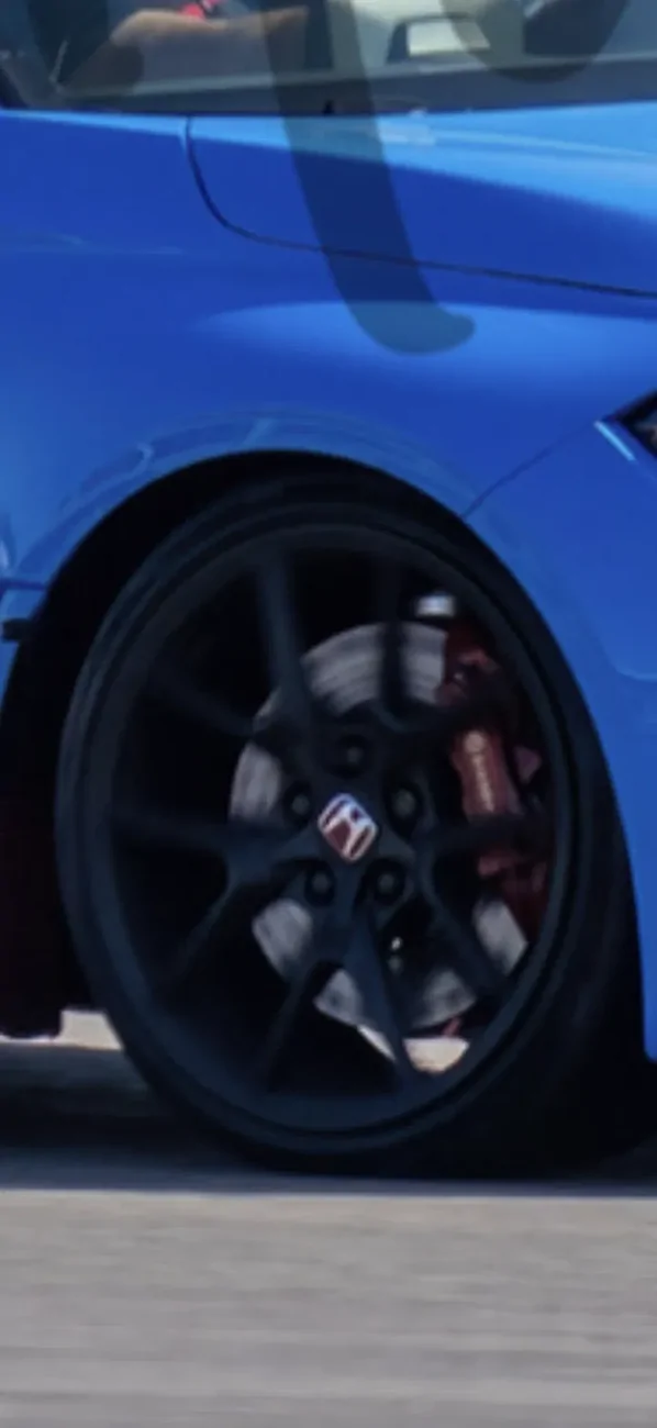

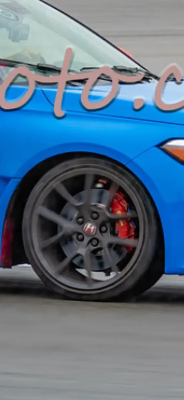

Can anyone else confirm this 275/35/19 works on track during cornering loads and maximum forces?
Here is why I'm concerned, you can see it's getting really close to the fender, and this is a stock car with only negative camber ball joints in front ---
Would appreciate anyone's feedback that has tracked the tires asap!
This is what the stock tire looks like under heavy compression on track in a right hander.

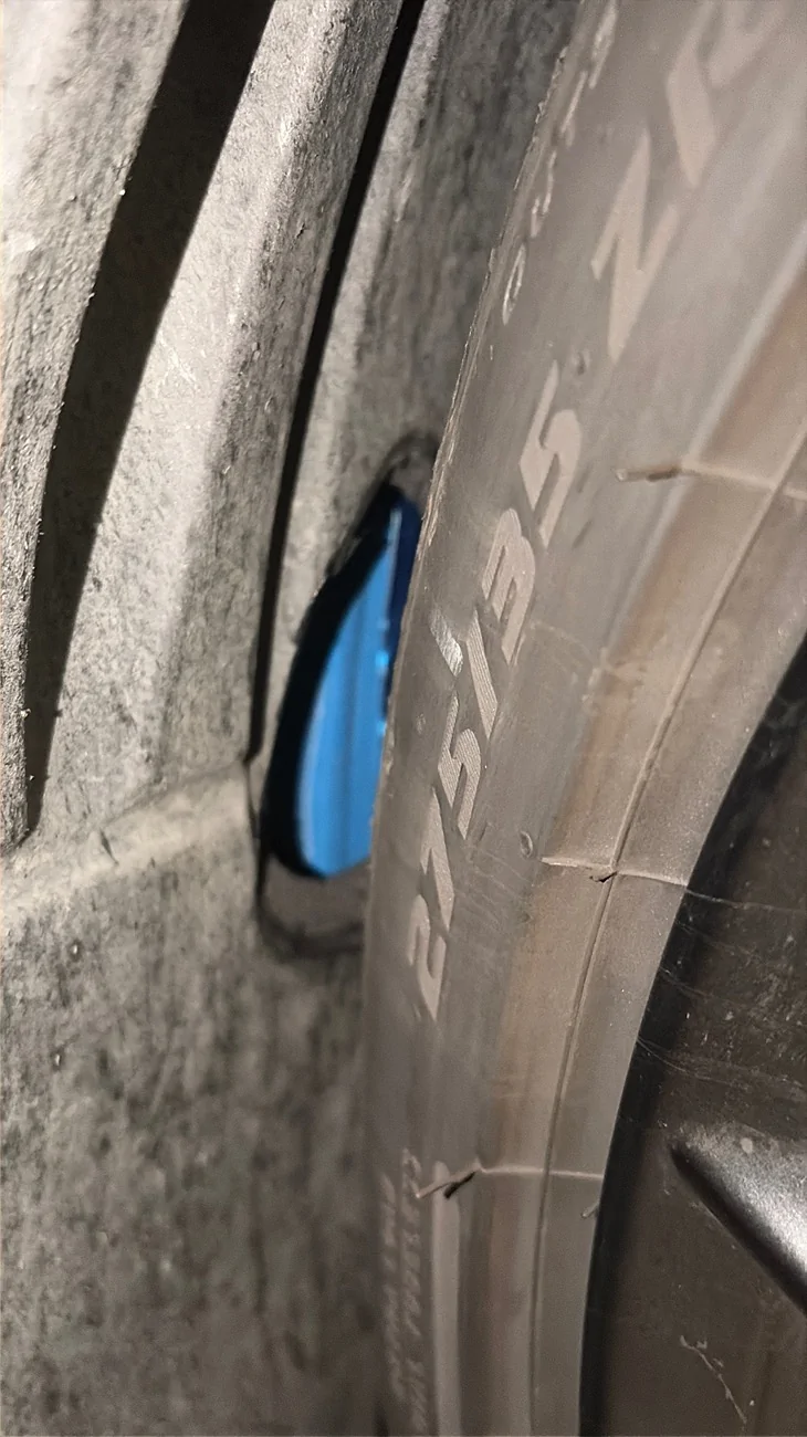

Here are the results after 2 heavy track days at COTA in the Advanced group on 275/35 19 Pirelli PZero Corsa Track tires.
Positives:
1) The extra side wall feels very good, more compliant vs than racing on 265/30 19's OEM 4S DT1's or Cup 2's
2) Tires wore evenly vs 30 inch profiles
Negatives:
1) There was rubbing under high load, high g force sustained sweepers at COTA. Front Right did eat through the plastic wheel liner, but did not hit metal.
2) Gearing was reduced, my top speed on straights was usually 132-134mph on 30 profile side walls, vs ~120-122mph ( adjusted with 4mph speedo )
Front Right:
11th Gen Honda Civic Any issues with 275/35 R19 Tires? IMG_2983
Front Left:
11th Gen Honda Civic Any issues with 275/35 R19 Tires? IMG_2988
Conclusion is - 275/35 19's work, and for most all people not tracking the car you will not rub, but if you are tracking the car, you will rub, but it won't rub into the metal, just the plastic liner.
