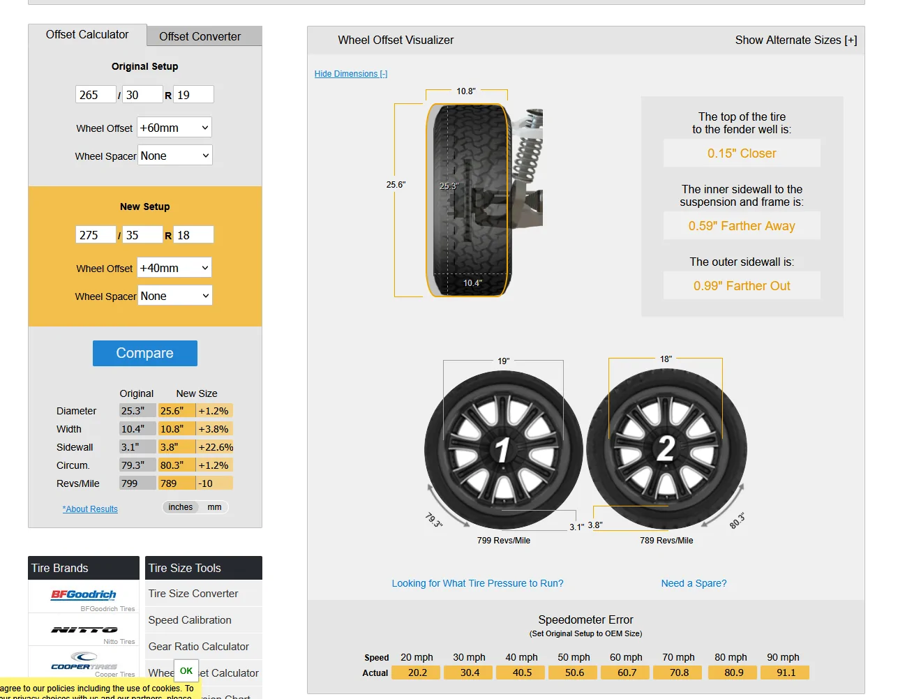

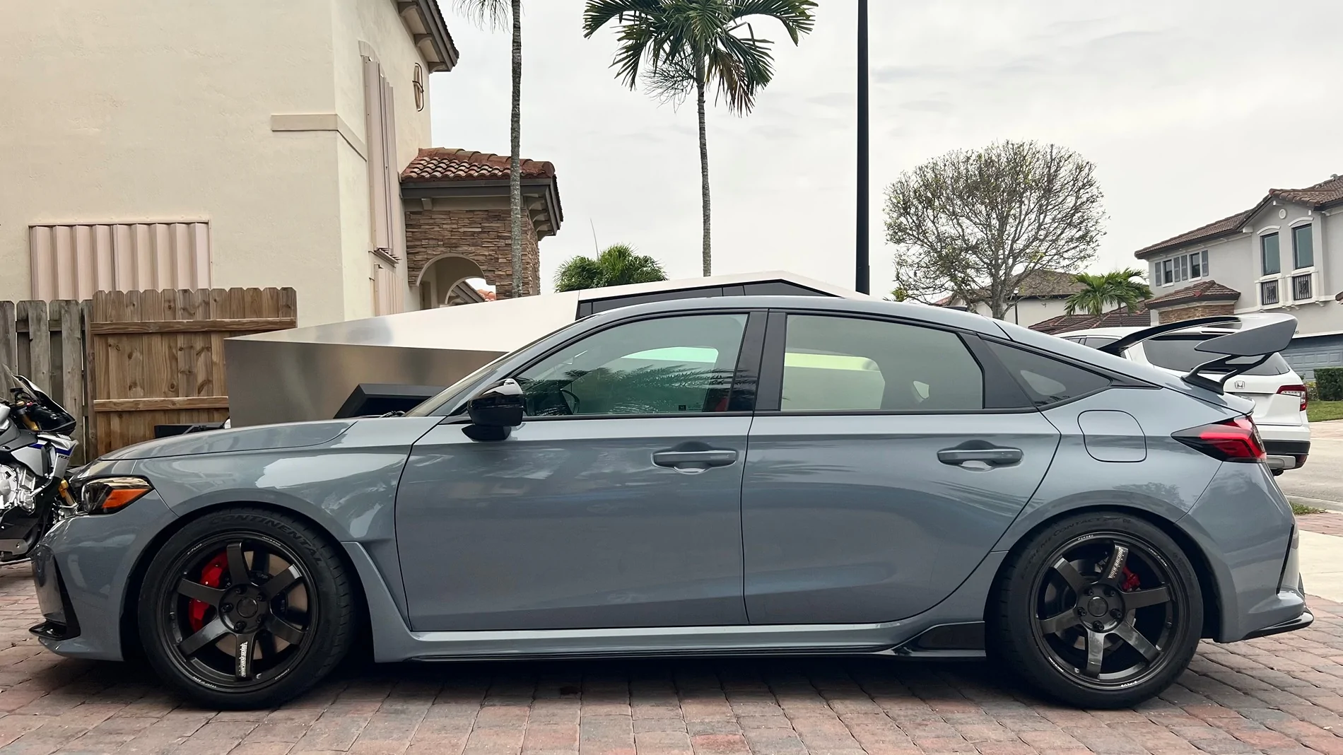

Lowered on Spoon springs, 275/35/18 Continental ECS 02.
This is the spec; I set my suspension on comfort and the drive feel is perfect.
no harshness at all, between the Contis, the Spoon springs, smaller wheels, 35 series tires, the CTR feels like a mature sports car that can do it all perfectly.
Hey Carlos, I just purchased 18x10 +40 TE37s. I’m really excited. I haven’t got the tires yet but also plan on getting spoon springs. Did you have any issue with rubbing? Long story short. I’m trying to avoid anything involving camber adjustments if possible.
