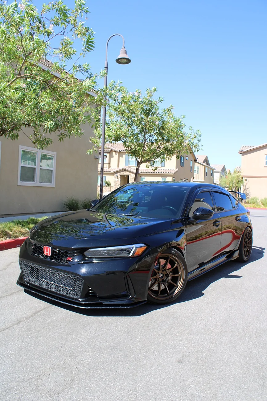

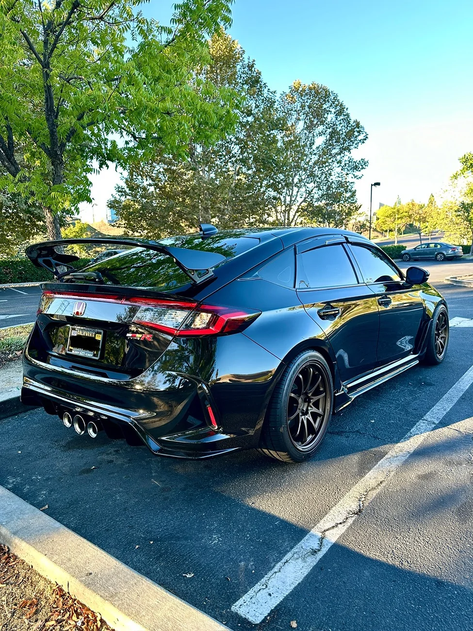

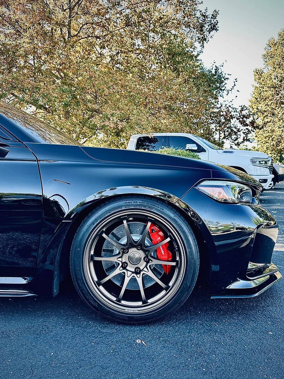

No mods needed. Just pull off the strut pins if you want a little bit more camber in the front. Most people run 275/35s with no issues.
If you go wider than 275s. That's when camber plates, camber ball joints, arms etc come in play.
