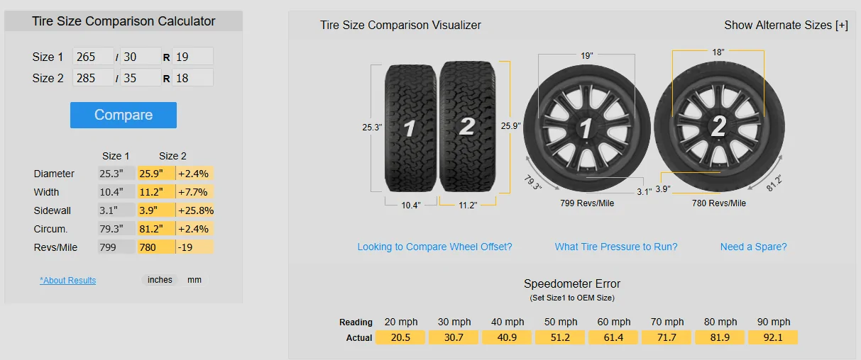

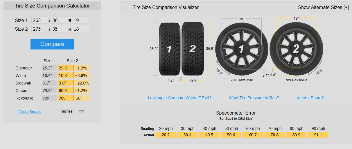

Comparisons to OEM spec. The 275/35/18 someone mentioned is much closer to OEM setup. Remember, the height of the sidewall is a ratio between the first two numbers of the tire size, not a direct measurement.
285
11th Gen Honda Civic Screw God spec. This is Thor spec. 1776612501701-po
275
11th Gen Honda Civic Screw God spec. This is Thor spec. 1776612788583-p3

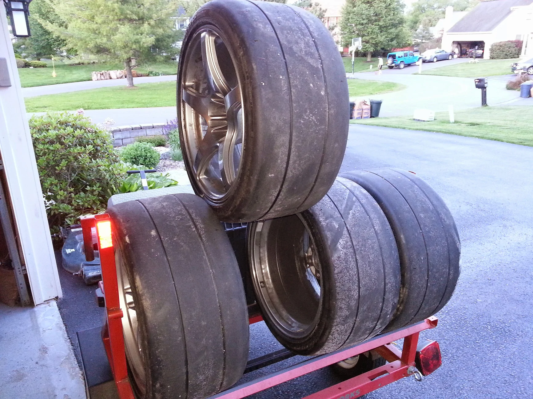

Side note on this discussion: Just be aware some tire manufacturers cheat on tire sizing (specifically width) so that you're better off just finding out what they list as the physical measurements of their tires to verify fitment. Back in the day I had a time attack/autocross Evo 8 I'd tow a custom built tire trailer behind, holding four wheels & tires for events. I ran Kumho V710 285/30R18 tires on some Enkei wheels for autocross that were used to size the width of the rack on my tire trailer. Eventually the Kumhos' value pricing advantage disappeared, so I started to look at other brands. Decided to try some BF Goodrich Rivals in 285/30R18 size. When I got them I noticed they looked wider than the old Kumhos, so I decided to test the four Goodrich tires in my tire trailer and found I couldn't get the fourth one in place. Each Goodrich tire was about an 1" wider than its Kumho counterpart. I figured a 285 width meant a 285 width. I called Tire Rack to discuss the issue, and they acknowledged the sizing didn't match the tire dimensions exactly and agreed to take the BFGs back, sending me a set of Hoosiers instead. Tire Rack said especially for competition tires that some manufacturers wink at the sizing as a way to gain a competitive advantage over their rivals. It's my assumption it's this that causes Apex Wheels to list specific tires in their fitment guide rather than just saying a tire size.

I didn't do the translation from inches to mm, but I know the Kumhos and Hoosiers were much closer to each other and the BFGs were a much larger outlier. Still, even the Hoosiers were bigger than the Kumhos, so all three 285s were different widths.
I remember stacking the BFGs and Kumhos side by side to show the difference, and the BFG stack was a good 4-5" taller.
Only found a pic demonstrating my tire trailer dilemma after the Hoosiers showed up. I had to have the guy who fabbed my trailer to modify the rack to accommodate the Hoosiers. Couldn't fit the wheels inside my Evo due to a full cage.
11th Gen Honda Civic Screw God spec. This is Thor spec. 1000017889
