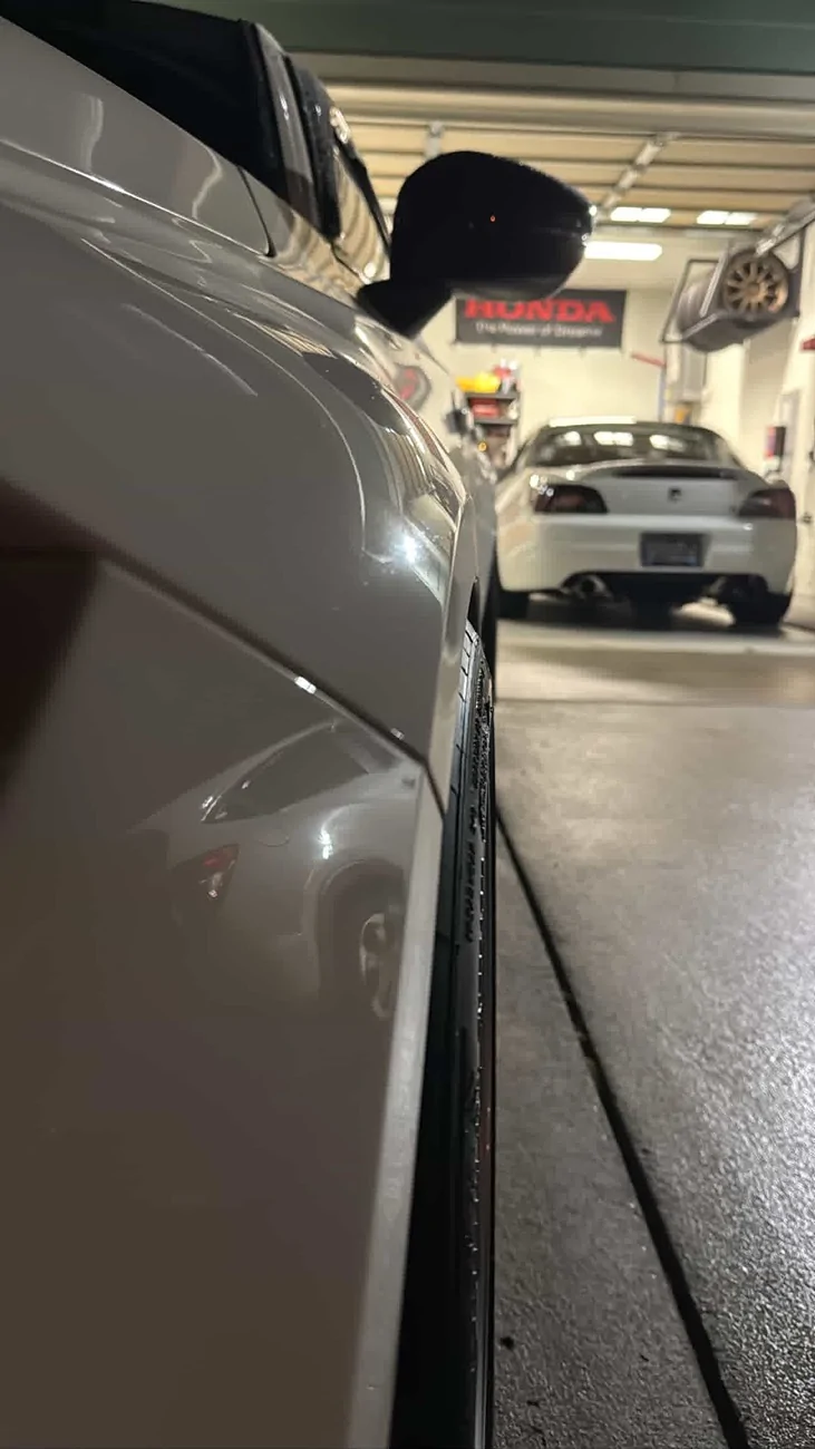

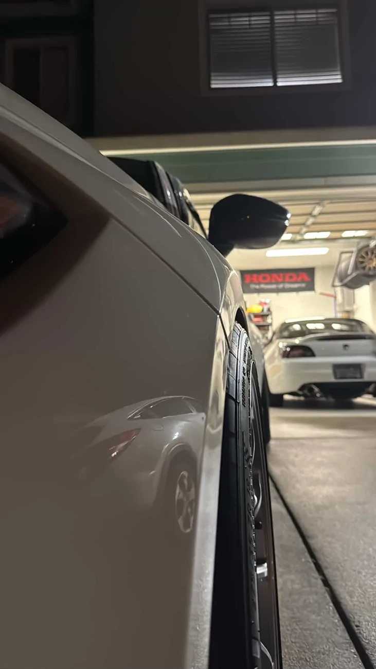

Sure, I get that but figured I'd try to at least close the loop. Just suffice to say this is the first (documented) data point of rubbing with this spec. It may or may not be relevant to most folks in this thread, but it is worth mentioning- and I hereby throw down the gauntlet for someone to step up and slap a set of 275 RE-71RZ on an FL5 to prove/disprove if it fits w/no rub or not.
Copy/paste from the update I posted on integraforums bc I'm lazy:
I said:
So verdict is in- the tires are just wide lol. The RE-71RZ appear to be on the wider spectrum even for 200TW, and likely run wider than their predecessor RE-71RS (*but note no measurements were taken so take this assessment with the appropriate grain of salt). So it is just a clearance issue. The bump stops appear to be cut correctly for the Eibach springs (which they fuckin should be, despite my existing reservations the shop that did them did have an established known good reputation).
That said the rubbing is extremely minor, and only occurs on very substantial bumps. Not anything I'm likely to come across during an autocross, but possibly a DE in certain conditions. It's just barely coming into contact with the felt/plastic liner so no damage is being done, just some extremely minor scuffing on the sidewalls, visible in the picture I shared above. Rears definitely more than fronts due to the extra camber. No other contact is taking place... and truth be told it appears to have actually mostly resolved already via "self-correction" from the tire wearing through the mm or so of liner. I noticed 3 "incidents" of rubbing on the ~1 hour highway drive to the shop this morning (so like <.01% of overall driving) - and absolutely zero on the way back. (Also the shop may have done some pressing/shaving with the fender liner but if they did it was minimal effort). I do have yet to run through my favorite bump that caused all this- but even still now that I know it's not actively hurting anything I think I'll just slow down a hair more when going over it on these wheels.
So TL;DR, it's just a "is what it is" situation that I'll just have to live with. With some input from a couple pros to I can live with that. Just chalk this up to the first known case to experience rubbing with the "god spec" configuration on 275 200TW tires, on the DE5 platform (which may have slightly less clearance than the FL5).
Oh and here, an angle I didn't post earlier bc you asked for more pics. Just pretend it's a civic:

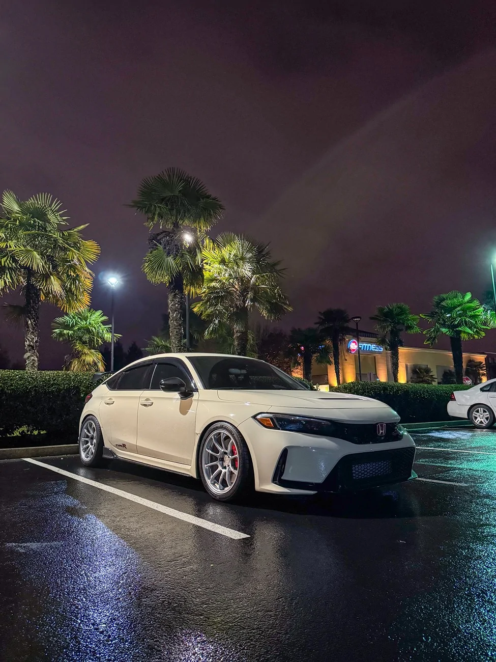

Most would say no. Without pulling the alignment pins, you should be at or under 2* of camber...which is within stock spec on an FL5.
Unless you're running a large/wide tire brand you shouldn't be rubbing. I ran a 275/35/18 Nitto 555 G2 on Sportline springs and didn't rub at all at 2* of camber all around.

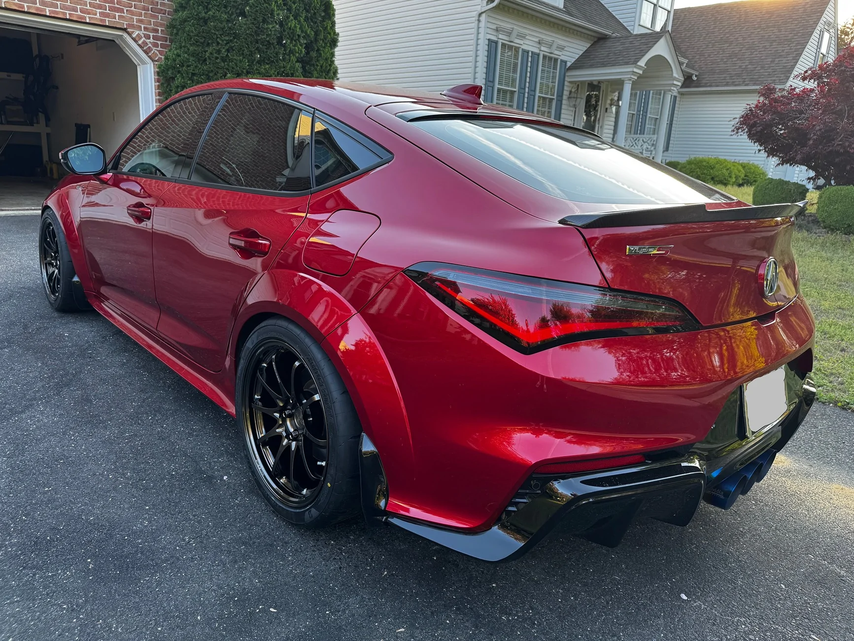

A quick update with my 275 Bridgestone RE-71RZ- after a couple months and 4 total autocross events, I can honestly say the tires no longer rub. Whatever minimal amount they were rubbing has been worn down- and I looked in the fender well and it was a matter of millimeters. There are no gashes or holes in the inner fenders, just a bit of polish honestly (also the tires had a few scuff marks as well). I was way more stressed out about it than I should have been in retrospect- and I'm almost positive that virtually no other tires would exhibit this behavior at all.
That said... l do have quite a bit of extra camber. But overall whatever crisis I felt like I was going through with the rubbing has been averted.
