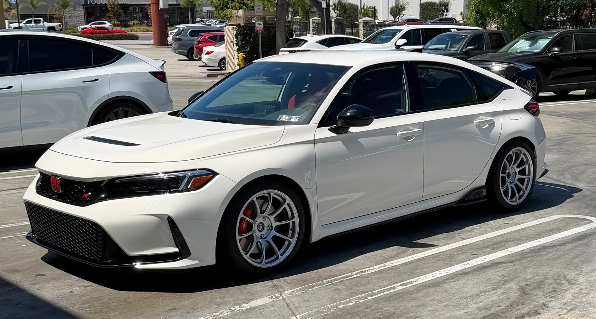

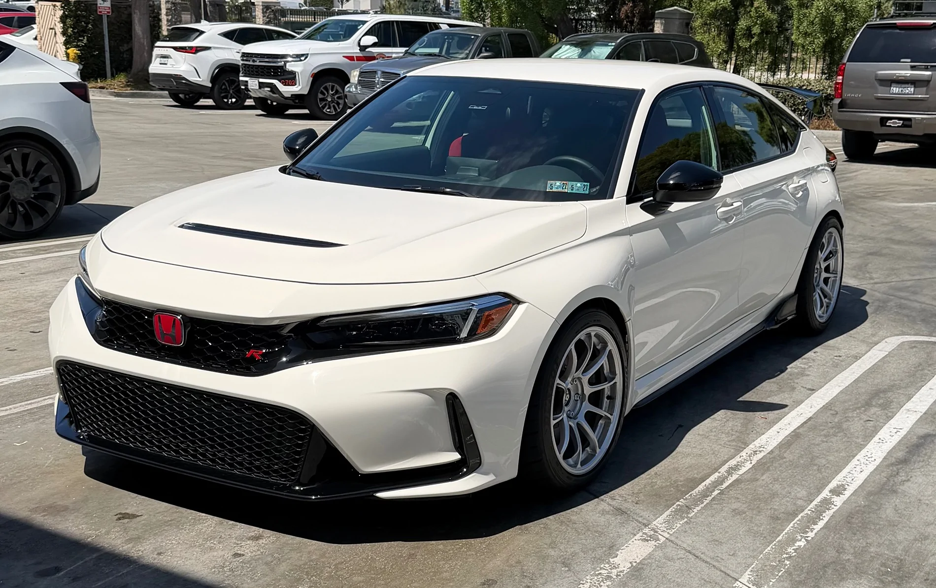

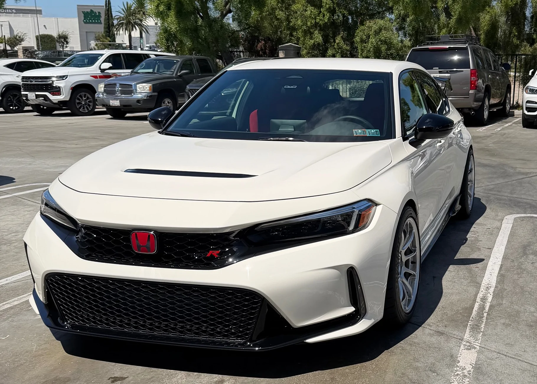

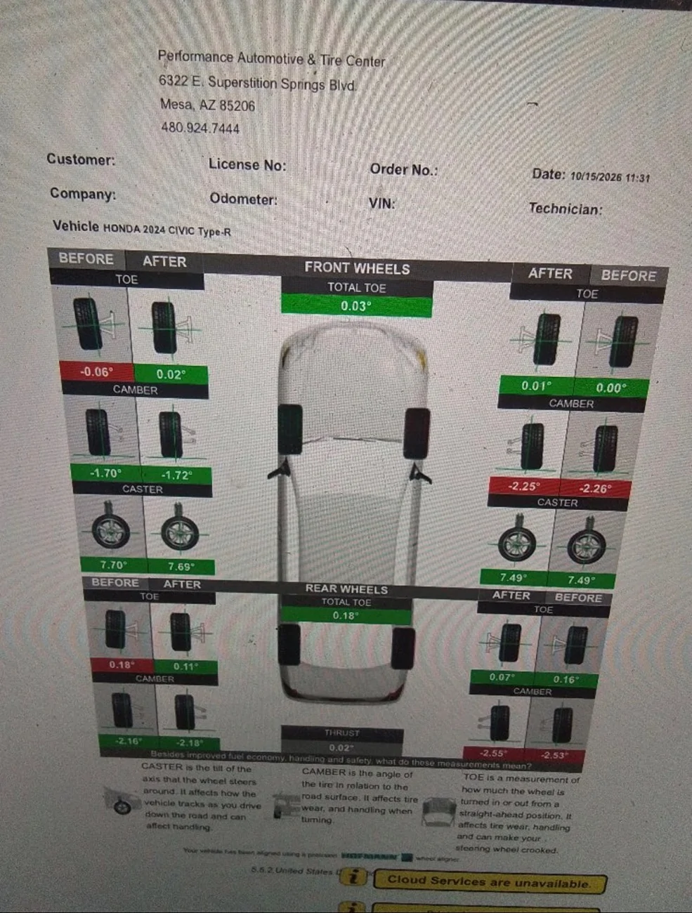

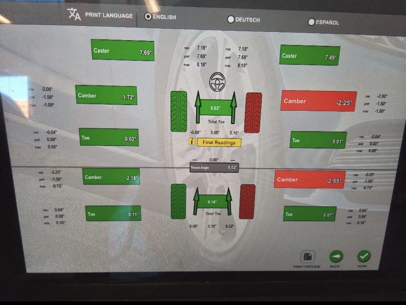

The consensus looks to be that the camber from natural drop and pulled pins will not rub with this wheel spec. I am also seeing some wheel poke from some folks and I'm looking to get it as flush as possible (in the front).
1. Does anyone have no poke up front without camber plates on a 275 tire?
2. If additional camber is required to bring in the top of the wheel, would increased negative camber from lower ball joints help with this or are camber plates required to induce the additional camber from the top of the structs?
