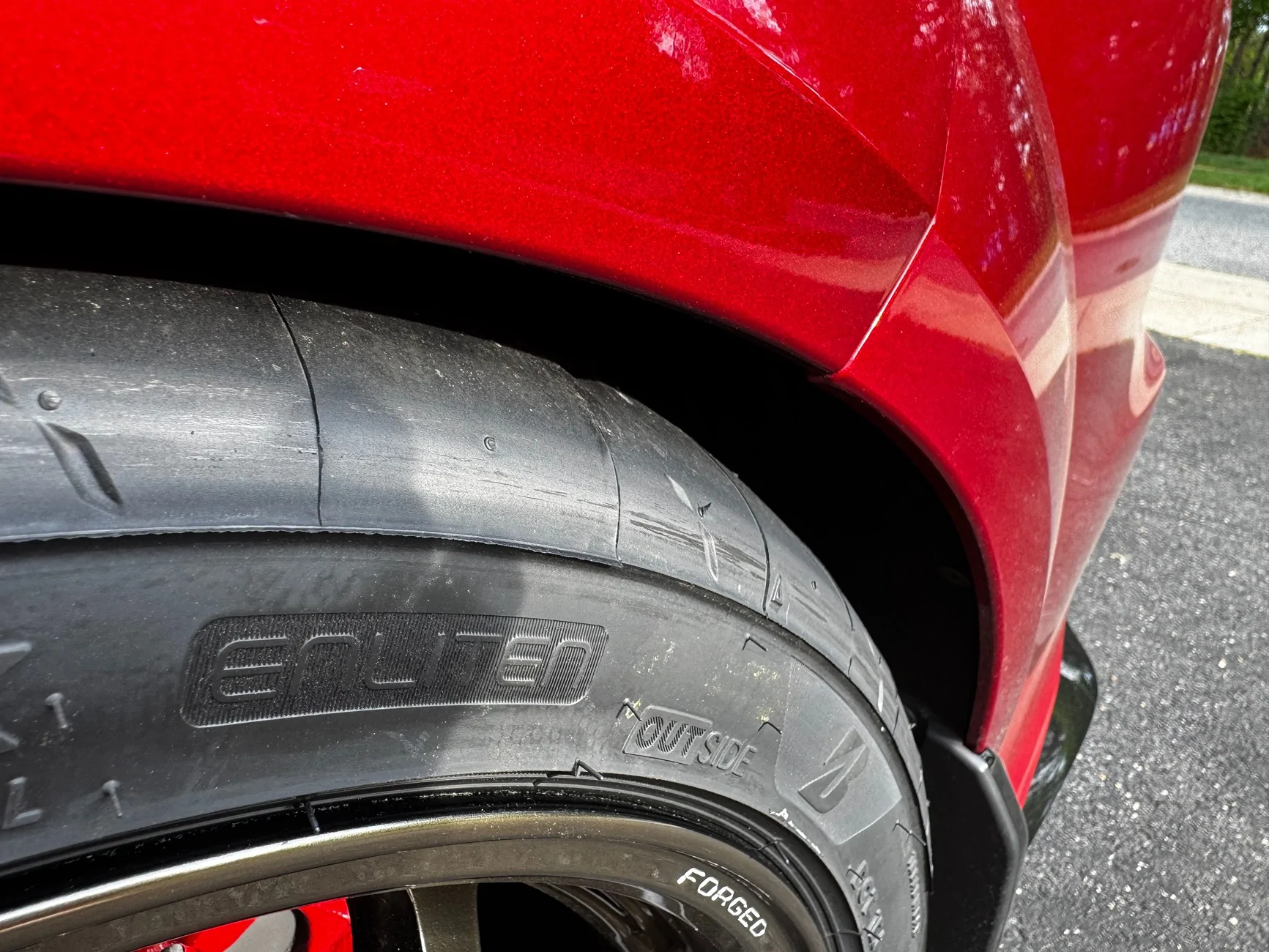

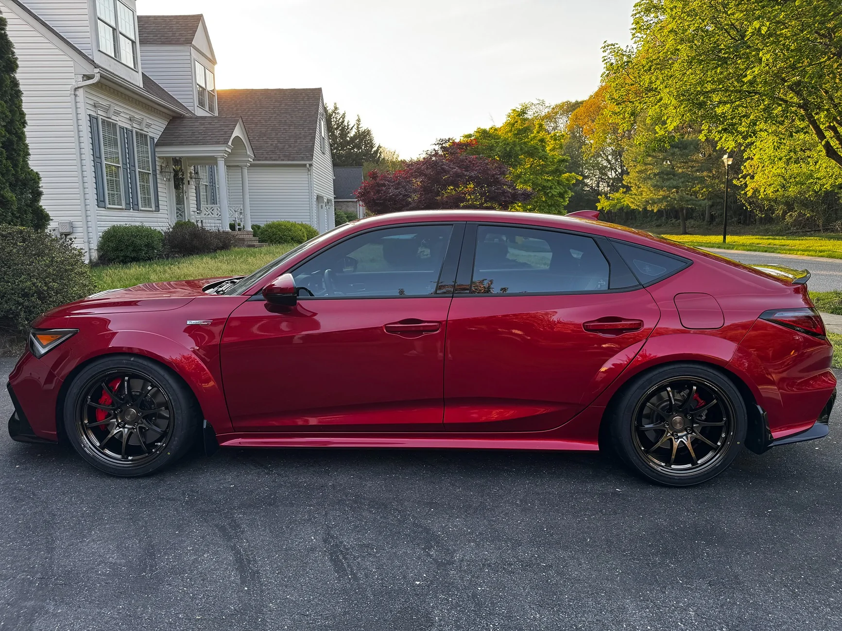

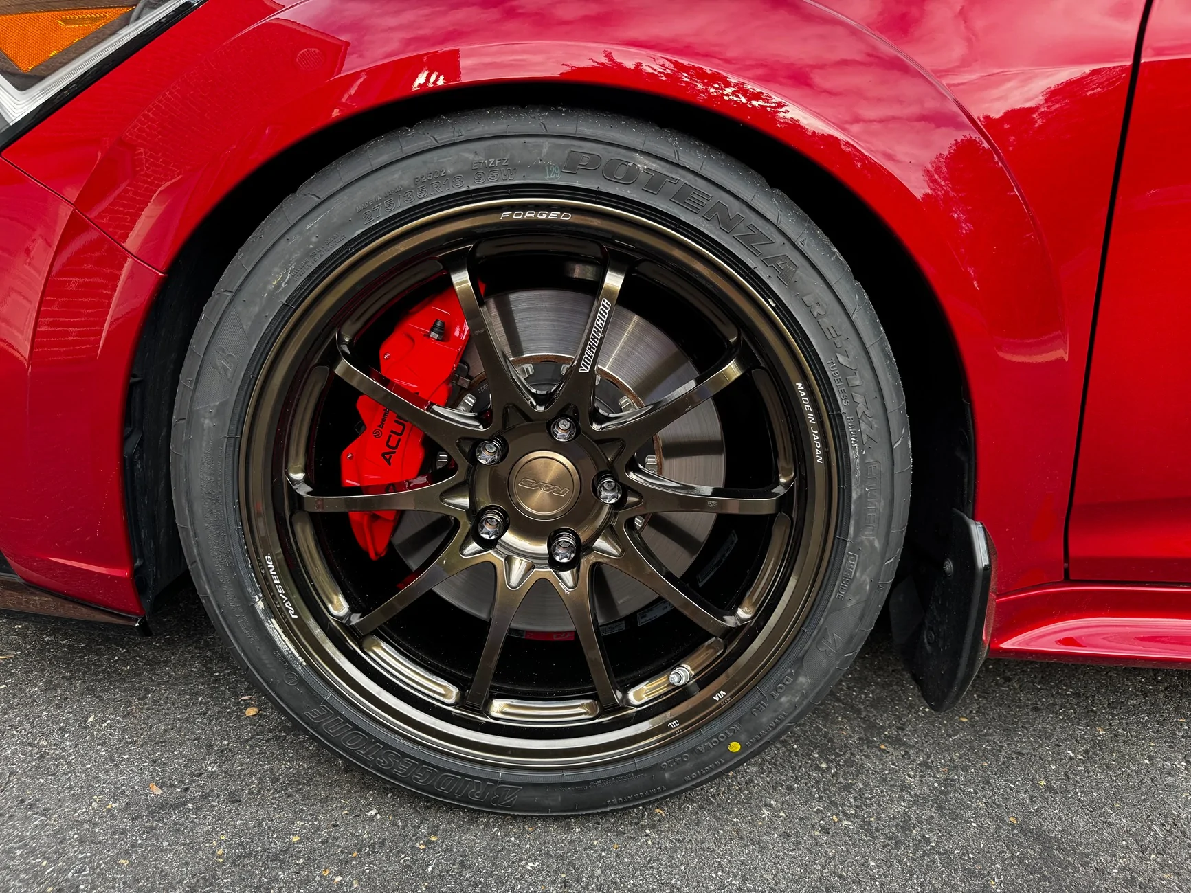

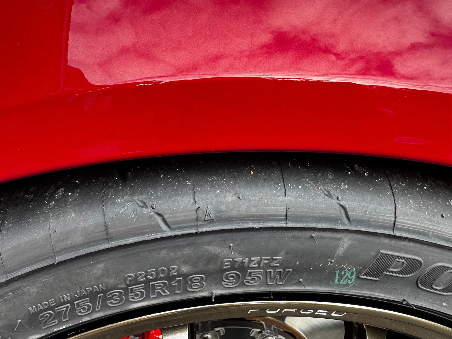

I know this isn't a Civic. But worth mentioning. It does rub, at least on comfort settings with the DSC. Only on very rough bumps but it rubs.
Eibach Pro-Kit
EVS ball joints -3.5 degrees front camber
275/35-18 RE-71RZ
DSC Controller OTS "lowered" tune

Damn, seriously? I'm surprised. All 4 corners? Front? Rear?

I’m surprised as well. Maybe it’s the DSC but generally that set up doesn’t rub especially with -3.5 of camber.

It's worth exploring, maybe my car is an outlier. Also the DSC makes sense. This was just on a test run, I literally just took it for a spin, I'll be doing more in depth troubleshooting today - but I should also note that this sequence of bumps is NASTY. Like, nearly airborne at 40 mph. But it does not rub with my Apex 19x9.5+45/OEM PS4S setup and that's all I changed yesterday was the wheels.
Sounds like it's probably all 4, but honestly it might only be coming from the right side? Sound can be deceiving inside the cabin. It's also worth mentioning I nearly disintegrated a single tire last fall on the right front during an autocross on the Apex setup but with 275 Falkens, and I don't really have an explanation for it. I chalked it up to a defective RT660+.
In any case I'm convinced I must do coilovers now and continue to throw money at the problem. First stop though is an alignment; probably not related but I've been meaning to get one anyway to see if the toe contributed to melting that tire.
I'm guessing no one else has run this setup with RE-71RZ yet? Maybe the tires are just extra chonky?

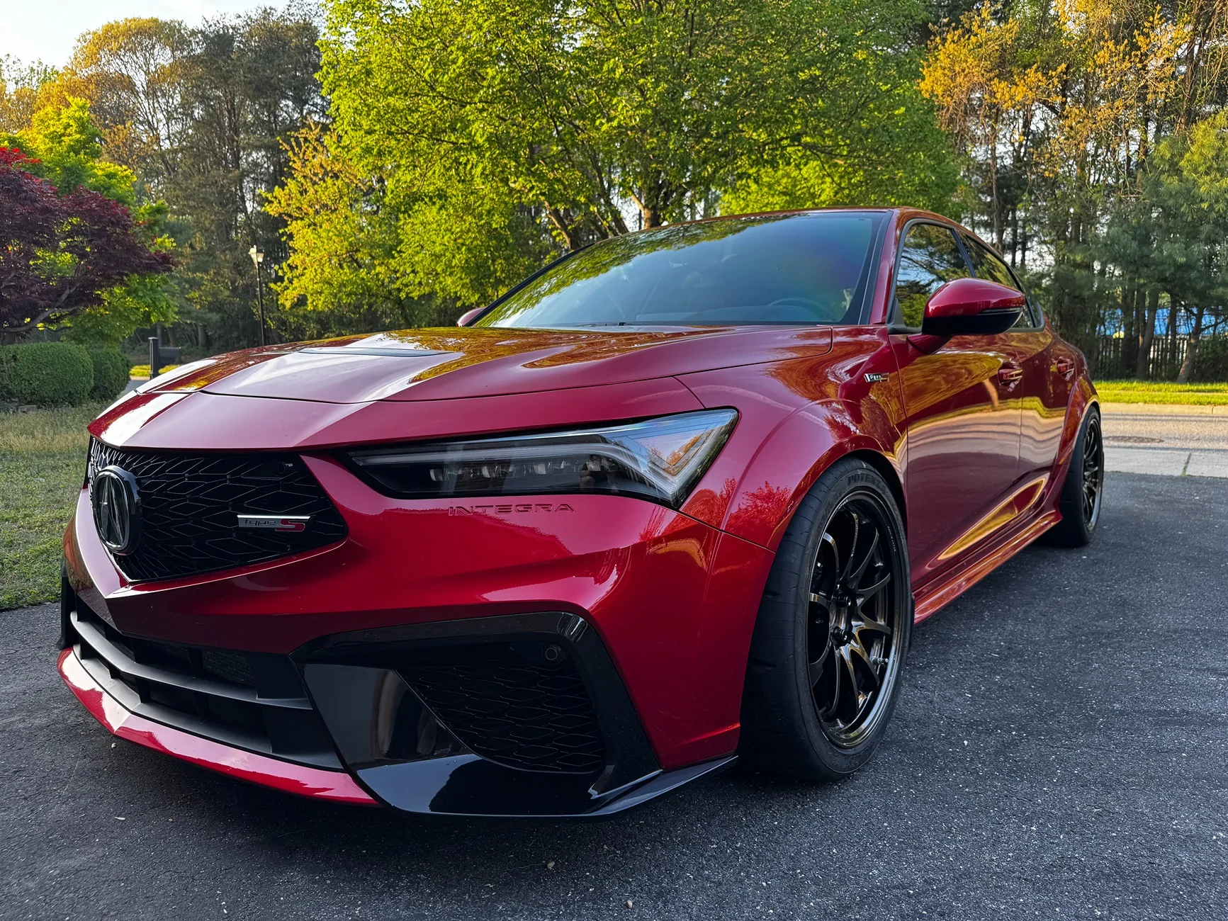

UPDATE: still rubs set to Sport and Sport+, all 4 corners. Seriously WTF. Appointment set with my performance shop for Monday to start exploring this... and probably roll the fenders?
Disappointed to say the least. First autocross of the season was this Sunday, that's not happening now.

Are the type S fenders factory rolled like on the FL5?
Our fk8 rubs like that on big bumps with 18x9.5 +40… only in the rear, but the fk8 fenders aren’t factory rolled like on my fl5.

There is something going on here. DE5 fitment *should* be the same as FL5. Unless as scottjua mentioned earlier if the fenders (like FK8) are flares and its rubbing on some plastic. Although I havent inspected a DE5 that closely on the fenders in person since at the shop.

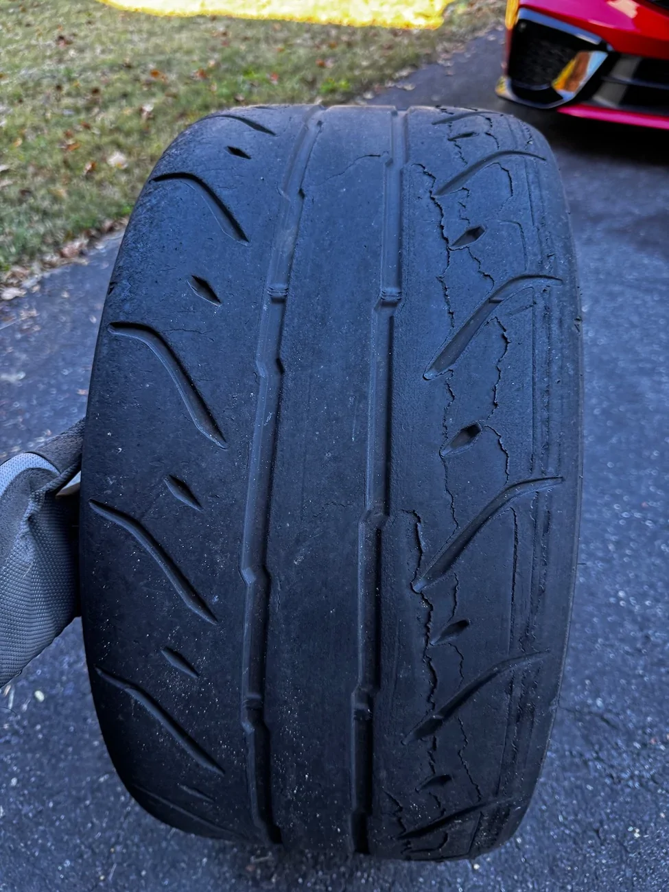

that looks like a pretty common RT660 problem
the rubbing you say you're experiencing is from "nasty" bumps - which I'm going to guess are unlikely to be part of your autox course...
if you're only rubbing going over insane bumps that you wouldn't take at speed with your family in the car or coffee in your lap anyways... then is your rubbing problem actually a problem?
either way, you're going to get it fixed on Monday. to me this sounds like a minor issue that may not even be an issue during your autox.
if you're rubbing constantly going down the road normally, which would cause your tires to be shredded by the time you get to your autox 1.5hrs away... that's a problem.

Thanks for the response, helps lighten the mood a bit because honestly, I haven't really experienced rubbing on cars in the past so I didn't know what to expect. I hear you and this is consistent with thoughts I've had... And it's good to get a bit more validation in what I had suspected was just a faulty RT660.
It's just beyond my tolerance for bullshit at the moment, and if I did happen to shred a set of tires it would in all seriousness probably push me past the deep end and I'd sell the car. I've had moments like this in the past that literally ruined my relationship with vehicles I've otherwise loved. The one that most vividly comes to mind is I "dropped" an R6 I'd owned for 4 months WHILE TRYING TO PARK IT- I mean, it grazed the ground with me actively pulling it while stationary- doing nothing more than barely scraping the muffler and fairing. I put it up for sale the next week.
