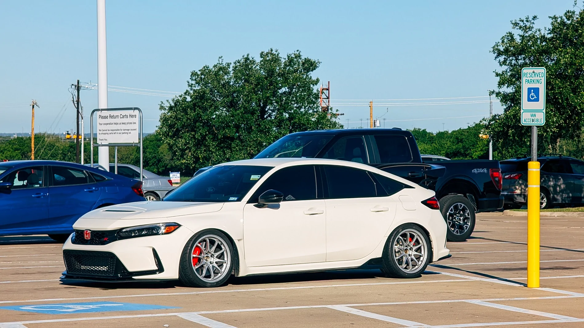

Looks great. Got project aero splitter on the front too
Looks like you're on a slope, so wheel gap probably isn't what it normally looks like, but you're on coils so nobody is going to compare the drop.
