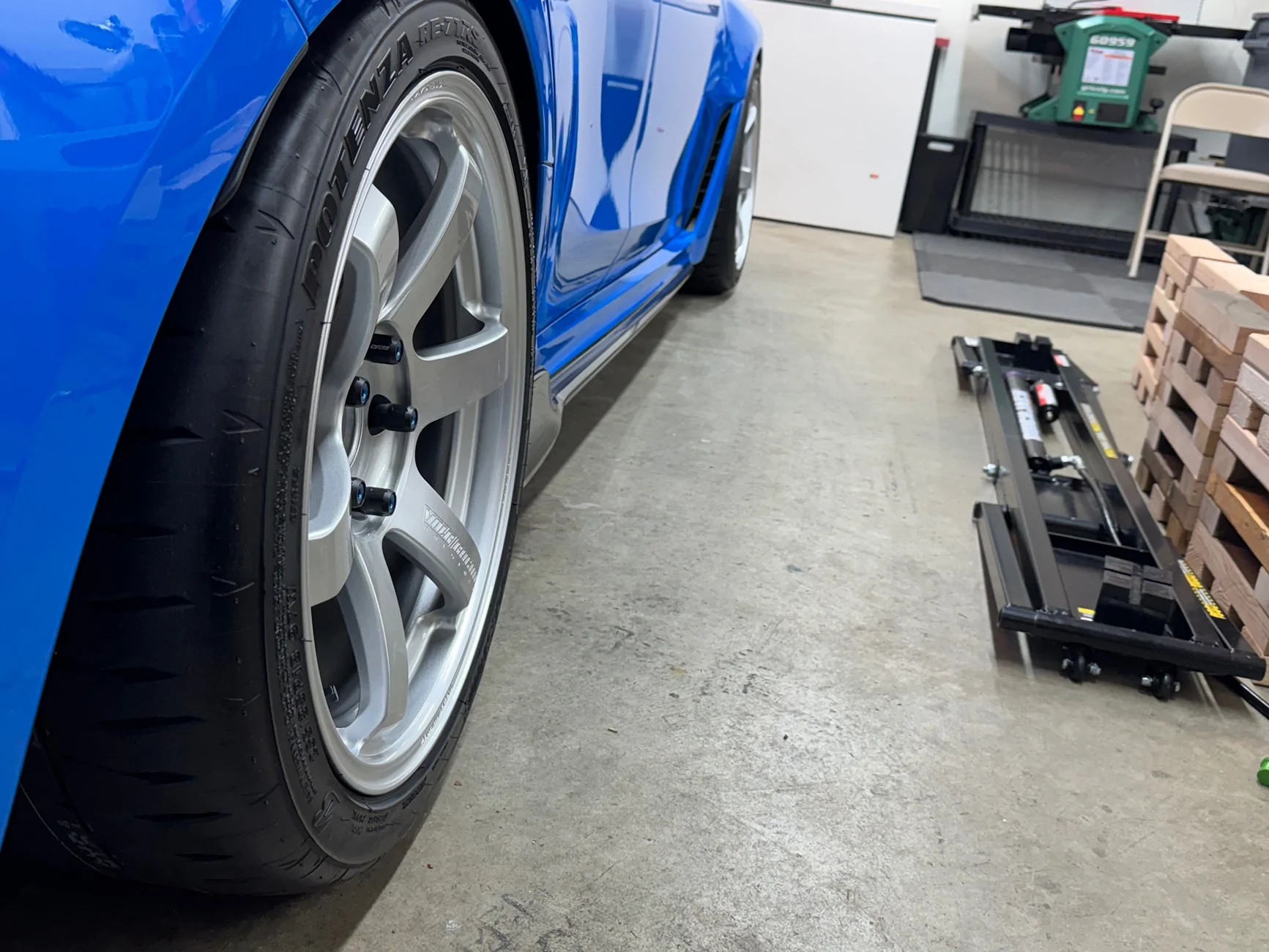

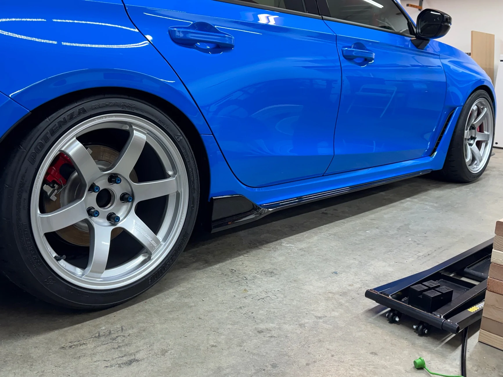

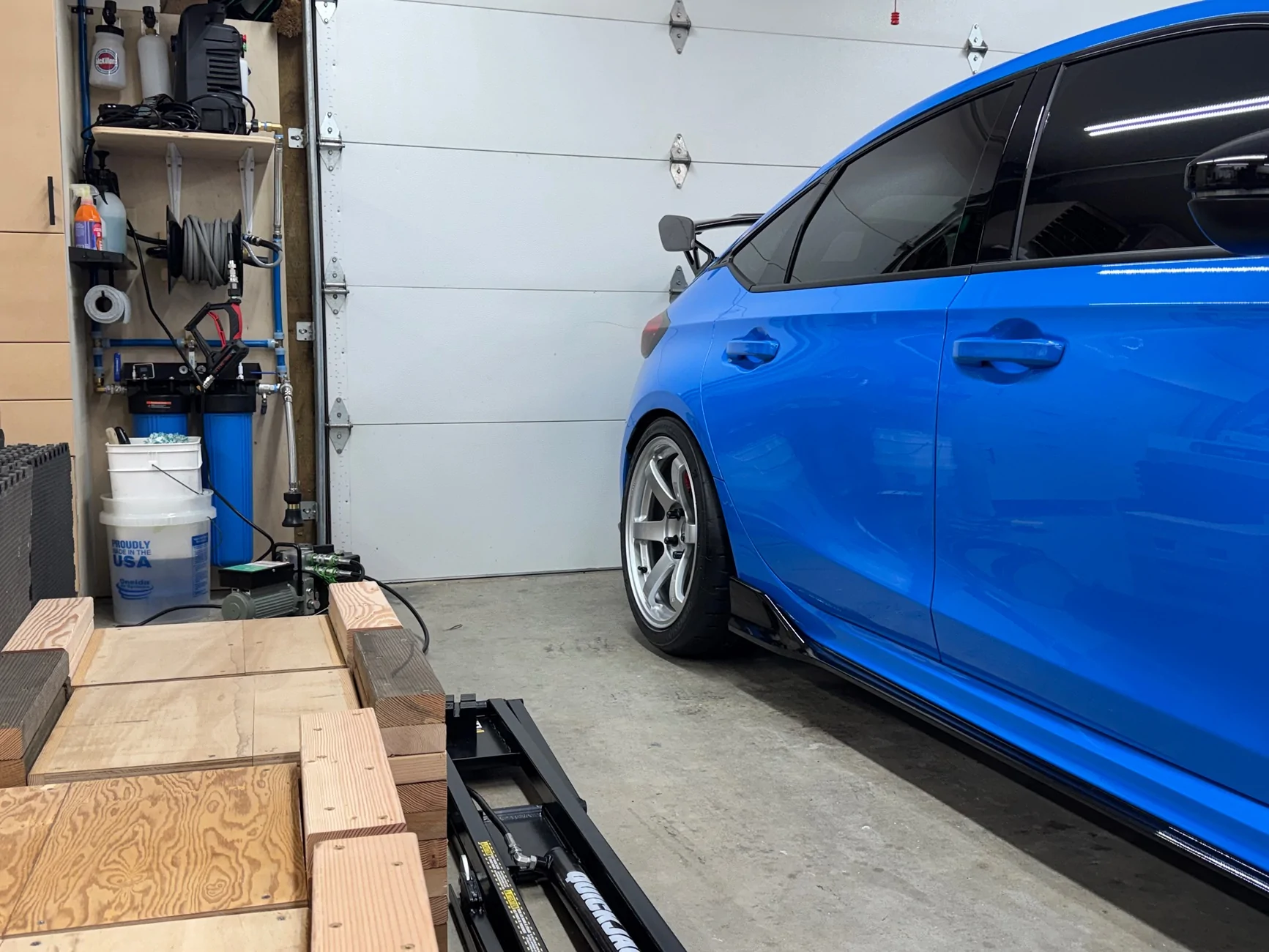

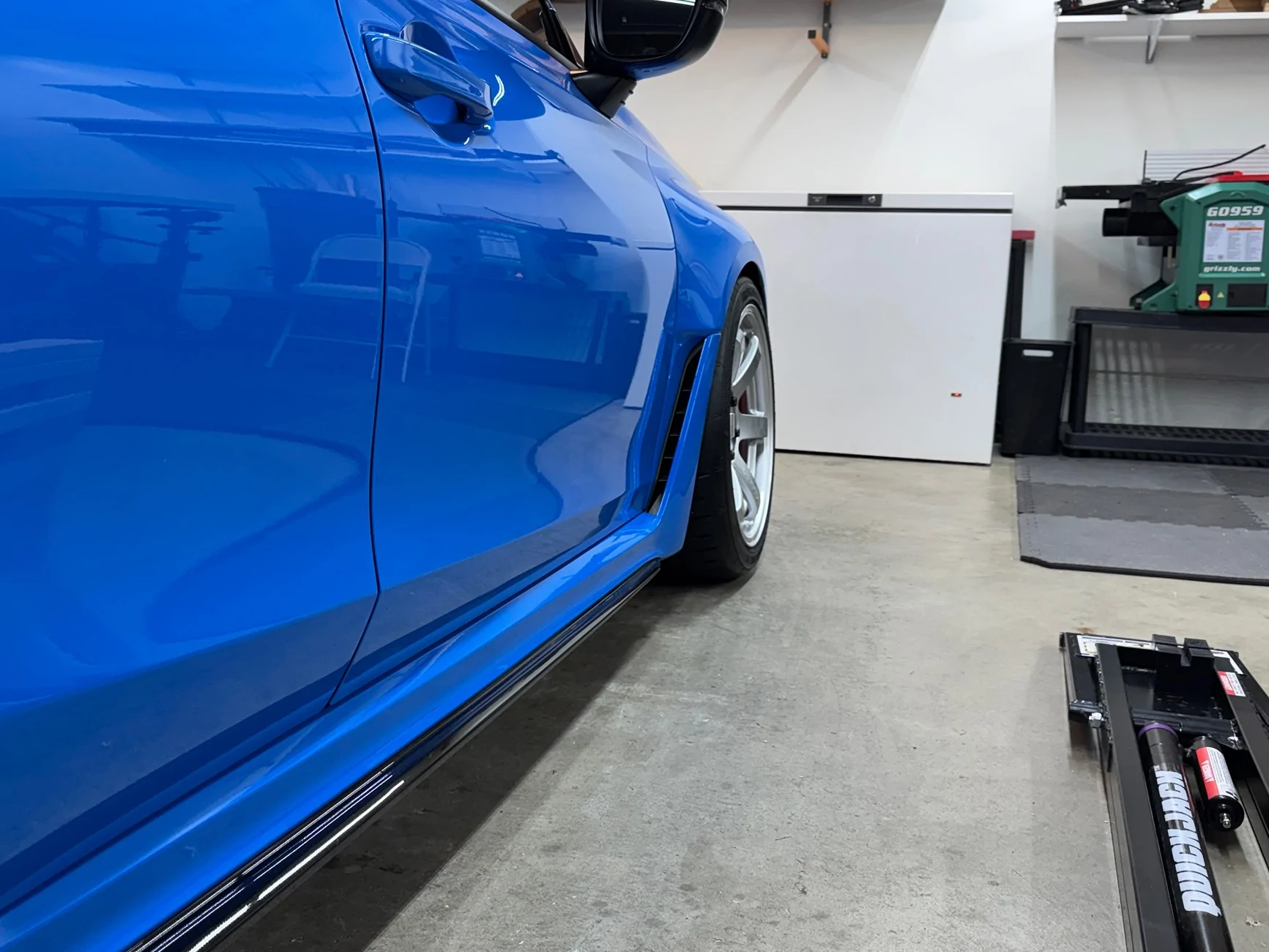

Finished coilovers, LBJs, and rear upper arms. The weather is improving so decided to put on the TE’s. Still need to put rigid collars in, dial in the height and get alignment next Monday.

Which coilovers?

RSR active coilovers (used the negative camber position)
Whiteline LBJs (currently on middle setting)
Whiteline rear upper arms (currently set to stock length)
PRL collars will go in this weekend - wish me luck!

How much camber are you running in the front?

Not sure how to measure that accurately at home. The RSR negative camber position gives somewhere between -1 and -1.2 according to the manual, and the LBJs are supposed to be -1 at the middle setting but they also say “up to -3” so perhaps middle is -2? My digital angle tool says -3.5 currently if I put it on the rotor. Alignment on Monday.

Do you have the adjustable tophats for the RSR coilovers (up front) or is there a "more camber" setting available without them?

On the RS-R coilover without the adjustable pillow-ball mounts. You can turn the top hats 180° for more negative camber.
Oh wow, I wasn't aware of this. Thanks for the heads-up!
