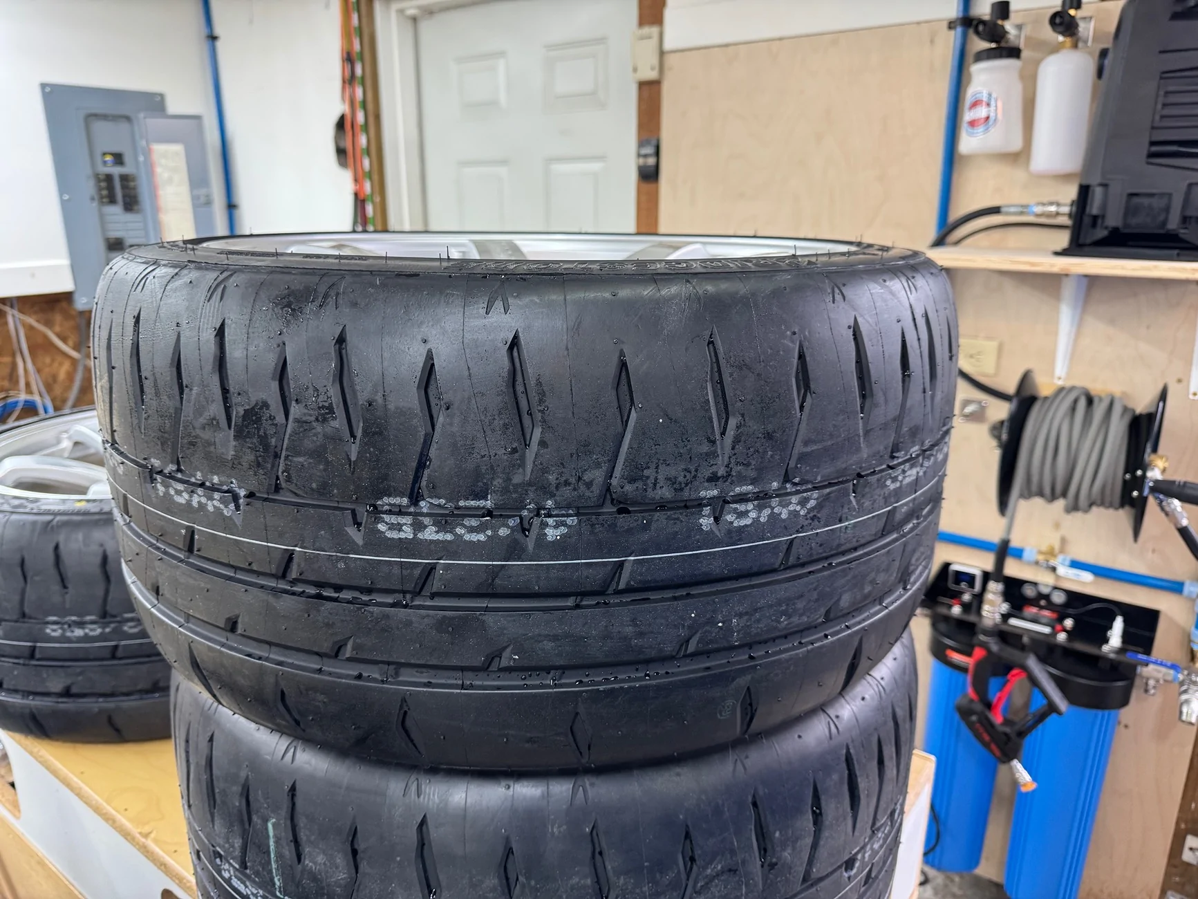

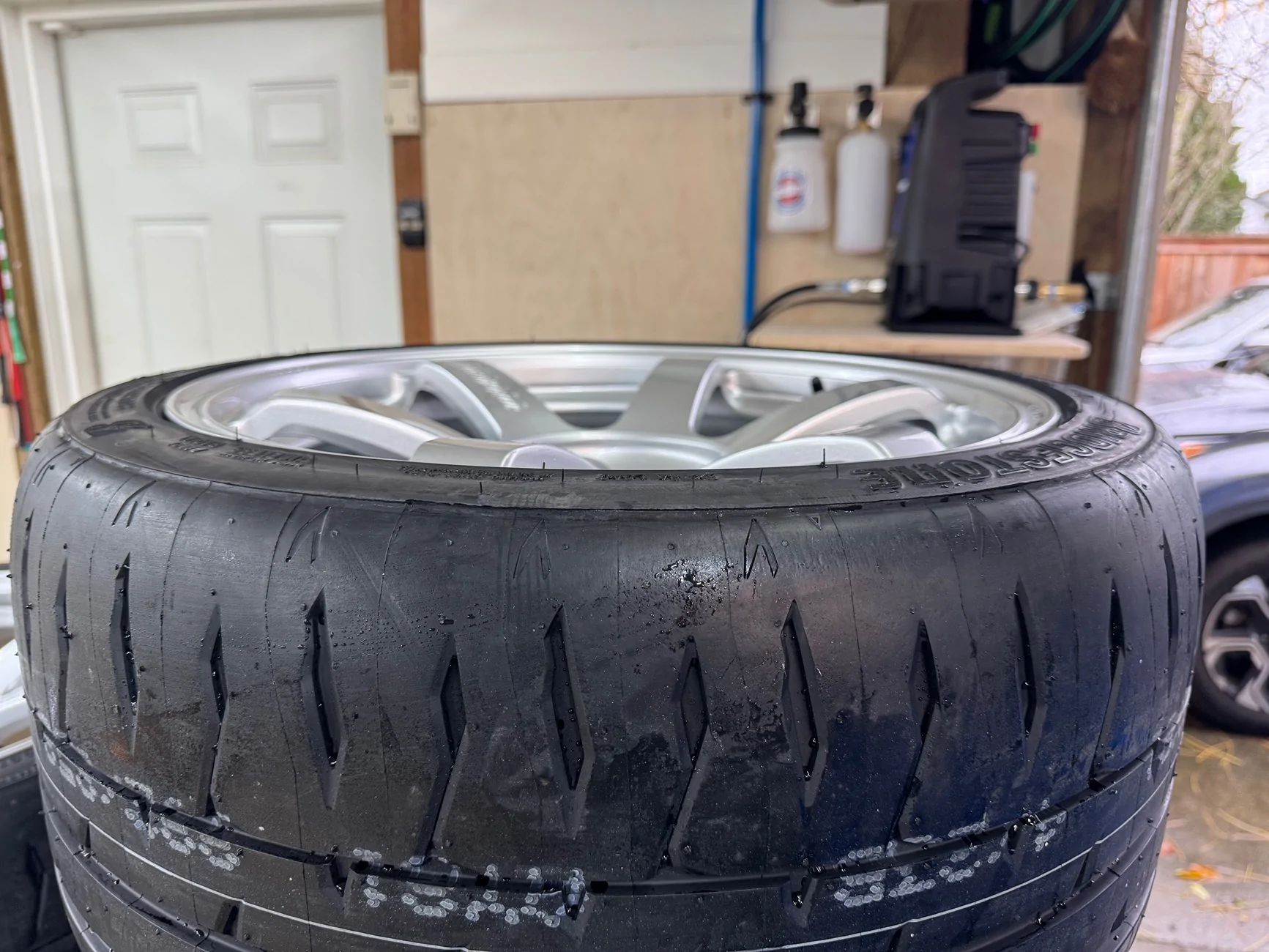

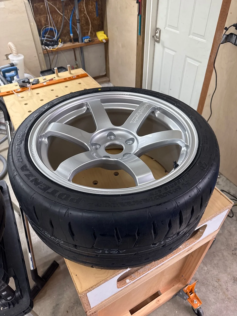

Thanks to everyone on this thread for posting information. I went with the below combo and am really happy with the square look of the tire and how flush it is with the wheel. Will be going on a BB FL5.
TE37 Saga S-Plus 18x10 +40
RE-71RS 265/35/18
RE71-RZ coming out in 15 daysssss. Shoulda waited! Hopefully see you at the track next season!
