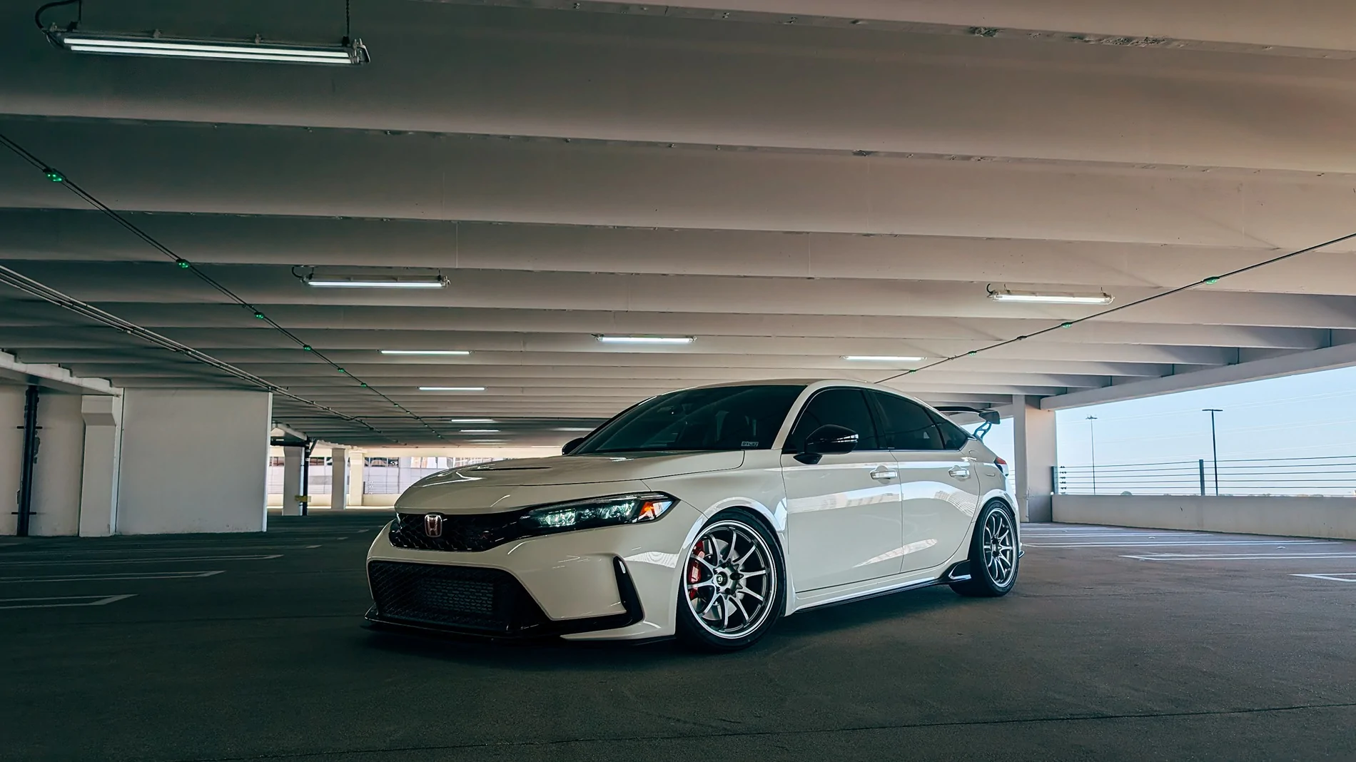

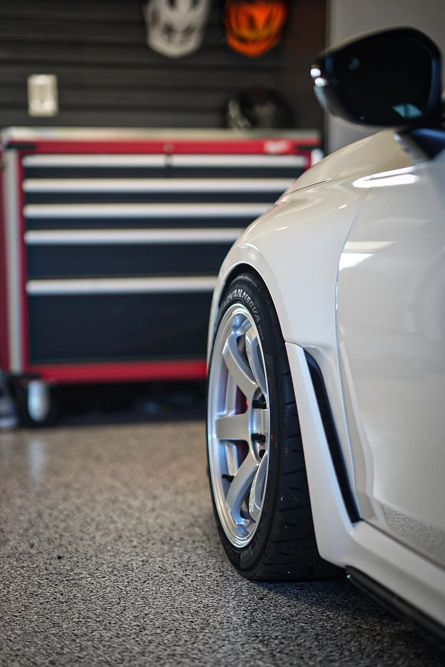

265/35 Yokohama Apex v601 on an 18x10. Definitely a slight stretch. I will go 275/35 on the next set.
275/35s are much more limited for options in that size sadly. I've also *heard* 295/30/18 is a good option too.

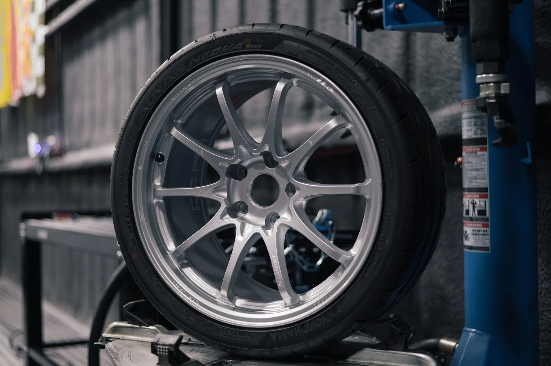

Thanks to everyone on this thread for posting information. I went with the below combo and am really happy with the square look of the tire and how flush it is with the wheel. Will be going on a BB FL5.
TE37 Saga S-Plus 18x10 +40
RE-71RS 265/35/18
