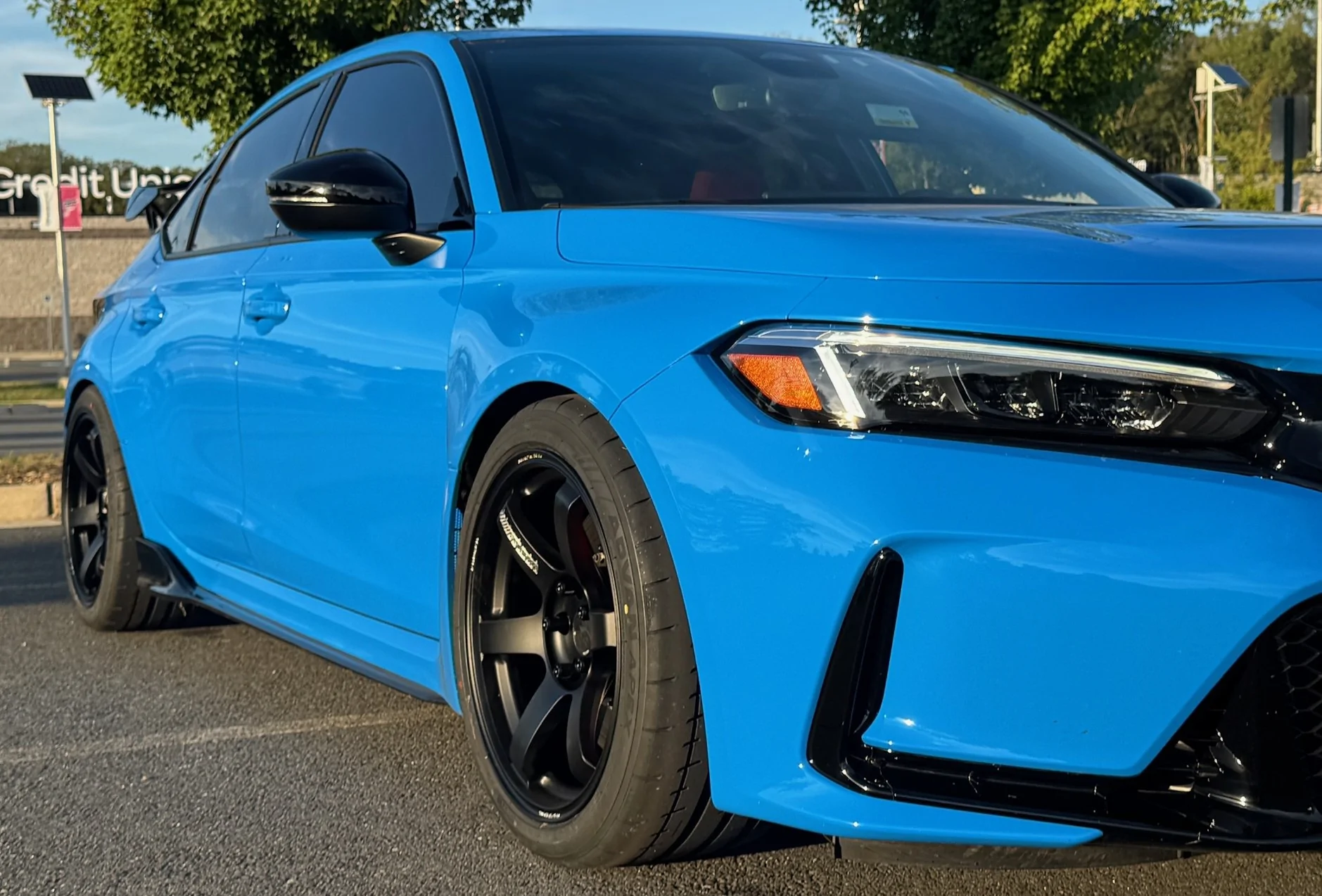

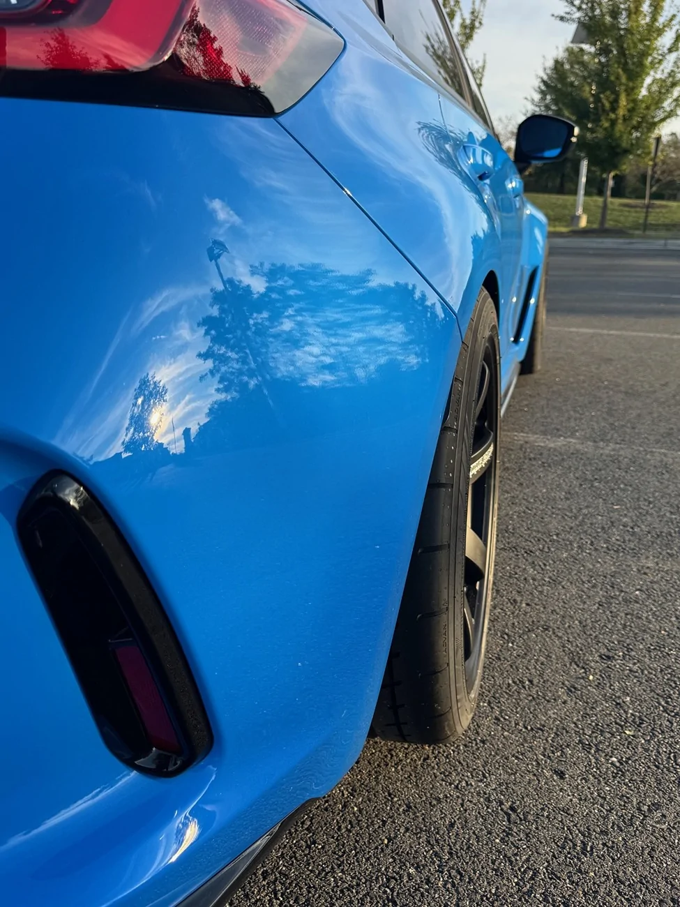

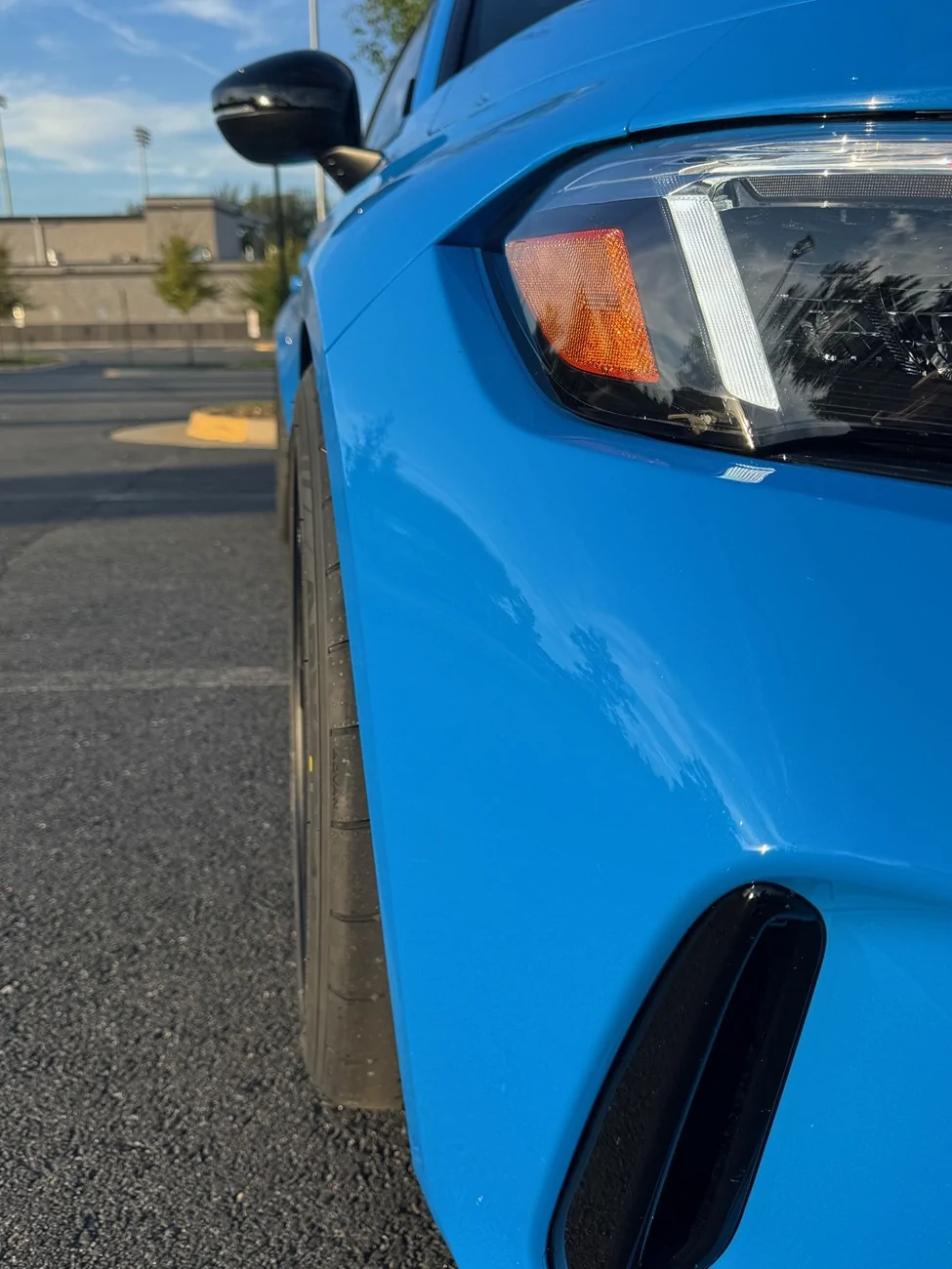

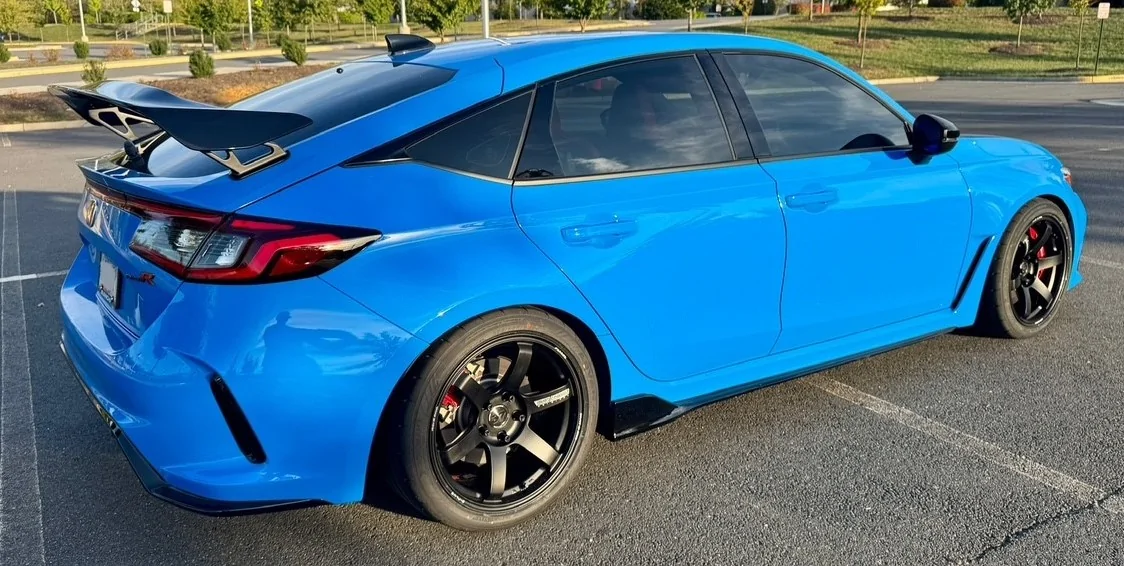

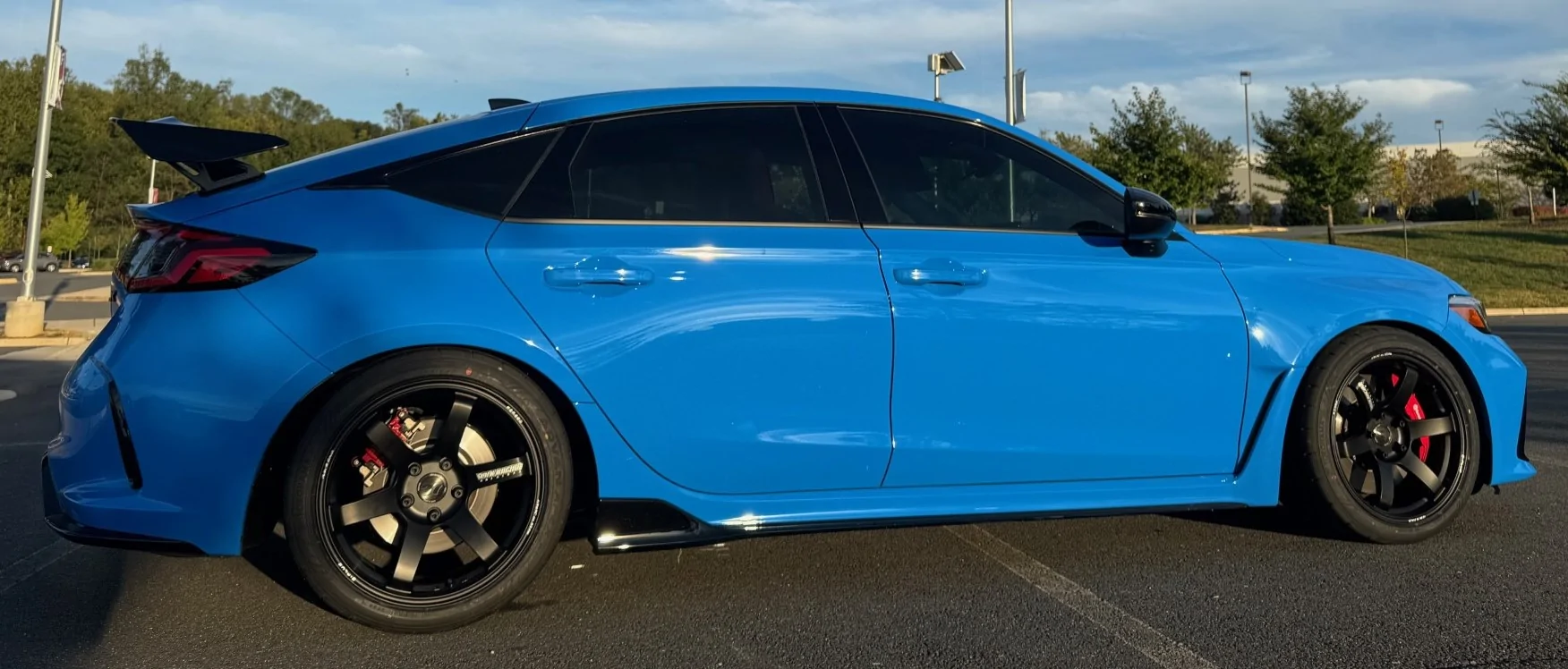

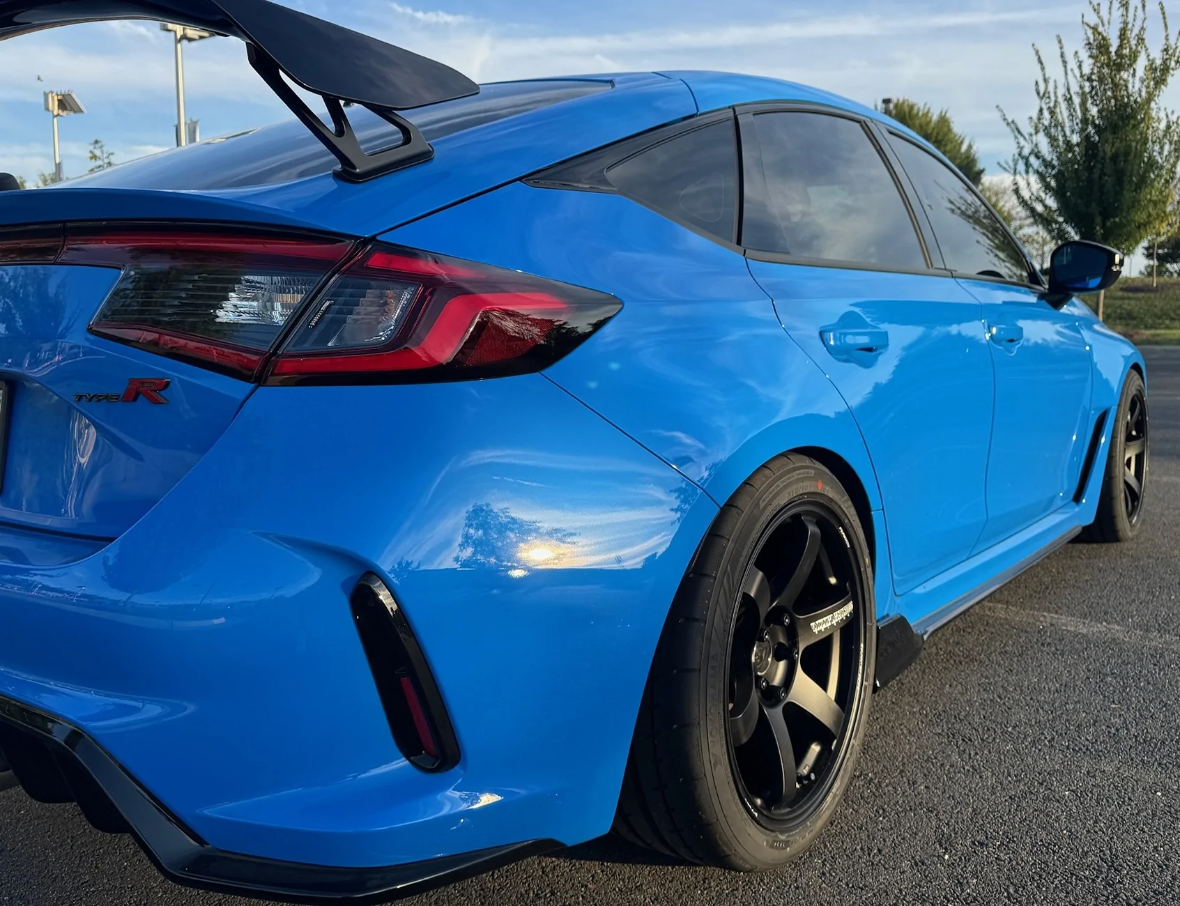

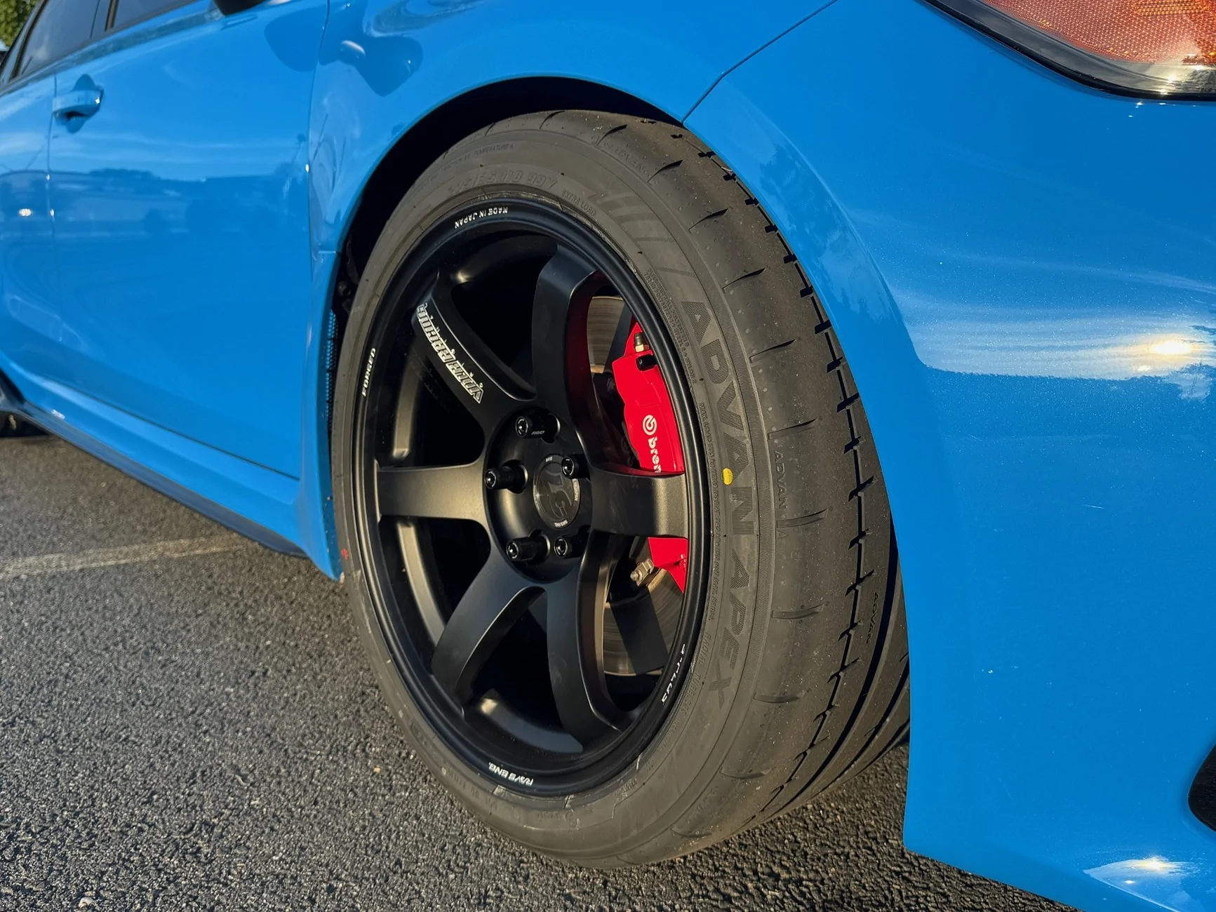

-Spoon Springs
-275/35/18 Yokohama V601
Have never done this before (downsizing in wheels from the oem size), but digging the 18"s and meatier tires look. Took about 4.5 months from time of ordering from Garage IMMI (whom did a phenomenal job of keeping me posted on their shipment status) to reach me here in Virginia. Think I did right with matte black as the bronze color clashes with Boost Blue imo.
Anyhow - factory alignment specs and alignment pins are still intact - zero rubbing whatsoever. Car def rides smoother with the 35 series V601 tires, but only complaint is the super sharp steering response that the 19" OEM PS4S tires had is now toned down (guessing due to thicker sidewall and softer than the PS4S tires).

Anyone with Swift/Eibach Pro/Spoon springs have passengers in your car often and have any tire rubbing issues?
18x10 +40 Advan GT Beyond
265/35/18 Mich P4S
Since you got the Swift spring answer I can now answer the question from the Spoon springs side. Last night I drove with 4 normal sized adults in the car. Mobbed all around town at freeway speeds in all types of situations.
No rubs whatsoever.

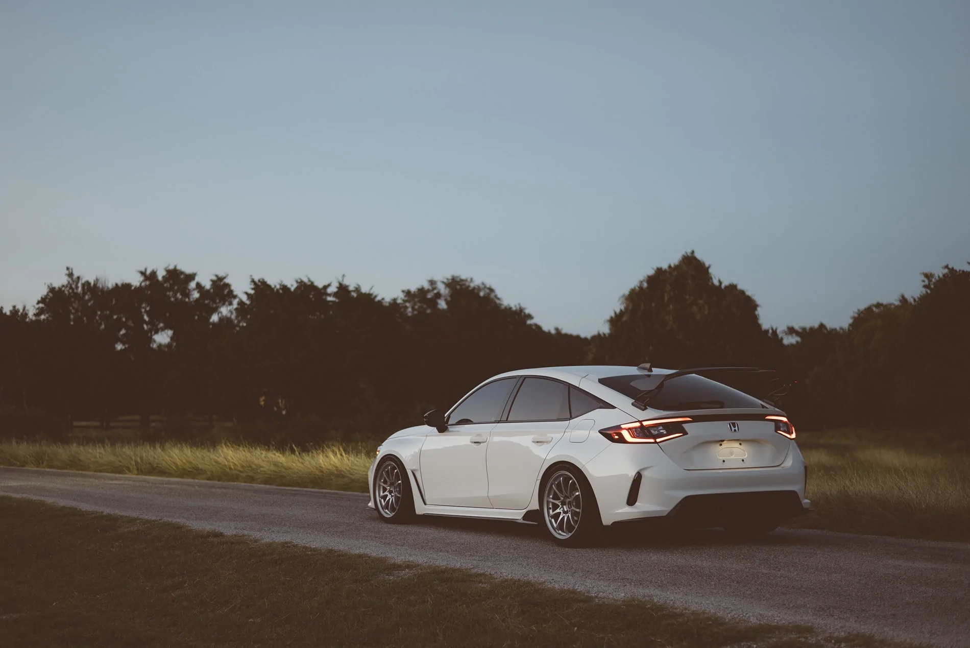

285/30/18 AD09. Pretty square on the wheel.

Haven't seen anyone else running 30 series on 18x10's - how is it? Any rubbing? Looks like maybe sportline springs?

Ohlins with shorter swift springs. Its lower than sportlines by about .5" up front (about 1.75" drop total). Also -3⁰ front camber, no rubbing.
