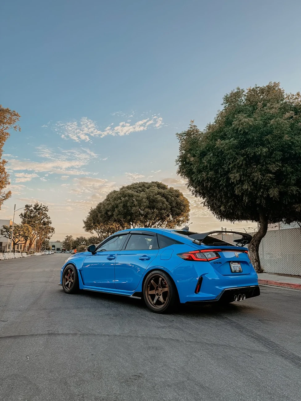

Figured I'd add mine in here too! been hoarding this set for a while.
18x10 +41 TE37 OG in OG Bronze
275/35/18 Michelin PSAS4
H&R springs, EVS front camber joints. No rubbing at all
Been on the hunt waiting for a set of the OGs to pop up since I got my FL5 in 2023 lol
