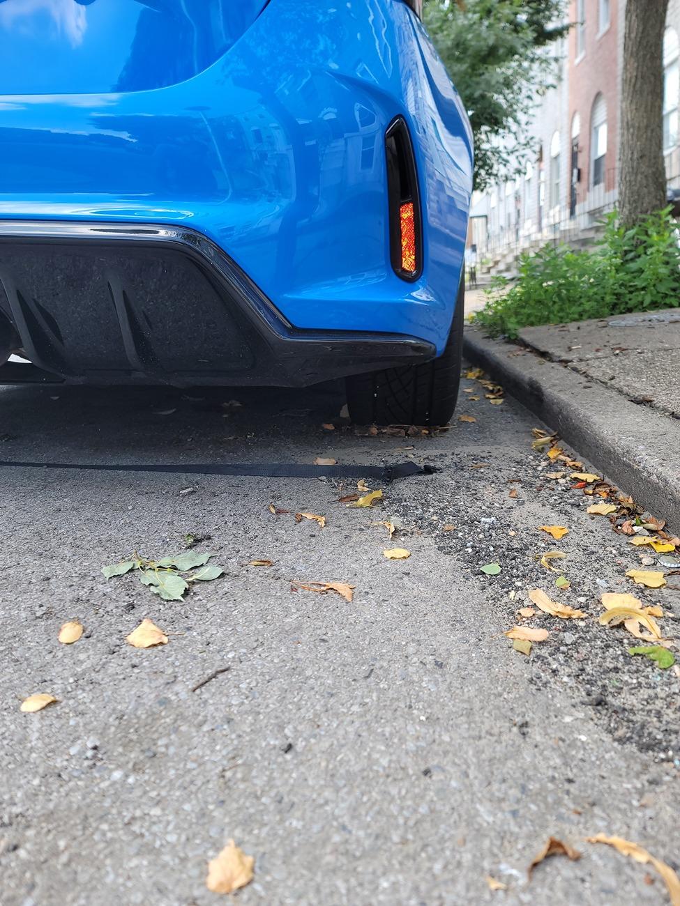

Anyone have experience with this? How does it look?
I changed to 265 35 19 (on stock wheels) Continental ExtremeContact DWS 06 Plus after blowing 2 of the OEM tires. The potholes in the DMV area are killer. Looks the same to me but definitely a different when hitting bumps. More tire so more cushion. OEM tires handle better.
