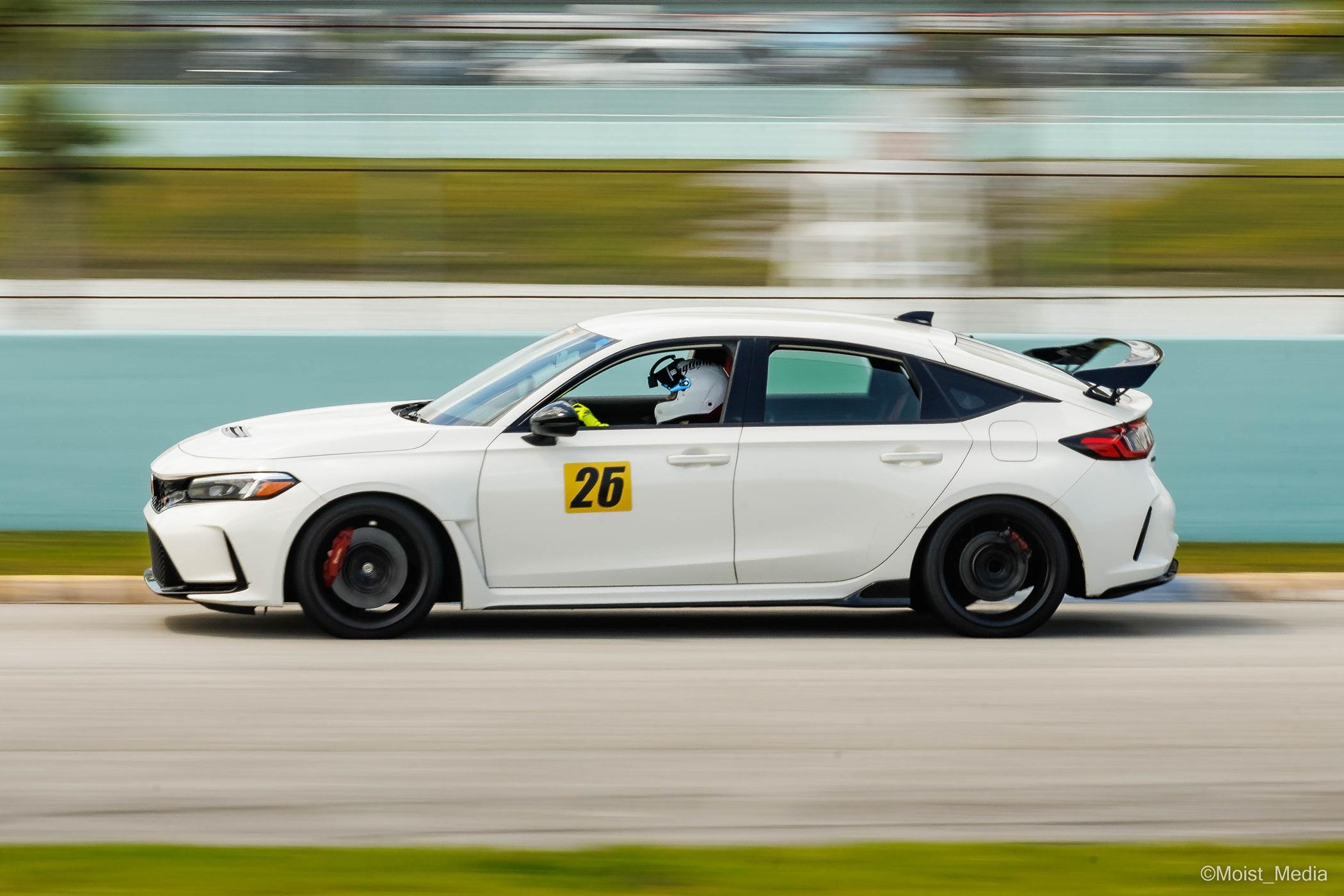

Anyways, after three weeks I passed the 1,000 mile mark and did my first oil change and got the car prepped for it's first track day at Homestead Miami Speedway. I went ahead and flushed the brake fluid with Castrol SRF, installed a Spoon Drop In Air Filter cause I'm a JDM fanboy, added some heat insulation tape around the turbo, and removed the rain shield under the hood.
11th Gen Honda Civic Club-Version FL5 Civic Type R Build Thread IMG_3902.JPG
During my first event with this car, I tested out the various methods of turning off the traction control and played with the onboard damper settings. Eventually I came to the conclusion that turning off VSA with the "Pedal Dance" method and running the suspension on comfort gave me the best feeling out on track and resulted in more consistent lap times.

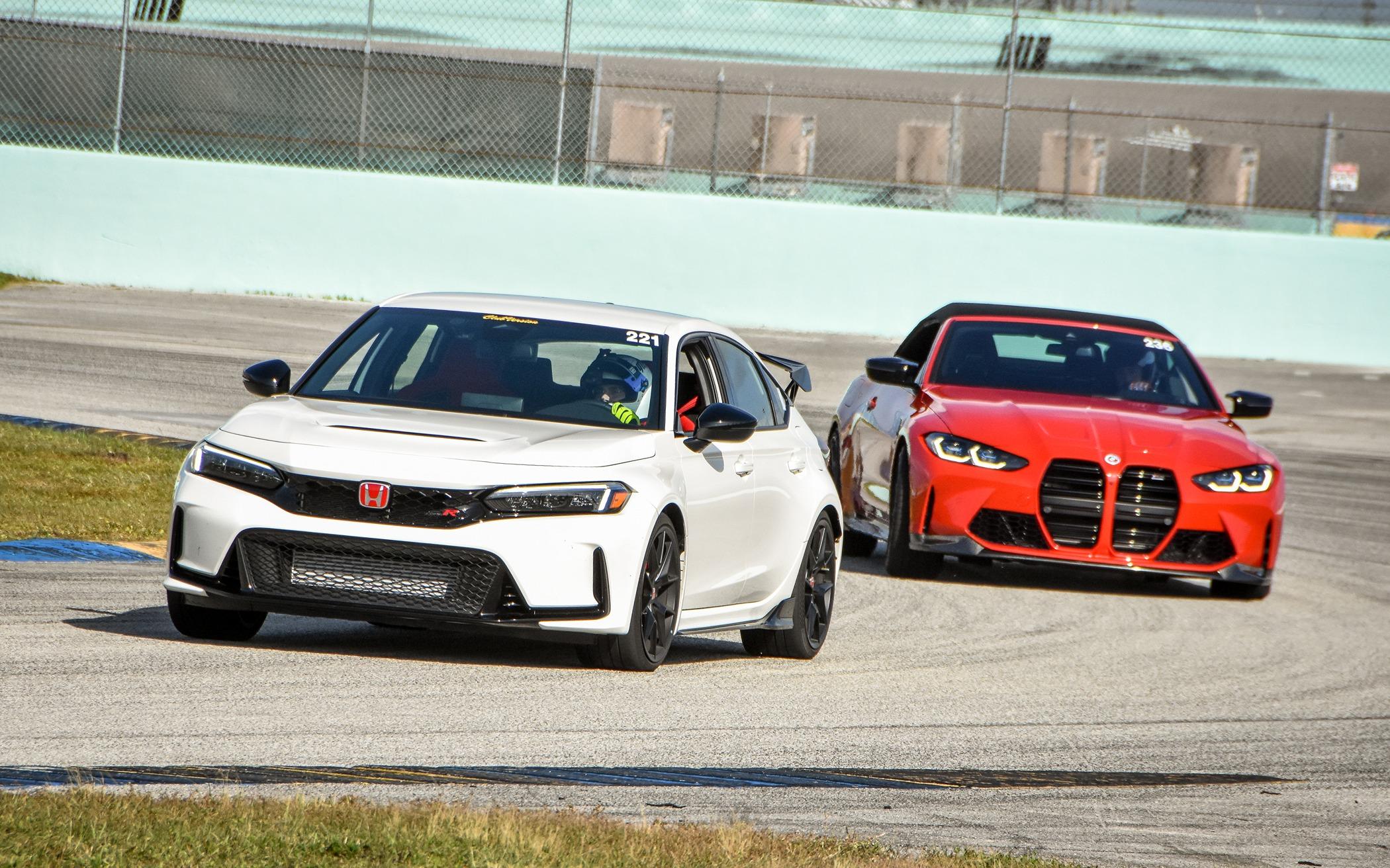

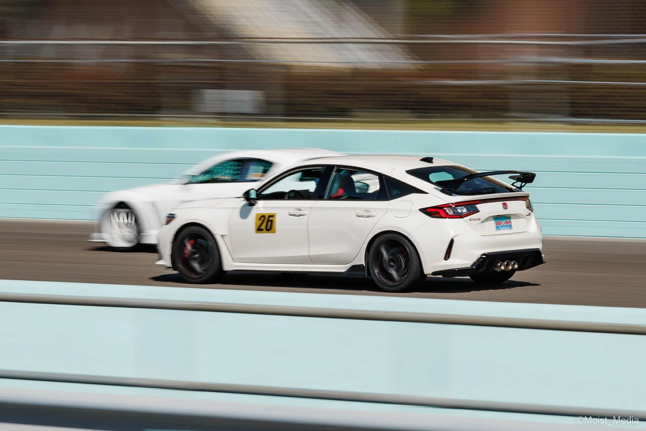

Here's a couple of more track day photos and videos for your enjoyment:
11th Gen Honda Civic Club-Version FL5 Civic Type R Build Thread IMG_6044.JPG
Here Comes the Cheater Tires (ADVAN A052)
After a total of four hard earned track days and reaching the limit of the car with the factory tires and alignment, I decided to swap in some real rubber on the car and get a custom alignment. I have a small writeup on the Tires in the following thread 255 35 R19 Yokohama Advan A052 . If you're lazy and don't wanna click a link, the tires are amazing and gave me an easy 3 seconds on track.
Also, the custom alignment really helped with more turn-in response. Using the factory slots on the top hats I was able to achieve the following: -2.0 degrees of front camber, -1/32 toe out in the front, -1.5 degrees of rear camber and 0 toe in the rear

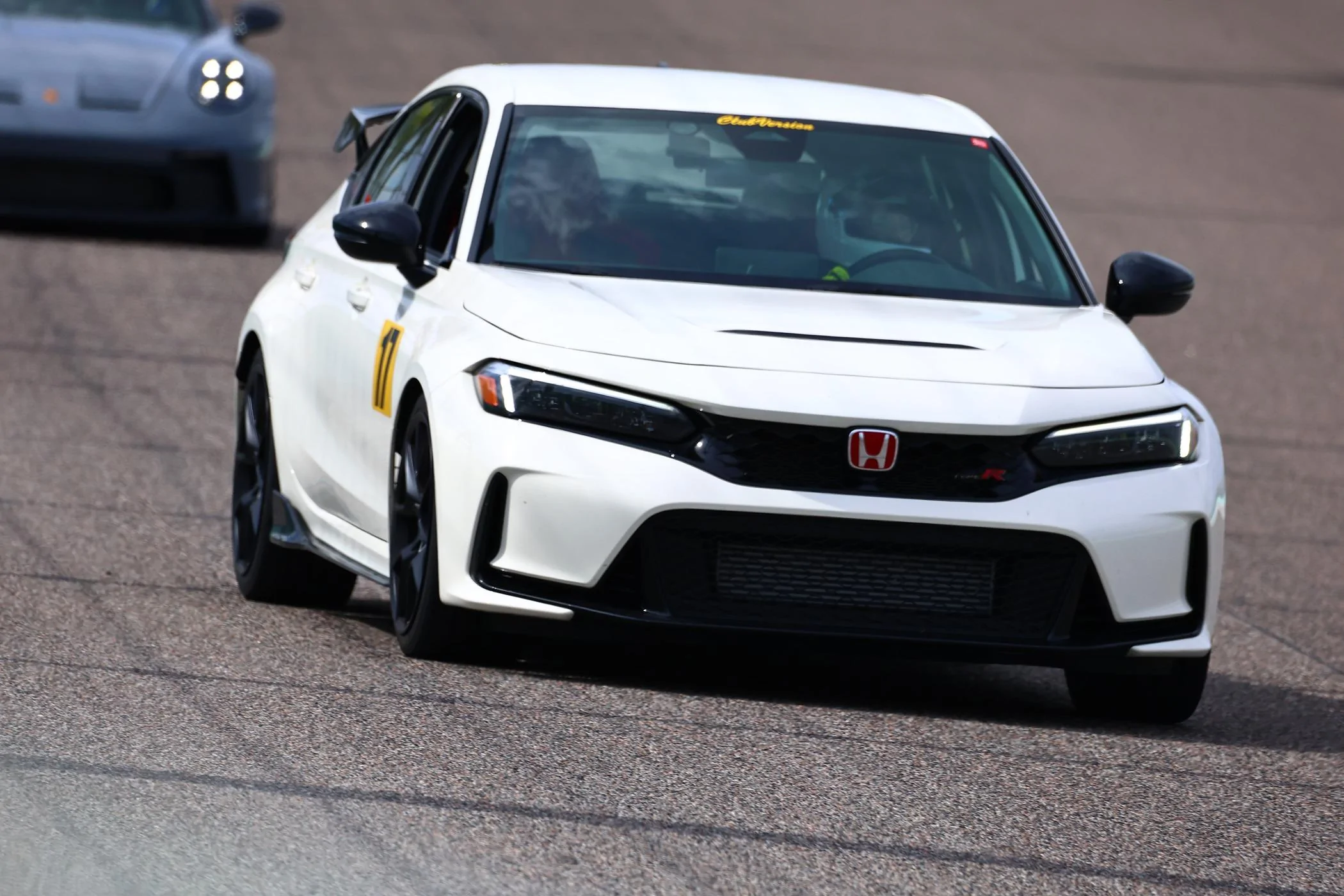

Please enjoy the following fruits of my labor:
11th Gen Honda Civic Club-Version FL5 Civic Type R Build Thread IMG_3186.JPG
11th Gen Honda Civic Club-Version FL5 Civic Type R Build Thread IMG_4028.JPG

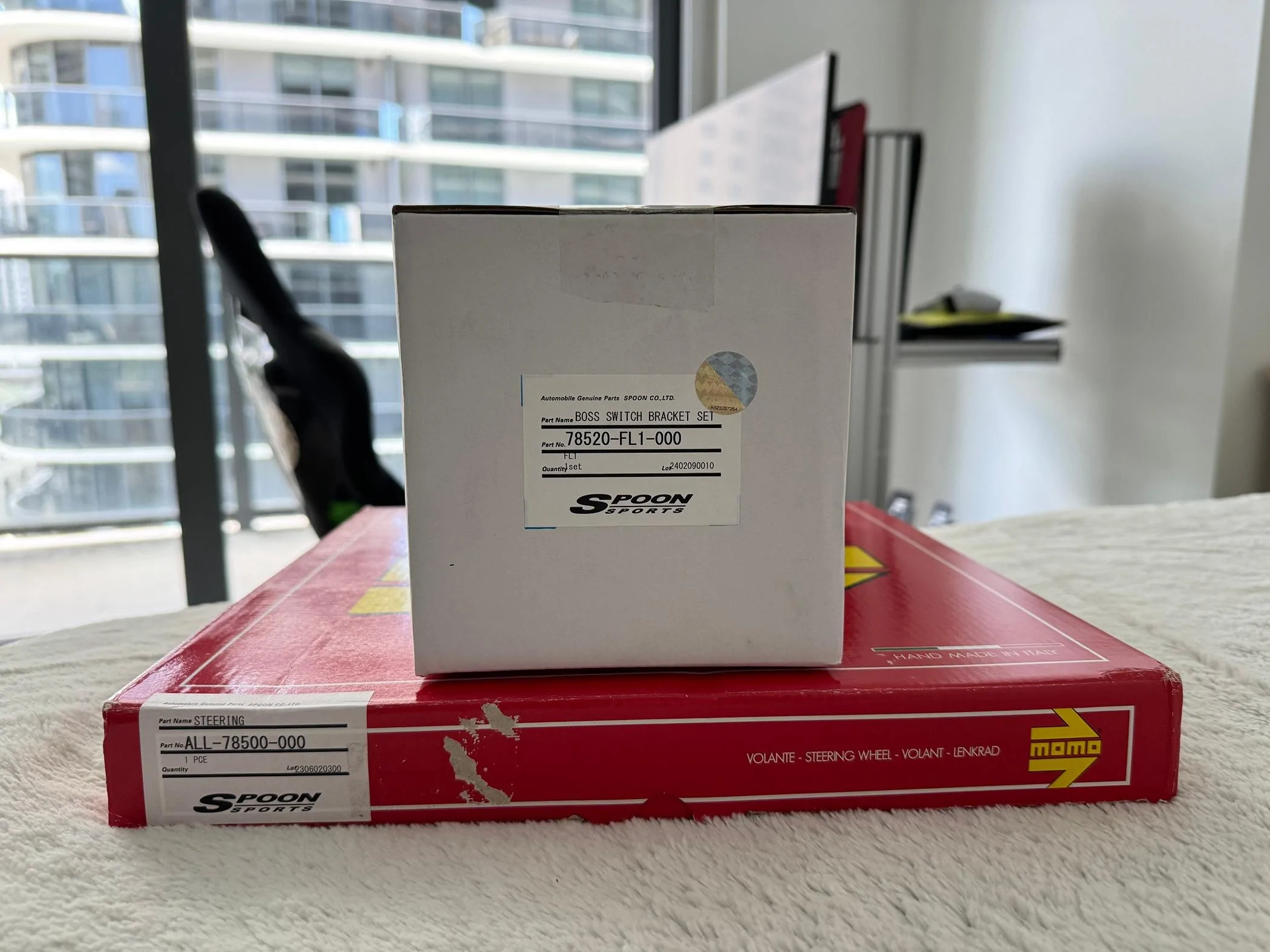

Picked up some creature comfort items for the interior...
11th Gen Honda Civic Club-Version FL5 Civic Type R Build Thread IMG_8493.JPG
I'm always banging my leg into the steering wheel getting in and out of the car so I decided to scoop up a spoon wheel setup which is slightly smaller in diameter. Hopefully it will help and provide better feedback while on track.
I'm always banging my leg into the steering wheel getting in and out of the car so I decided to scoop up a spoon wheel which is slightly smaller in diameter. Hopefully it will help and provide better feedback while on track.
This setup will prevent any lights on the dash? I assume all the stock steering wheel controls will transfer over? All that would be lost is the steering wheel airbag.
Correct, the spoon hub comes with everything you need to relocate the buttons and has the resistors for the Airbag sensor.
