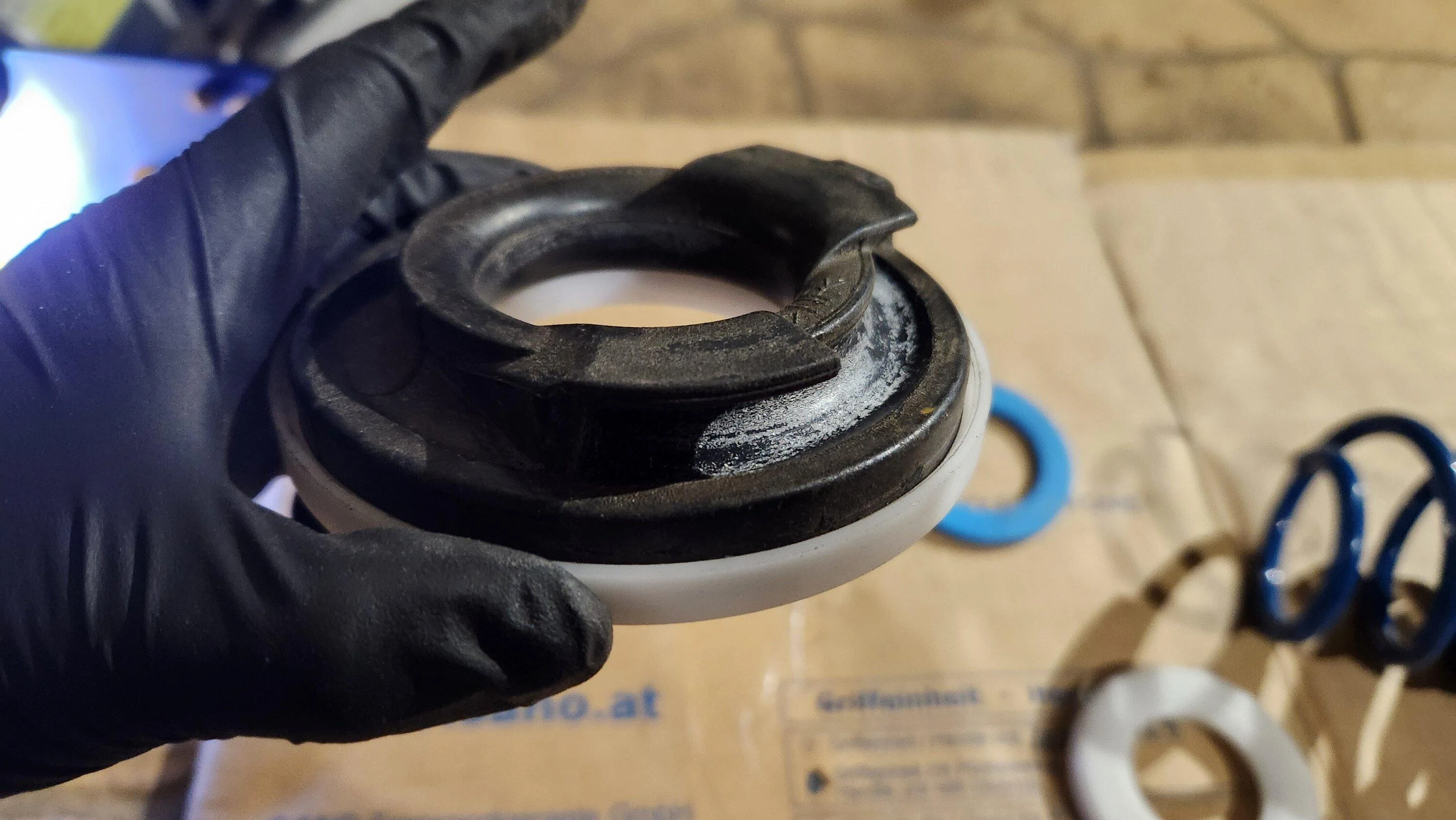

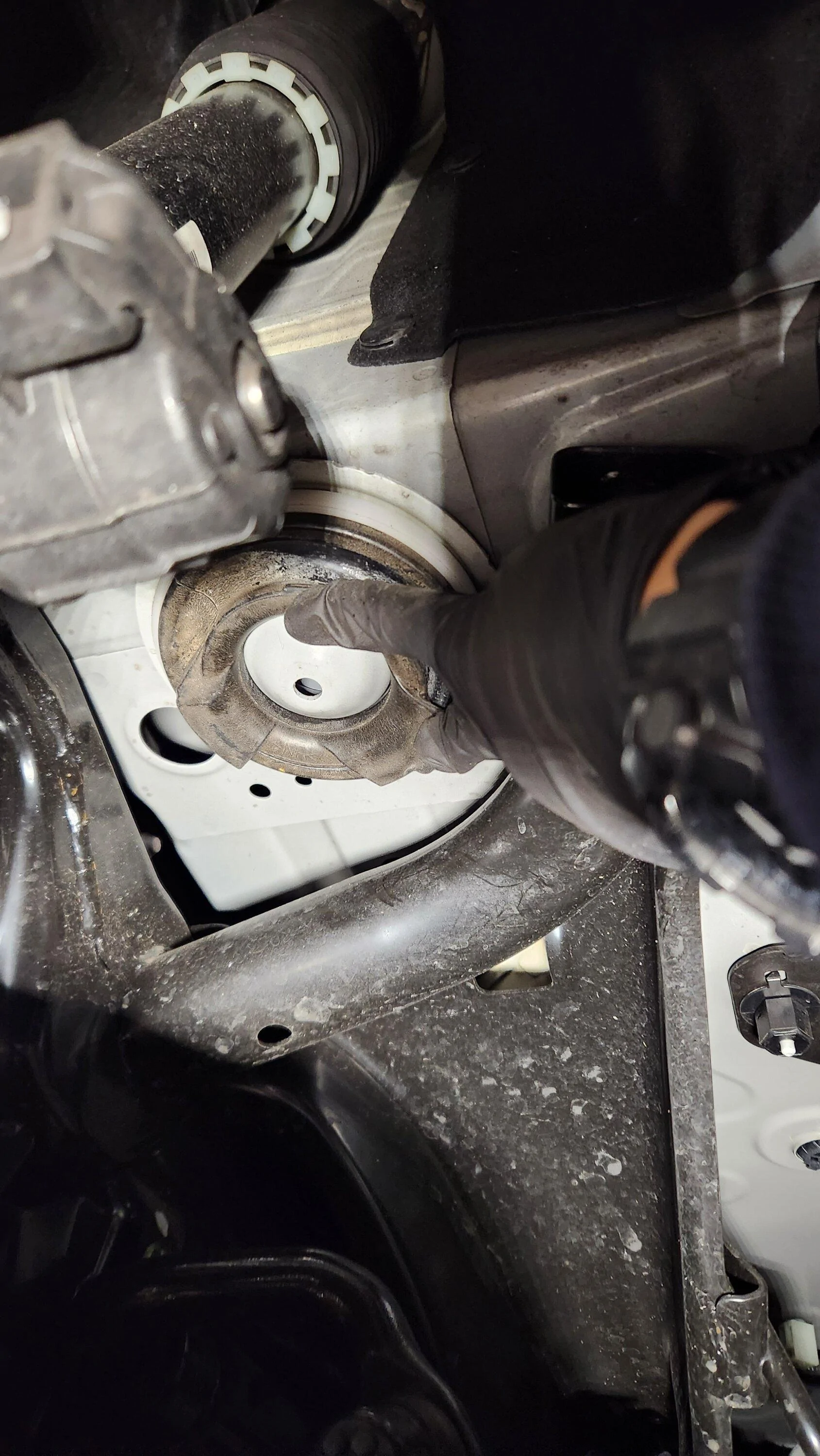

Im curious about the rear spring shim. I havenโ€™t seen a reverse rake before with Spoon springs.

I would say every FL5 fitted with Spoon springs are exhibiting around an 8-10mm reverse rake (rear being lower) if it were to be measured on a perfectly level surface. I'm still currently working with a fabrication shop to make them sit perfect in the body recess, as the surface is not perfectly flat.
