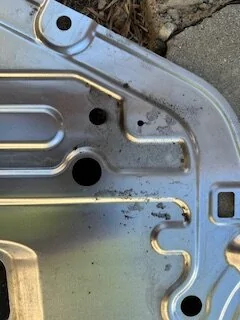

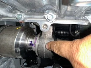

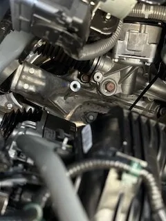

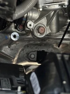

Hi Everyone, I recently Purchased a new 2025 Type R. Yesterday I did the first oil change at 900miles. In the process, I discovered a small oil puddle in the splash shield not much. I checked and found some oil drips on the Half axle shaft bearing. I Kept searching but couldn't find anything, finally this morning I looked from on top of the engine and found some oil stains around the steering rack. what do you think is going on here ?
Thanks in advance.

This happened to me and it was the valve cover. Very small leak that collected over time which made it hard to troubleshoot. I think if you inspect the passenger side rear corner of the valve cover you will see oil up there but probably not much and it's hard to get access to. If you have an inspection mirror or borescope it will help.
My car is a 2023 and I discovered oil collecting in similar locations to yours after my second oil change around ~4000 miles.
You should be able to easily rule out gear oil by smelling it.

Did you put lowering springs on? If so, you likely damaged the axle seal and are leaking oil from there.
If no lowering springs, the valve cover is known to leak on the FL5, so check around the valve cover.
I haven’t installed lowering springs car is stock. Thanks for the advice. I will
Look around the valve cover today when I get home.
